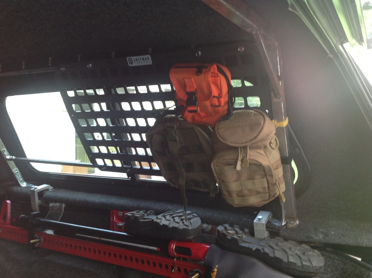

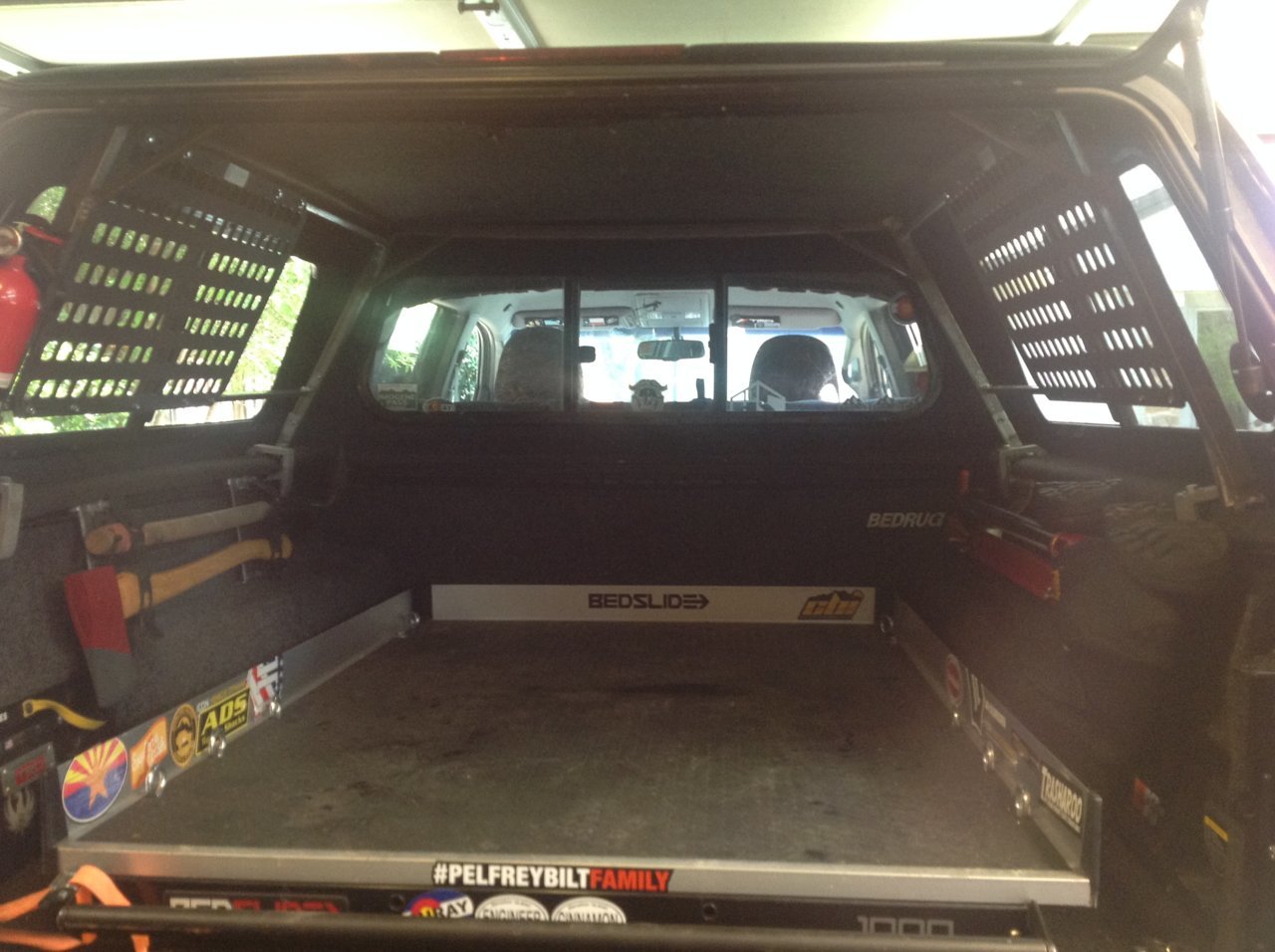

    Ive seen a guy on here that built an inner skeleton out of square tubing to use as reinforcement for a rtt. Of course you could build something similar, but use it for mounting purposes. Ill see if i can find the thread

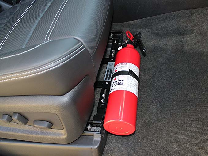

    I've seen mounts made to fit across feet of front seat. Easy access and out of way.

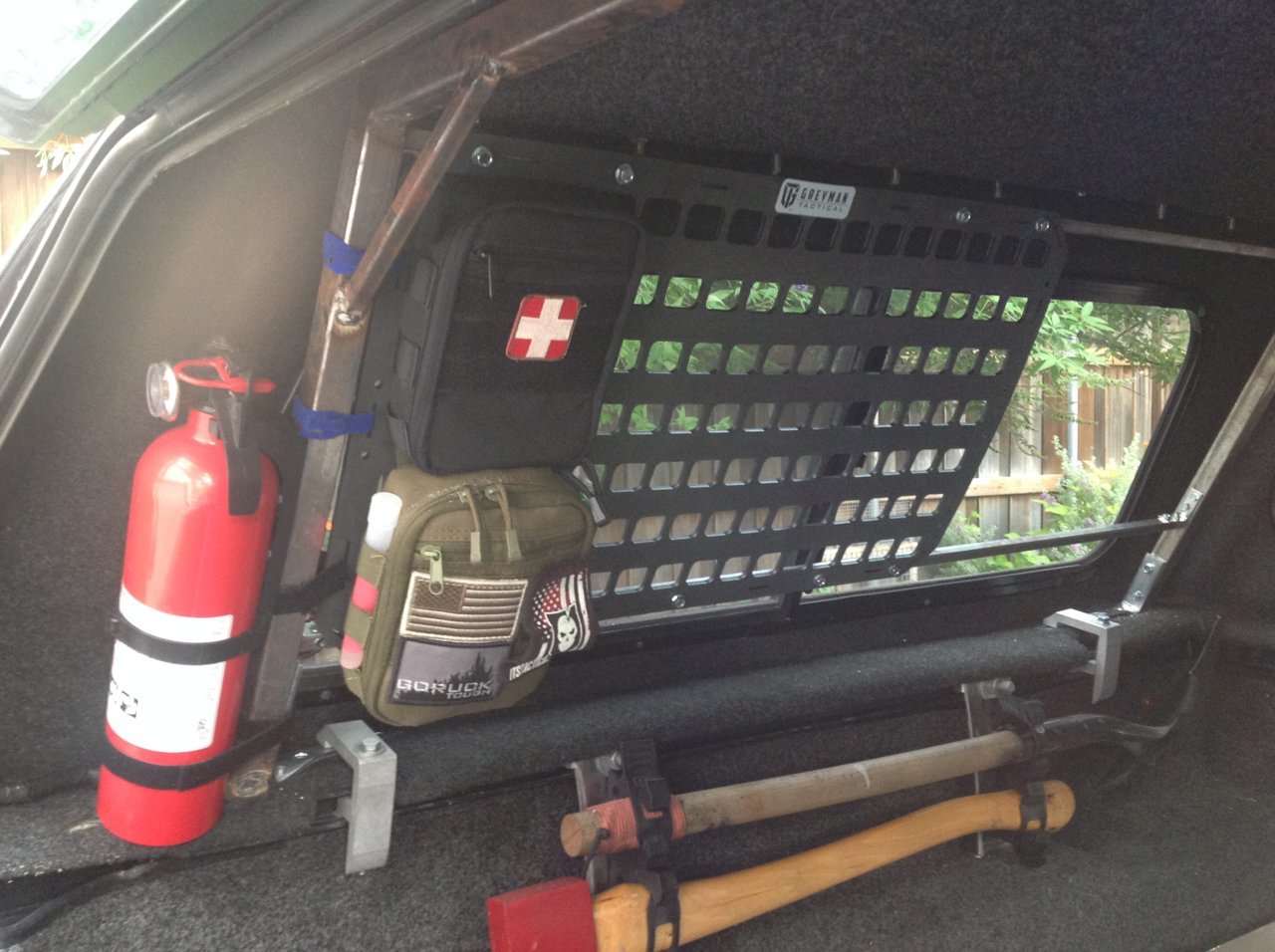

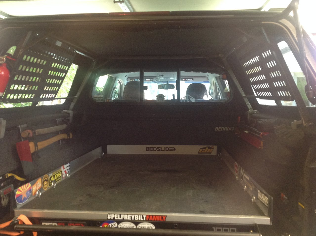

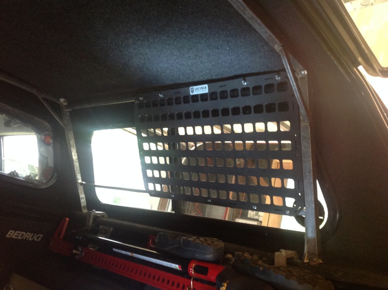

    Okay, had to dig wayyy back, but heres a little info on it with pics:
    And the thread i found it in here
    Looks like a damn good way to mount more stuff inside your shell and keep it all locked up. I dig the molle panel style storage that is on the sides

    Yes! That looks like it would be a great solution and I don't think the amp under that seat would cause any issues.
    Exactly what I was thinking of! Although I hadn't even thought about adding MOLLE panels. That's a great idea! Thank you, sir!

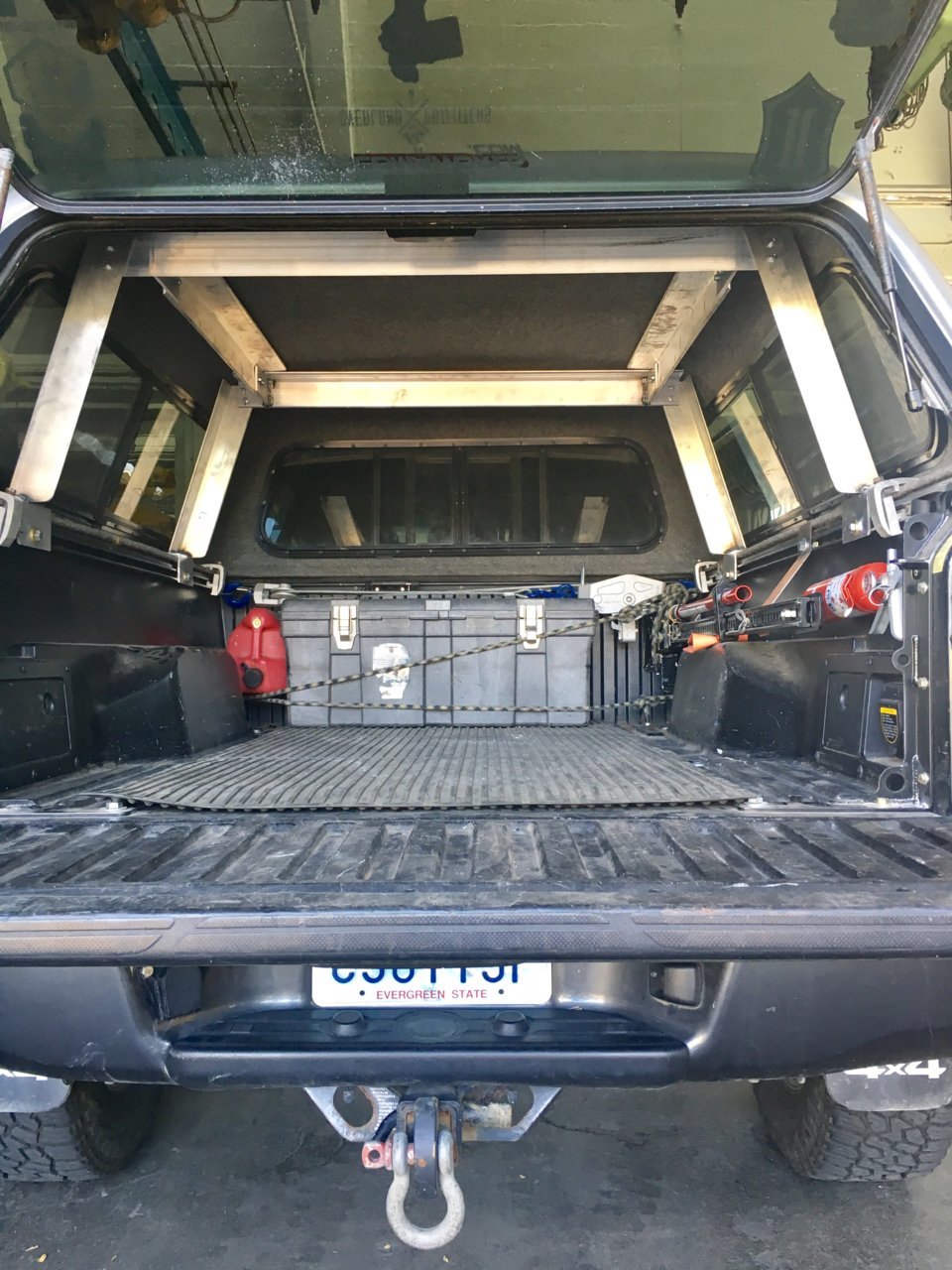

    IMG_0741.jpg just make one.

    3x3x1/4" aluminum, definitely beef. I want get a huge RTT and don't want any trouble with the topper.

    How did you attach yours to your shell?

    There is ZERO tolerance between it and the shell. It's literally forced into the corners, but it is held to the shell with the brackets that hold the shell onto the truck. If you look closely in the pictures you can see how I used the shell brackets to also hold the interior cage/rack. I have had no issues with movement or shifting. It's been great

    Also, it's has sinced been coated in POR15, since I used steel tubing instead of aluminum
