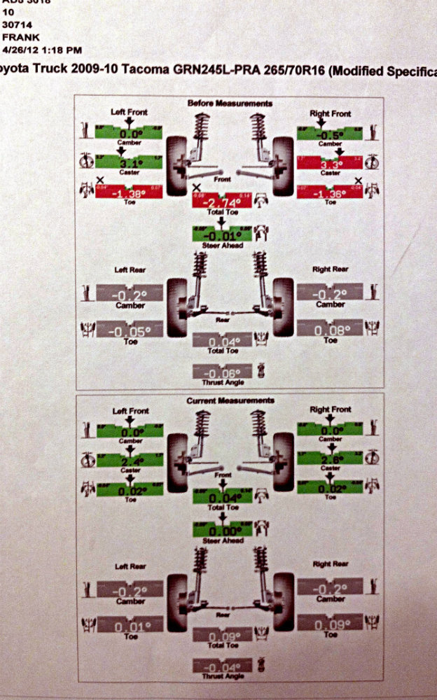

    OME 885, OME shocks, Desert Products UCA up front
    TSB spring, Icon 3 leaf add a leaf, overload leaf removed in rear
    I have no CB drop or diff drop and suffer no vibes, seems to drive straight and true.
    A friend who has built several offroad rigs reccomended this alignment guy as the best in Houston.

    Looks good. :thumbsup:

    That's about as good as it gets. That guy is good!!:D
