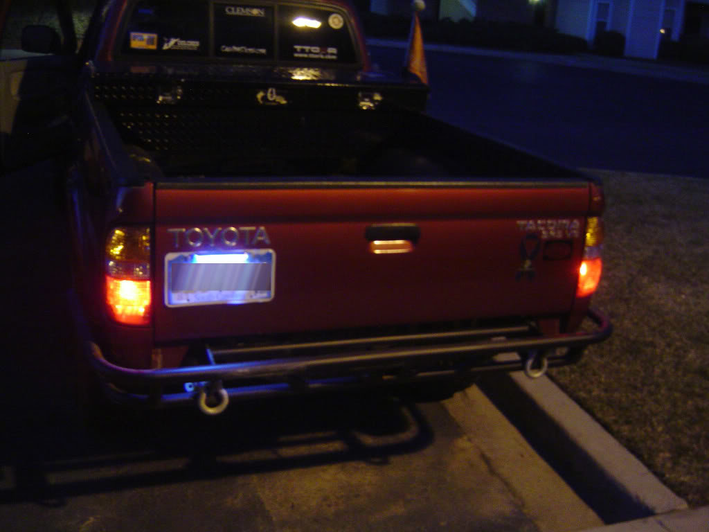

    you can always go this route
    tube bumper with eyelets for d-rings
    i have one on each side right at the frame rails
