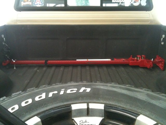

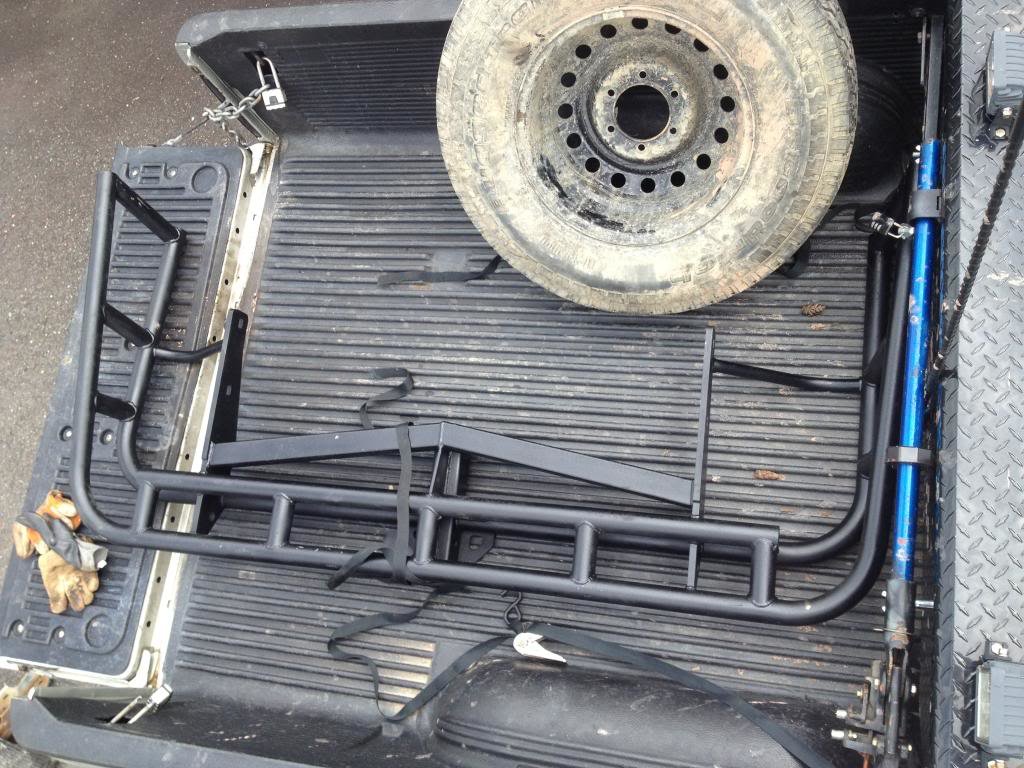

    In the box, on a bed bar that I made. Also an axe and shovel carrier
    image by Tanner Tucker, on Flickr
    Gives you an idea of the space in front of it for shit as well. Still tones of room even with a full size spare that fits under it and a bobbed box

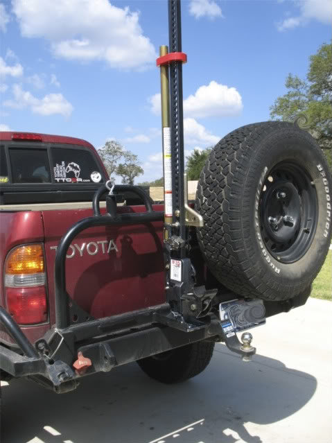

    Check the TTORA Garage Section....
    Mine use to be on the bed bar... now it's on my tire gate.
    But I am rethinking to relocate it back into the bed so it will not be a tree branch snagger. :D

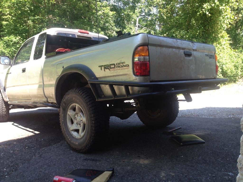

    02 Tacoma TRD
    Homebrew bumpers and sliders, 5100s & Eibachs up front and mutt leaf pack out back, 285s & Wheelers type B, sway bar deleted. Wife's ride: 01 4Runner 4wd sport. Stock with exception of TRD taco coils, and shift kit.
    Nothing fancy.

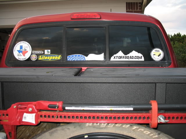

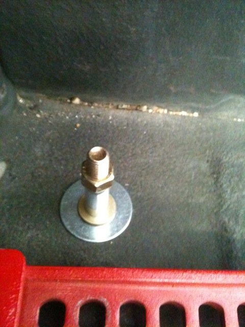

    To my tool box. Bolts come through from the inside and there is a long piece of flat steel in there for extra support. Then held on by wing nuts.

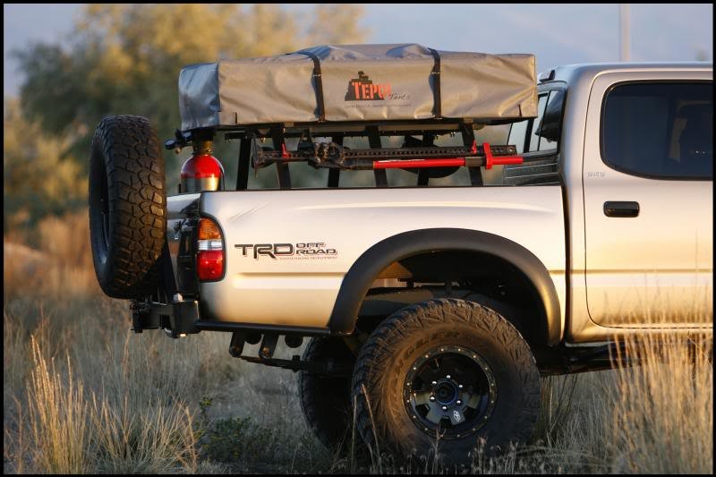

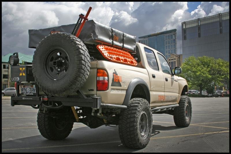

    Mine's on a bedrack or on my tire carrier. Spends most of the time on the tire carrier now since my maxtrax took the space on the bedrack.
    bedrack
    tire carrier

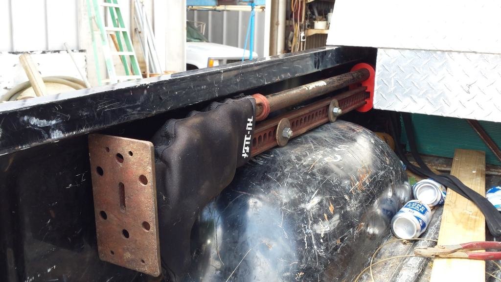

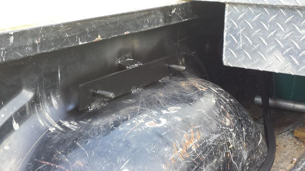

    I don have any wheel well liners so it was a matter of drilling 2 holes. ;)

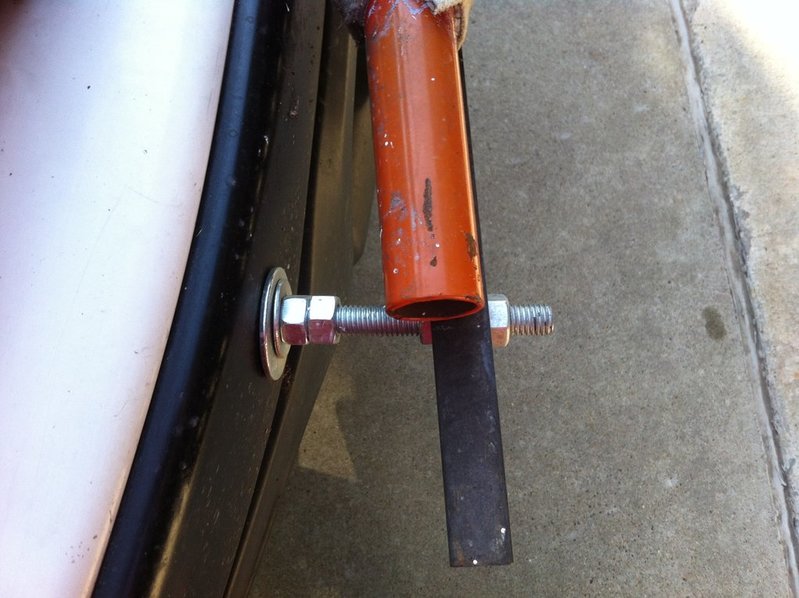

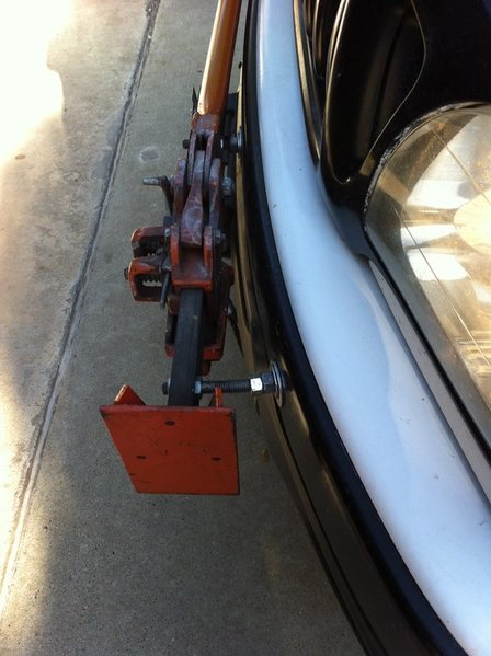

    Three lengths of all thread, three holes in the front bumper, some nuts and large washers to spread the load on the bumper and you have a bumper mount for a Hi Lift
