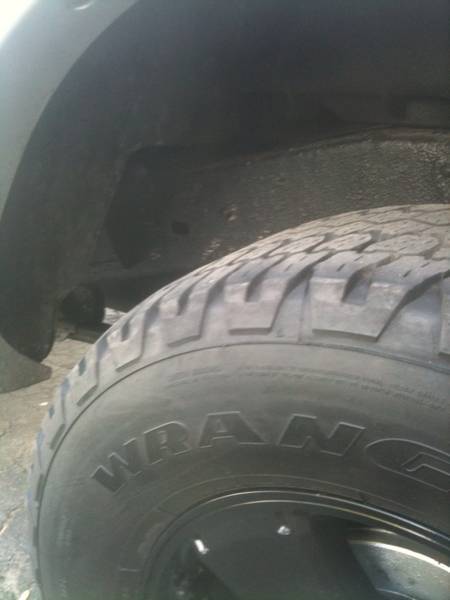

    The shitty pic's make it look like shag carpet but its not that bad.

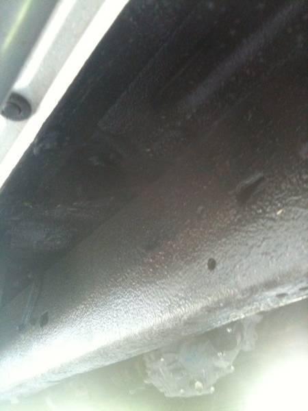

    cool thanks for the pics, after seeing how well the under side of the body withstands from rust I probably would only coat the frame so that if any lines or anything had to be worked on it wouldn't be covered with that oily stuff.

    Forsure, the coated lines is from the factory first coating. This stuff shouldnt be used on any rubber stuff, I think it swells it. The frame and cross members are a good example of the finish texture.

    Well bedliner is not rubberized..I know that for sure..I'm thinking its somesort of epoxy mixture. Once you lay that stuff down, theres no getting it off. The rubberized undercoating is a different story. Even after its applied it remains soft and not as durable as bedliner material.

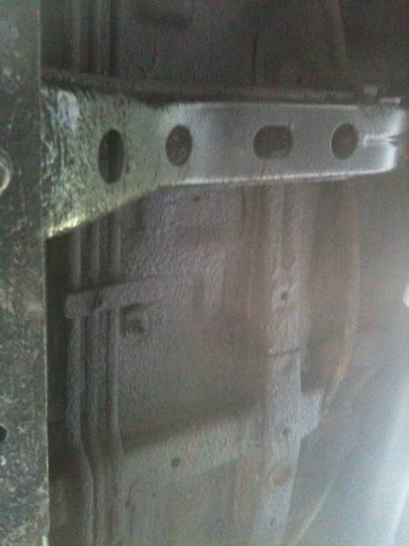

    that looks like alot. but it looks mostly like surface rust... but my 01 with the rust recall doesnt have that much.

    Man that's nasty. You need Por 15 to fix that. Then you only have to scrape the loose flaking rust. etch it and apply Por 15 two coats. Never rust again.

    Thats just normal surface rust. You can sand it off and hit up with some paint and be good to go.

    I agree. I wouldn't panic just yet. This seems to vary from car to car, but it's certainly not uncommon to see surface rust like this on chassis. My first Land Rover looked like this. Ten years later, it's still in service solid as ever (and leaving oil puddles on somebody else's driveway, not mine).

    To echo what others have said: POR15 and/or Rustoleum primer and paint are your friend. Your truck is rusty, but can easily be saved at this point. Attack that rust now.

    My 06DC is about the same the rear leaf hangers are the worse part. Called toyota and told them, they scheduled a frame inspection and seemed to be concerned about it. Plus it has a 5 year warranty. See what happens. Sorry just thought I would let you know your not the only one.

    going to be calling about the recall tomorrow, I found a hole through my frame.
