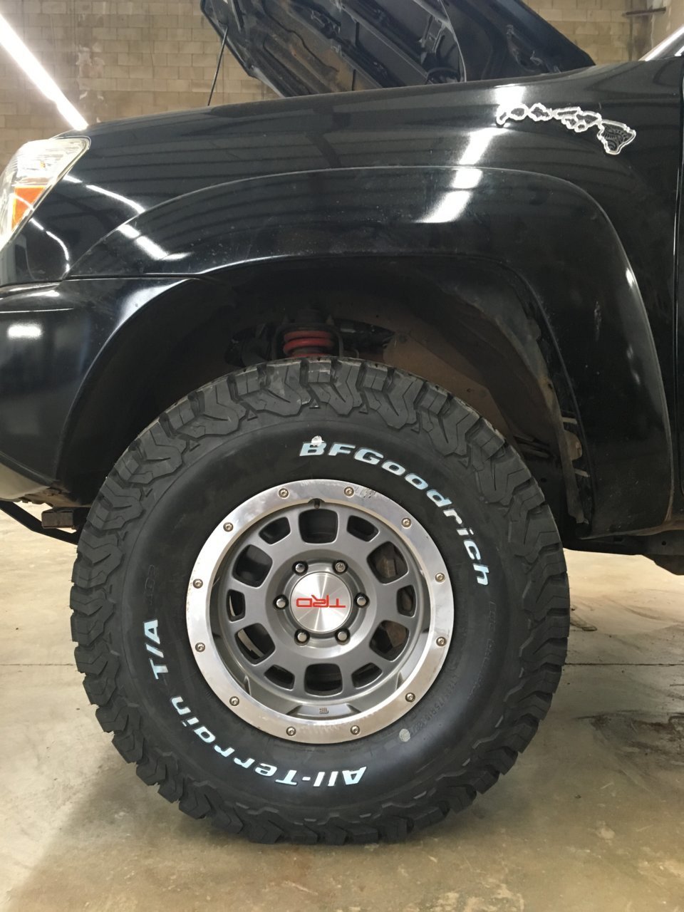

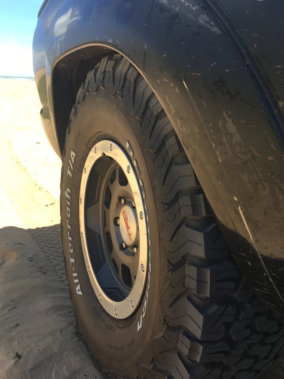

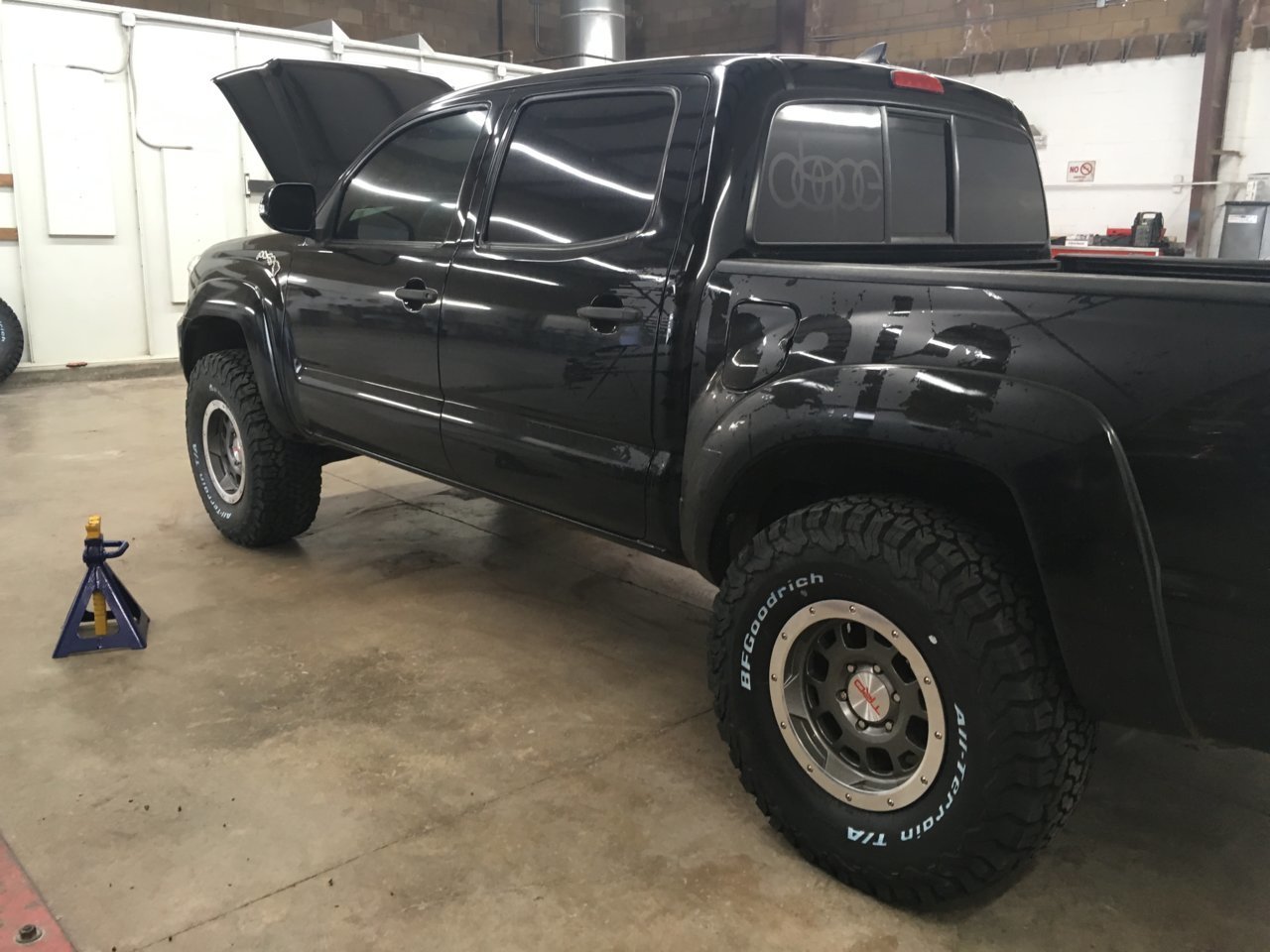

    If you’re willing to cut, 33s can fit. Prepare for a CMC, pinch weld flatten, trim the lower fender flares and fender liners. Snugly fit 295/75R16(33.4”) BFG KO2’s on my Baja couple years ago.
