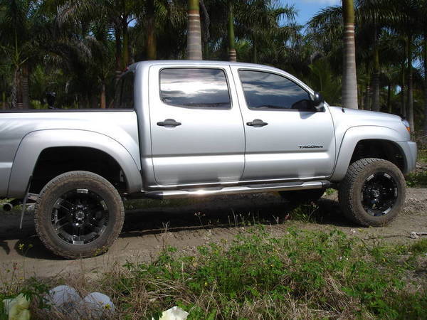

    18x9 pro comp 7031 rims, alpine iva-d310 w/sirius sat radio, ipod connection, tv tuner, reverse camera, bug deflector, wet okole seat covers, tinted windows, running boards, toytec coilovers front set at 2.5'' , AAL rear,5100's rear, TC UCA, leer topper, bruteforce rear bumper, ARB rear locker.
    285/60/18 18x9 4.5 backspacing
