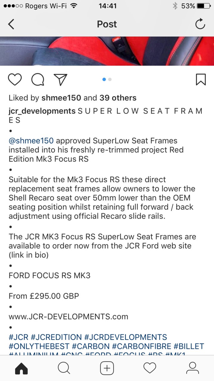

    Just found out about these guys for the focus rs. Maybe there is a North American manufacturer who will do something similar for us?
