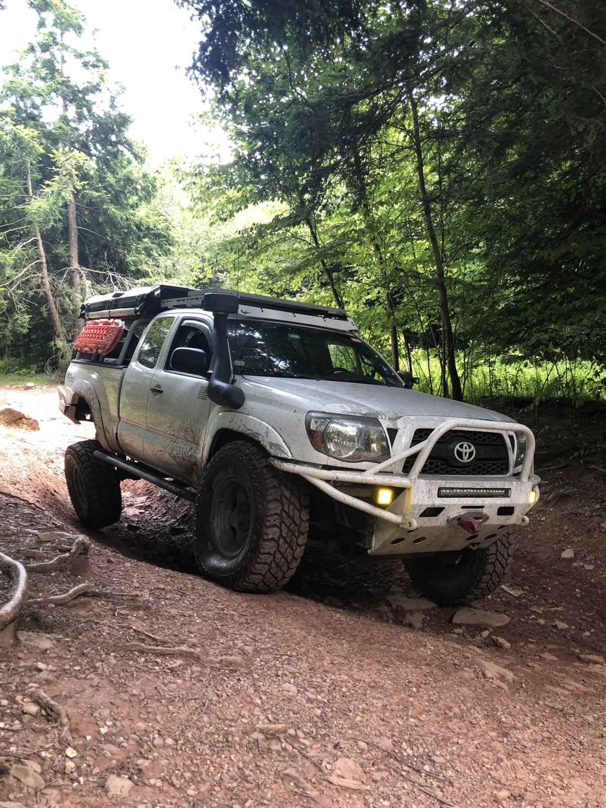

    you were getting pulled, or doing some pulling out of the snow in one of the photos?
    Our bed is effectively an industrial sized rubbermaid with the lid taken off and a foil ring of steel around it held to the frame from the bottom only.
    With your rack putting mass above the bed rails you'll get the recoil effect when yanking.
    Plus any additional weight that was in your bed getting tossed to and fro.

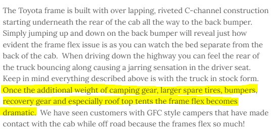

    Hitting a large dip in a trail at speed will do that, usually accompanied by the drivers head meeting the roof of their taco.

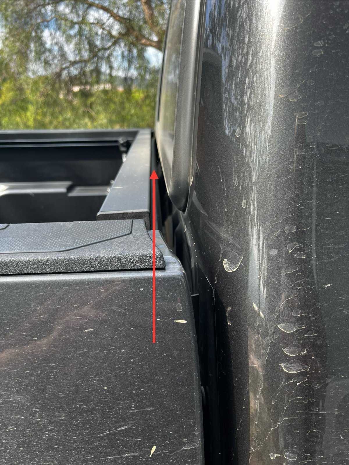

    Mine lines up with the red line. The entire way from side to side. Something is amiss here.

    my 1st gen frontier took a 35 mile an hour hit in the ass and looked better than that dent

    Ever had a cap or something similar mounted on top of your bed?

    Take a look at where the arrow is pointing and take note of the gap. Now take a peak at his and you’ll notice the gap has shrunk. In order for that to happen, wouldn’t it take the failure of the bolts fastening the bed in place? Or perhaps the bed’s plastic gussets failed in some way and jeopardized the fastening.
