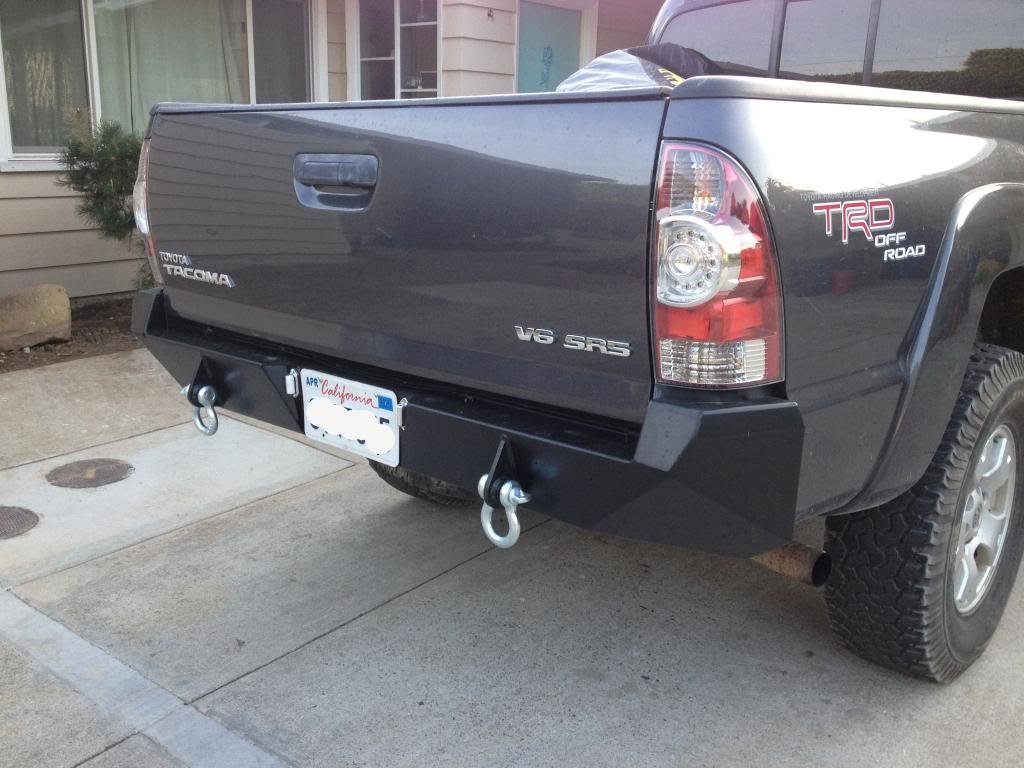

    I ended up powder coating it, looks really nice.

    PICS???

    2a3c12ed-5e69-4a94-a05a-01416df7af4c_zps_7bb087c396a9122cecaf1c01b43a083589fc4aeb.jpg
