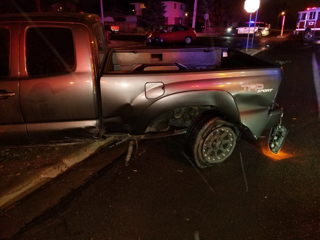

    Okay thanks I will replace it then,when I turn the wheel right to left it only works then .I got a little ruff with it when I punched it because off bad Colorado drivers my 2nd Taco got totaled because some asshole ran through a stop sign have trauma ever since.20170115_204251.jpg
