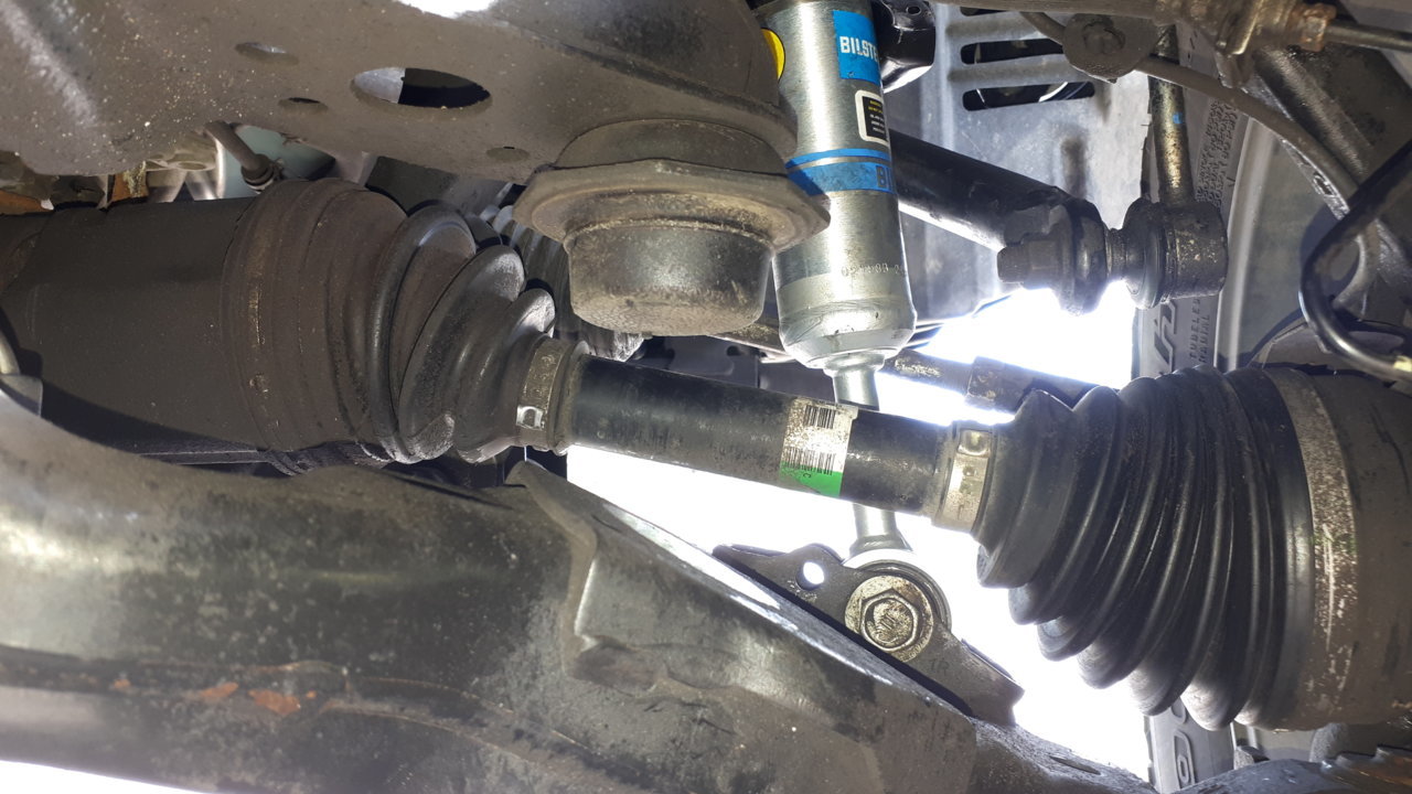

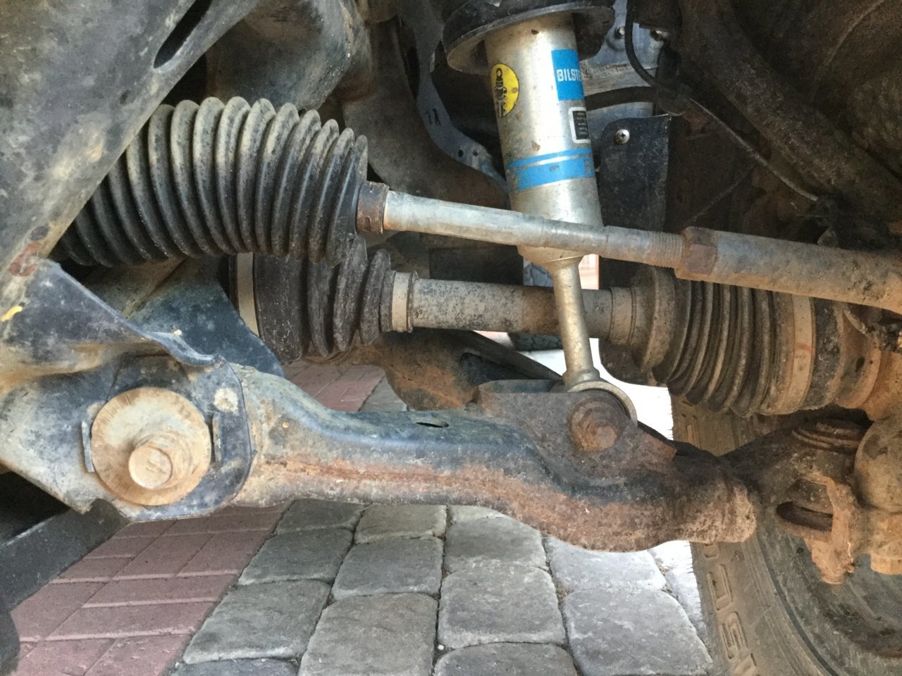

    20180620_220840.jpg 20180620_220748.jpg Just installed the front end lift. Dakars go on tomorrow.
    5100
    887
    1/2" top spacer driver side o_O
    1/4" passanger side
    Spc ucas.
    It hasnt settled yet and it hasnt gotten an alignment yet.
    But these angles look atrocious.
    The only thing I waited to torque once the wheels were on the ground were the lower alignment cams on LCA that I marked before hand. Should I have torqued the UCA after also. Im completely new but managed to get this done on my own so go easy on me.
    And I need to drive it to work on friday.
    Thanks

    Front Diff drop? I think that’s the only thing that’ll correct the angles other than taking your top plate spacers out.

    Are the boots tearing the only issue? Or would the inner tripod gear be affected with such bad angles

    Your alignment and settling affect your cv angles. I would get it aligned and wait for it to settle before you consider anything else. I haven’t done it myself but the boot slide mod or aftermarket boots seem to be highly reccomended around the forums.

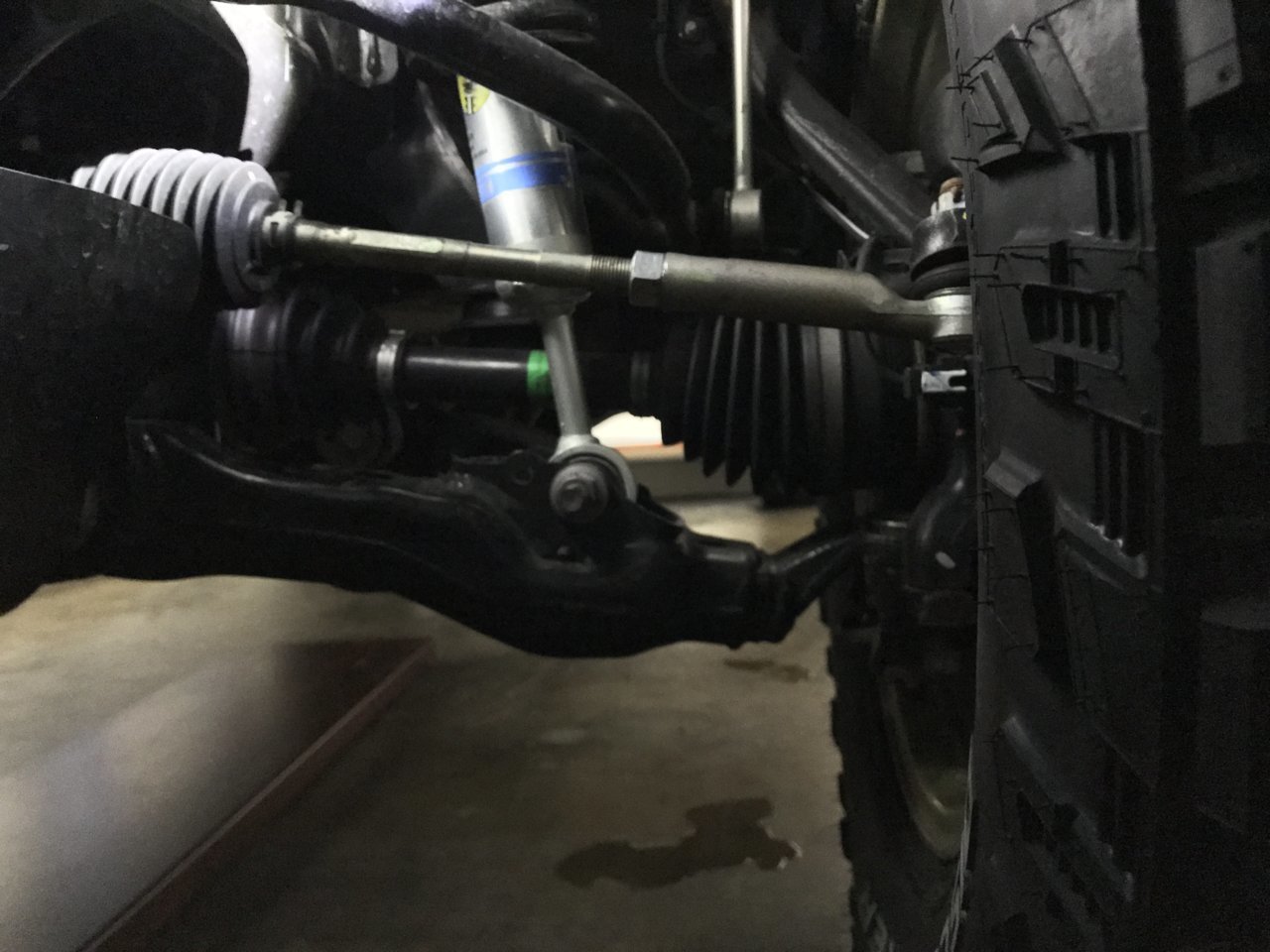

    You sure everything is installed right? Those angles look really severe for what should be about a 3” lift. Here’s mine for reference with 5100/886.

    I’m on 5100 w/888 and SPC. Mine doesn’t even look close to that angle.

    It will eat up your needle bearing. I did Diff drop, no problems with CV boots, or needle bearing. Like others said, something doesn't look right.

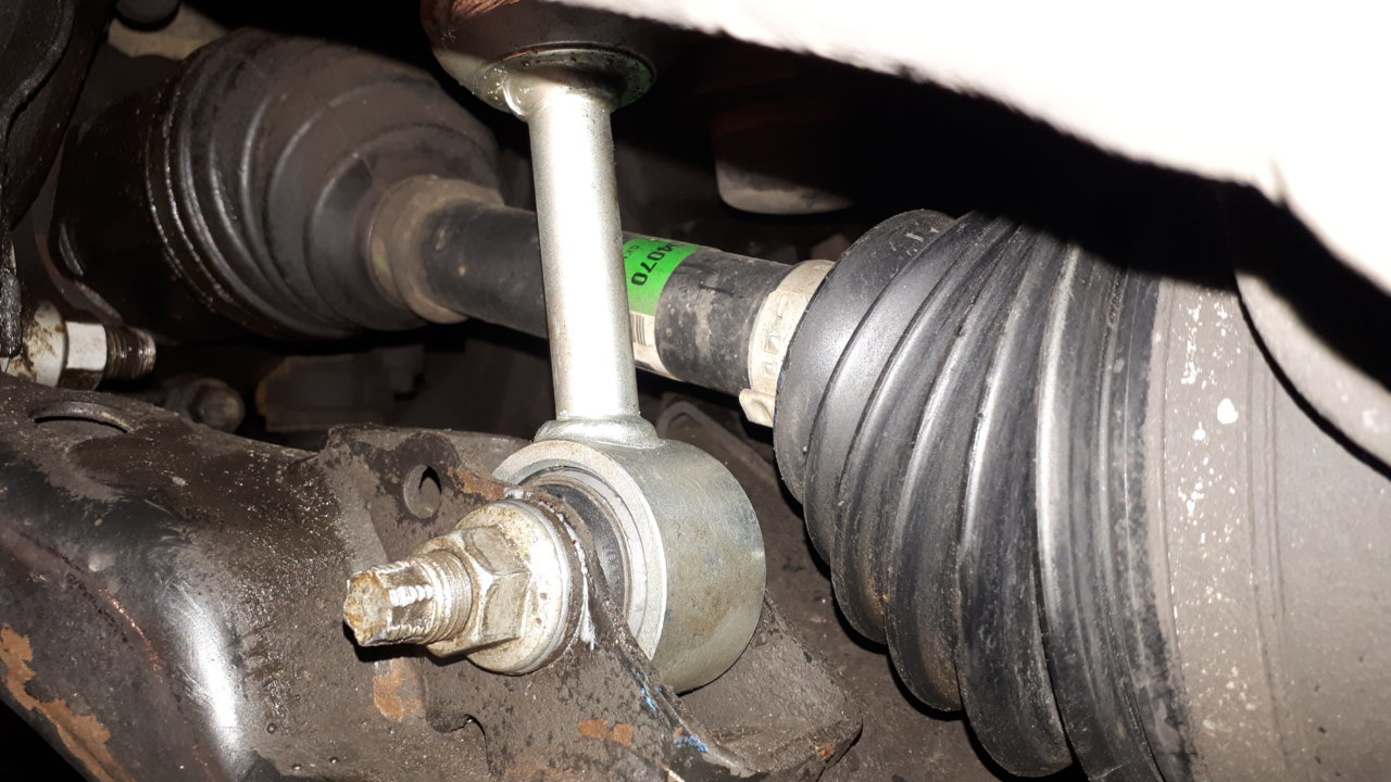

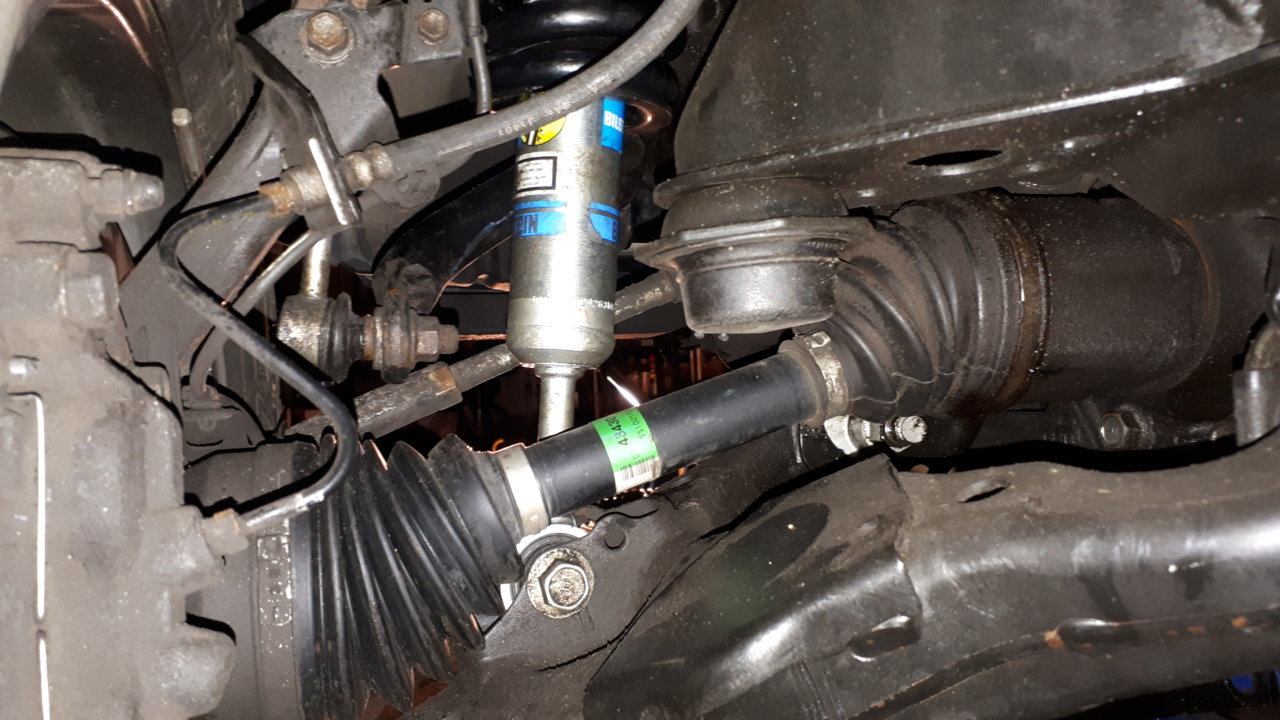

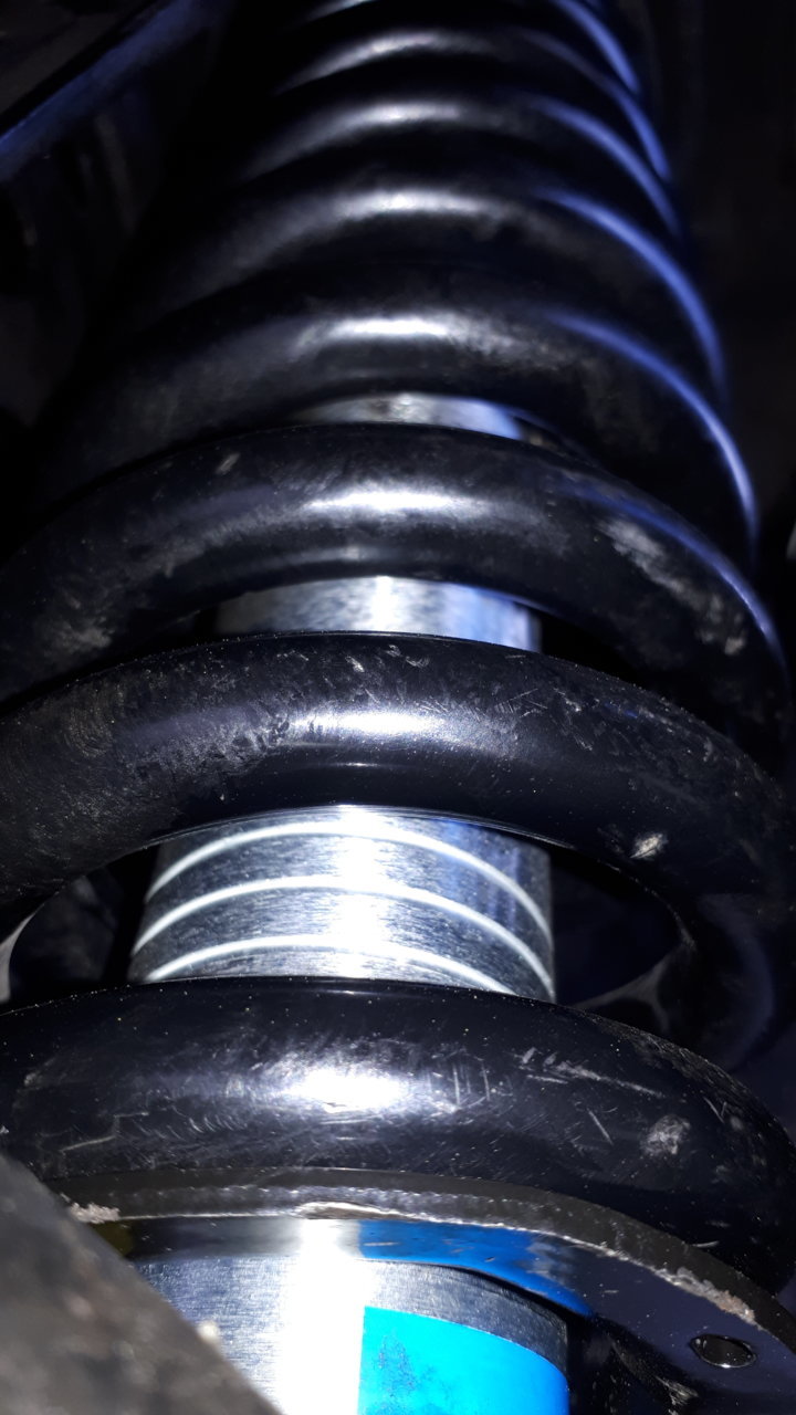

    My bad your right it does. 1/2 spacer on driver side 20180620_220840.jpg and 1/4 on passanger side20180621_100218.jpg i did this to try and get it level with dakars but i think i went over board cuz that passanger side doesnt look as bad and might get better once settled. Its a learning curve but im going to get rid of that 1/2" spacer and switch up the 1/4" one hopefully it looks better.
    Joe I took them to ct motorsports cuz the first place that put them together left them real crooked up top but Ski straightened them out for me. I can see 3 rings above the perch so I believe theyre on the lowest setting. 20180621_101145.jpg Should I take it to him to have my alignment done?
