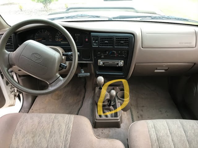

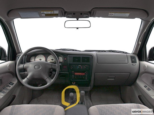

    02 has the shifter on the floor. Put it in neutral and shift it to 2wd. It’s the little shifter next to the gear shifter. Or if you have a manual I believe it’s behind it.

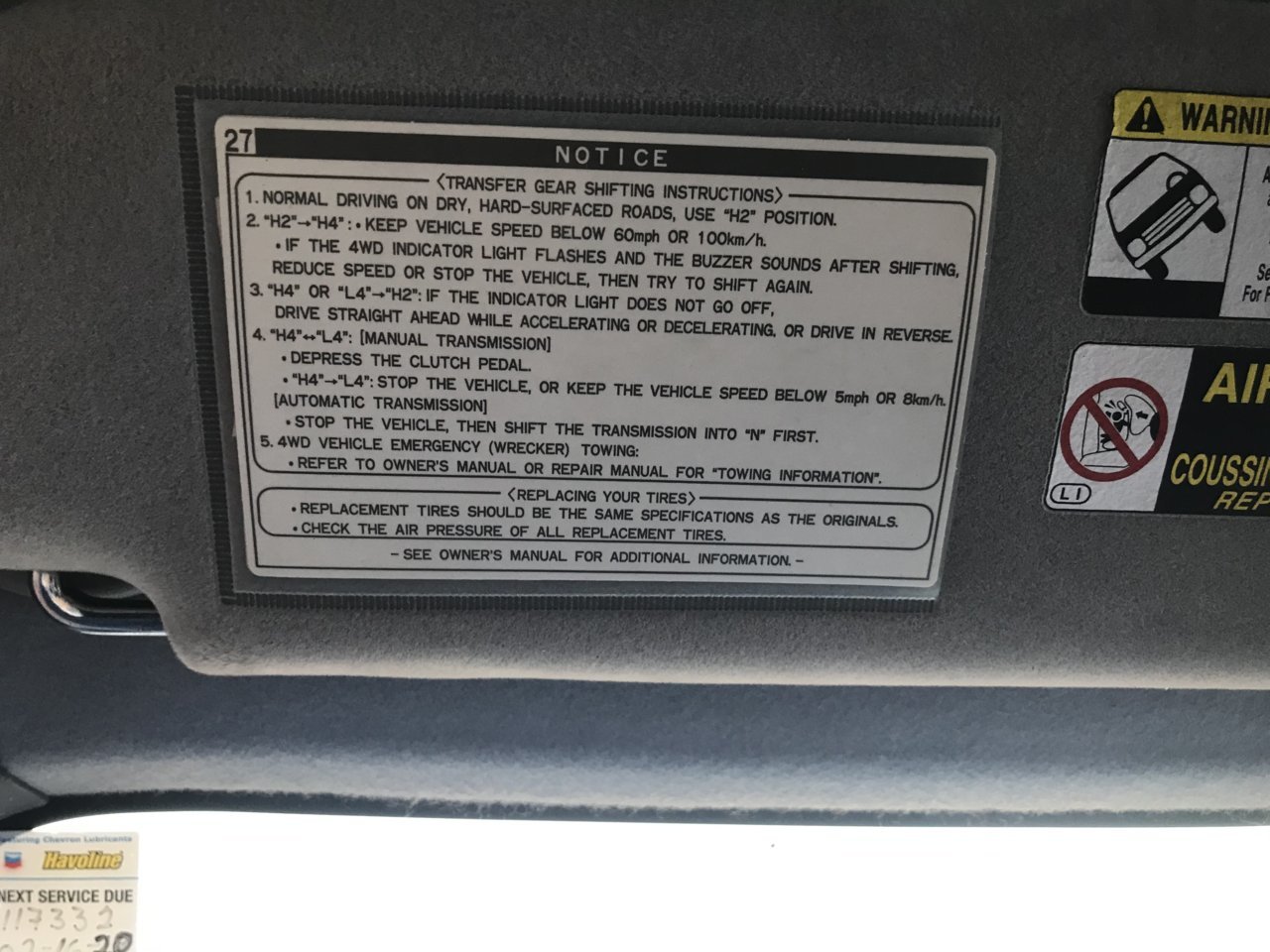

    See manual guide from the sun shade

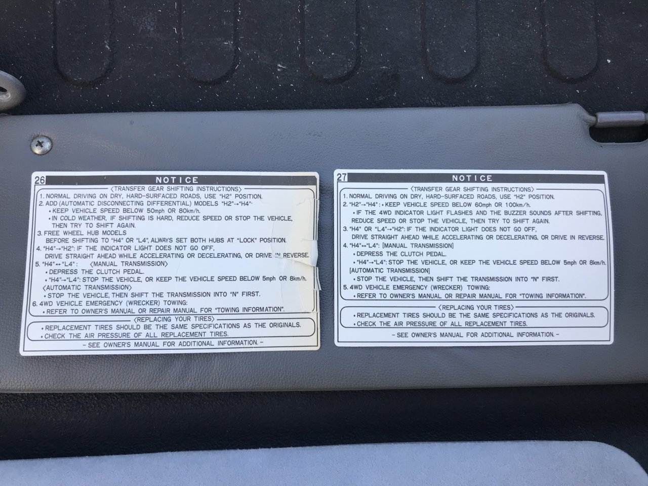

    The left one is from my 2000 Tacoma and on the right is a 2003 tacoma. I was fortunate to have these when I bought the truck and parts from the 2003. Thanks

    my 2001 has a placard on the visor, explaining the operation of 4x4. Has it for auto and manual..
    Handy card if i ever lent out the rig..haha yah right.

    mine says 26 as the number..weird?

    It was removed and discarded then.
    No, they came with the truck when new, it just has departed from the visor at some point. I have the card for my 2003.
    Not weird if you have locking hubs, as that card is for those models.
