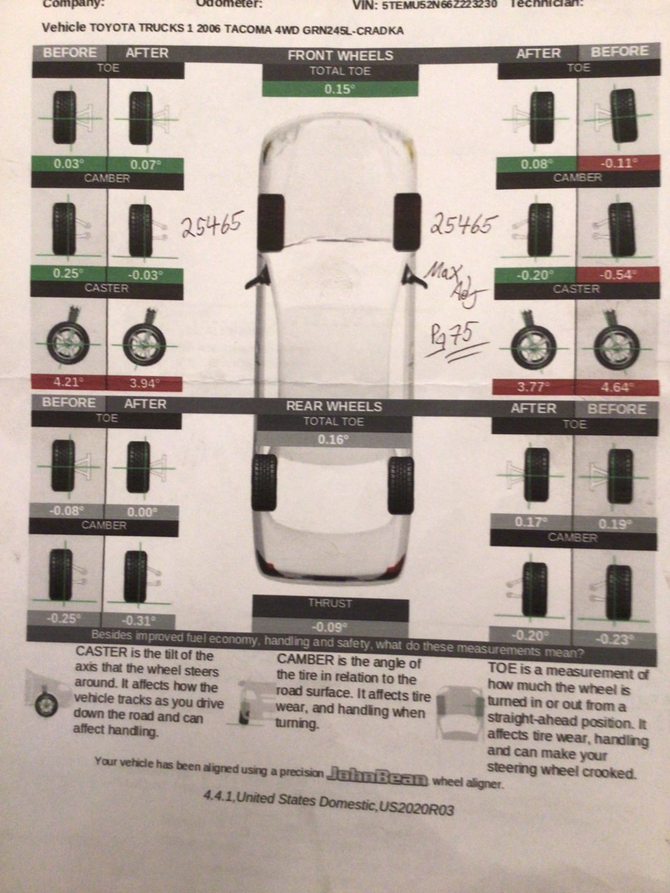

    do you have an alignment print out you can snap a pic of and post ?

  7. Nov 17, 2022 at 3:32 AM
    Evenflow
    Evenflow Well-Known Member
    Jul 15, 2013
    #108344
    5,766
    Jason
    San Diego, CA
    06' DCSB 4x4
    Yes
    That is a very minimal difference it should not be making your steering feel excessively light as you described ?

    Your caster is way too high. Based on my research, below is what I have stolen from the following thread (based on post #39): The mystery of loose steering | Page 2 | Tacoma World. My truck is aligned within this range and drives perfect. Side note: I'm on a 3" lift with Dobinsons UCAs which give me the right amount of caster "for lifts over 1.5". Your truck may have too much lift on stock UCAs, caster is not adjustable. You will want to buy some SPC UCAs which are very adjustable, or something like what I got which are ready to go out as they are.
    Caster= 2.3-2.5 (more/higher end for bigger tires)
    Camber=0 (but within -.3 to +.3)
    Toe=0 (or .05 ideal)

    Wow so those UCAs add 3 degrees caster, same as my Dobinsons, but our alignment numbers are very different. You must be running different LCAs too right? I don't know what else would cause such high caster angle. I'm runnning stock LCAs.
    Also, from what I understand, a low caster angle will cause "wandering" and i'm assuming this also goes along with a lighter steering feel. A high/positive caster will result in heavier steering but more stability on the highway. But you say your steering feel is light despite the high caster angle. Not sure how to explain it but not sure if it is a bad thing, more so just a "different feel" than before you worked on it?

    It may be. I have stock LCAs, and I asked, the bushings are still good with 180k kms on them. I asked to achieve those numbers, as JBA stated 3-4.5° to achieve. The original 2 alignments I had, I was told I was maxed out at ~4.3° on both sides. THAT was some serious wandering and bumpsteer. I still have some bumpsteer and wandering, but I don't need a death grip on the wheel to keep it straight. I did record your numbers, for when I can get in to talk to the tech, to see if they will help, I do appreciate the help.

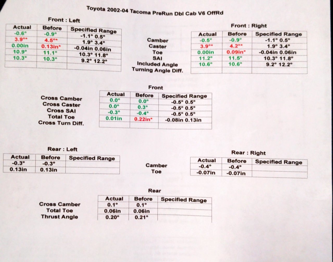

    FWIW op, I just had an alignment done yesterday and it's stable, drives great. Sitting on 255/85/16s. Different years, I know. Still wanted to share numbers with ya. Also agree with Bill. A good alignment shop/tech checks every bit of the suspension as part of the alignment.
    Note: my caster was above 4 because I didn't mark my UBJs when I replaced them (SPC UCAs). Stock LCAs with 20 year old adjusters.
