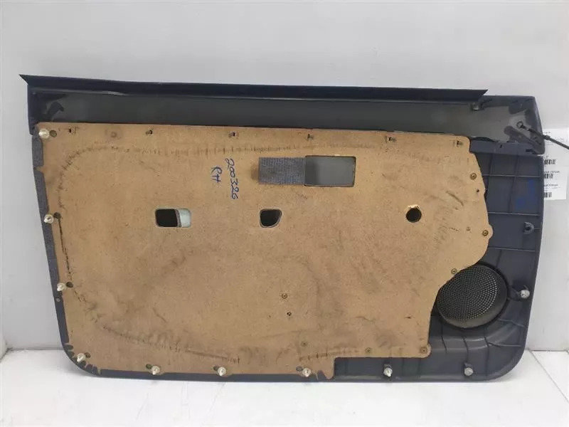

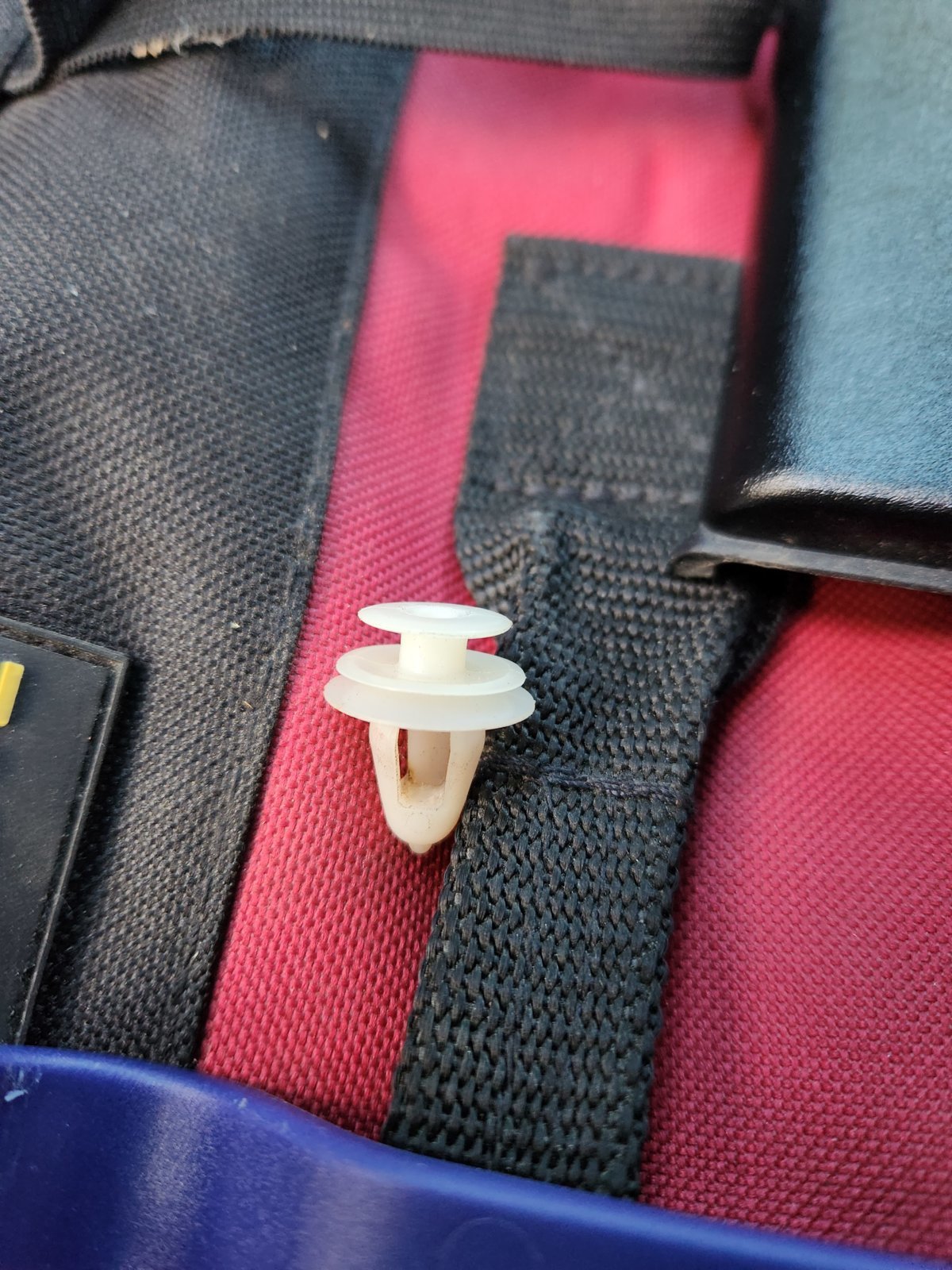

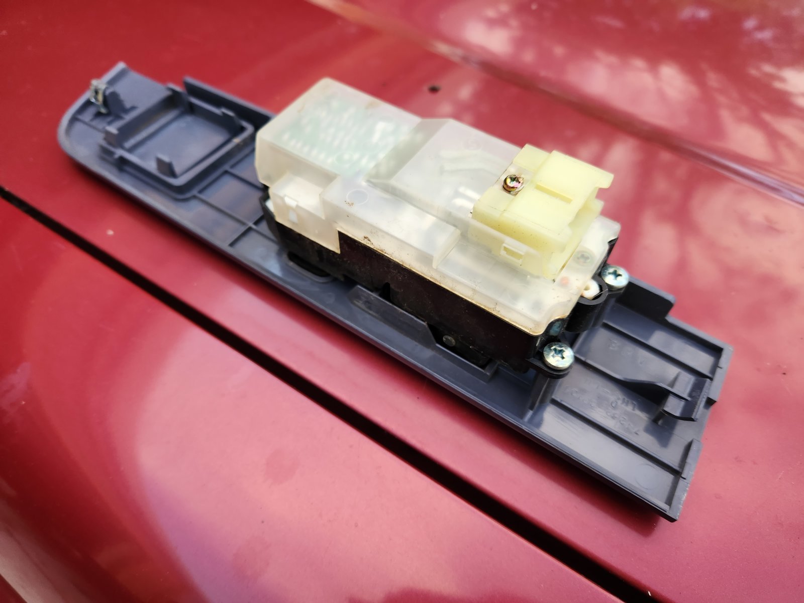

    Adding reference here - you also need to remove the bolt for the interior door handle, which then slides forward to remove. If you have power windows and locks, the control panel needs to be removed to unplug - must be pried up in front, then slid forward (if you pry up the back you will break the clip). The triangular trim piece behind the mirror mount holds the separate top section of trim down, and must be pried out on top, then slid up (the bottom has a clip that will also break if pried). Then the bottom edge of the top trim strip must be pried away from the rest, to release and slide up and out. From there, it's just snap-in retainers. If you had some of the panel come off the retainers, it will look like you might have to slide the whole panel to get it off the retainers, but this won't work. The keyed shape of the holes for the retainers is just for installing the individual retainers in the panel before installation.

    How many clips or retainers hold the panel on ? Thanks for the answer in advance.
  14. Nov 28, 2024 at 4:49 PM
    O'Silver_Taco
    O'Silver_Taco Well-Known Member
    Aug 26, 2021
    #375390
    4,171
    MD
    98 Dlx Sr5 ext AT Rwd
    3rz to 2Rz bebuilt block and new heads
