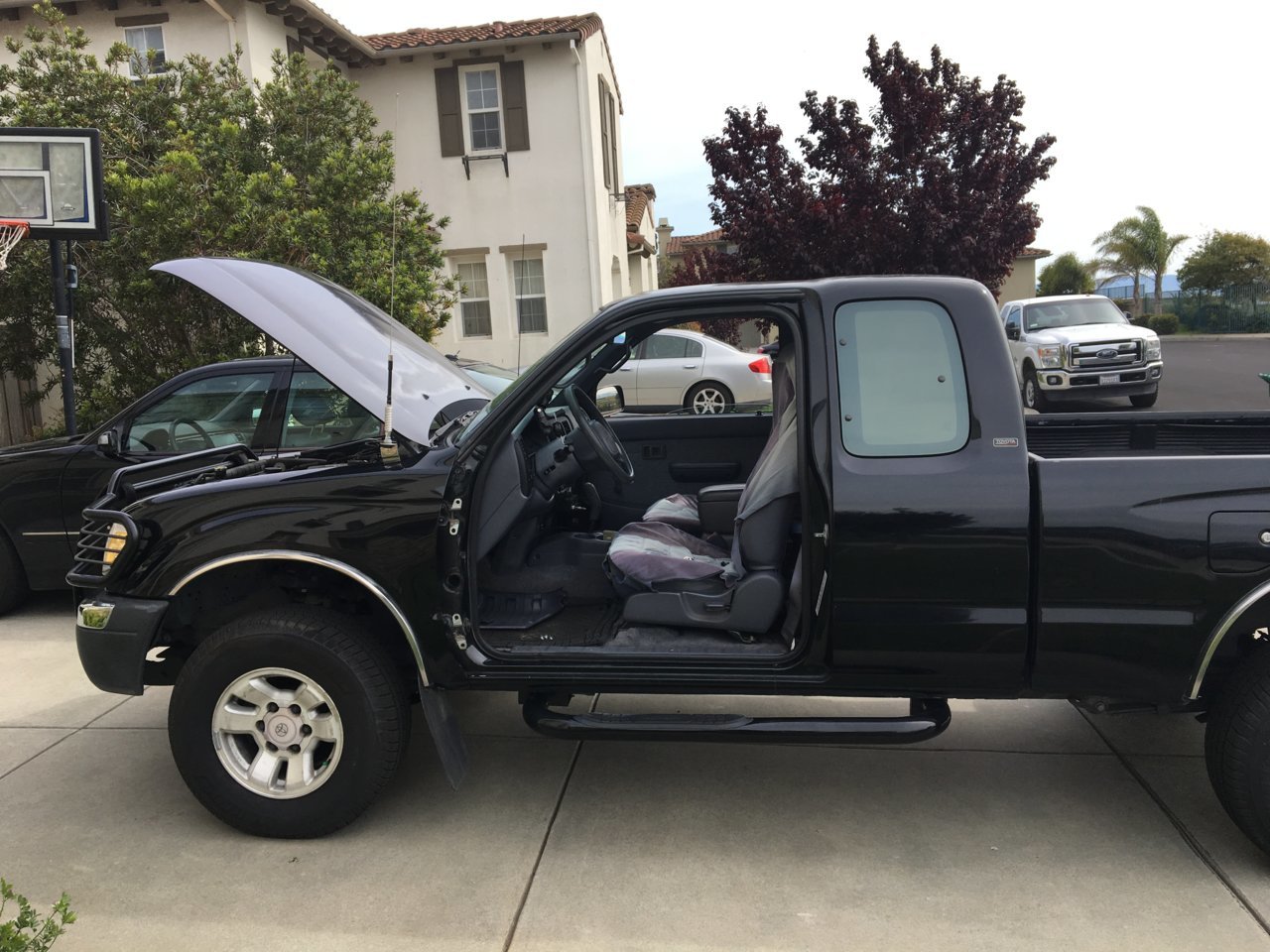

    I had a similar thought a while back when I owned one, and its a pain for a taco that isn't designed for it like a jeep.
    Keep in mind you will lose your speakers and also your mirrors, the later of which may get you a ticket. There are a couple companies that make tube doors and also doorless mirrors for 1st gens to get around that.
    Secondly, the doors help with body flex, and if you run without them long enough, the cab can deform a smidge, but enough for door seals to potentially not work correctly, or you may not be able to get them to fit back on if you wheel hard enough for long enough.

    If this is a serious question, unplug your door wiring harness behind the kick panel and it’s four bolts total at the door. Two per hinge. Remove door.
