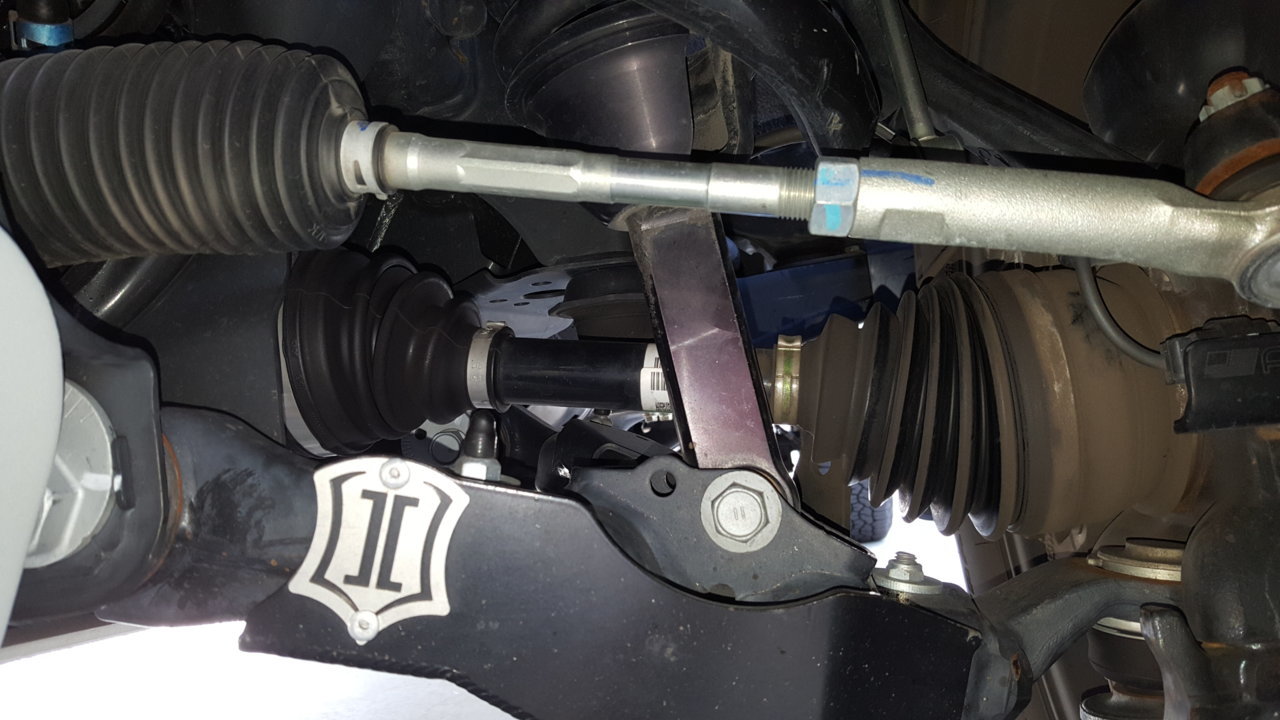

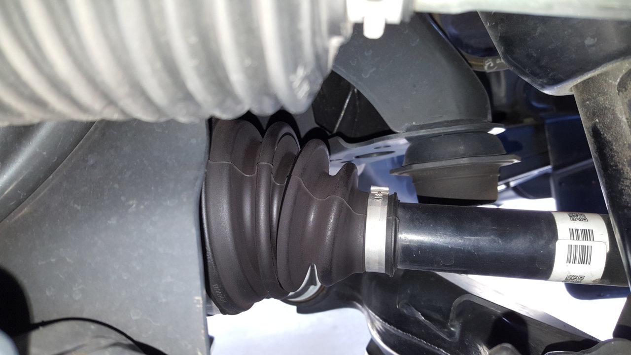

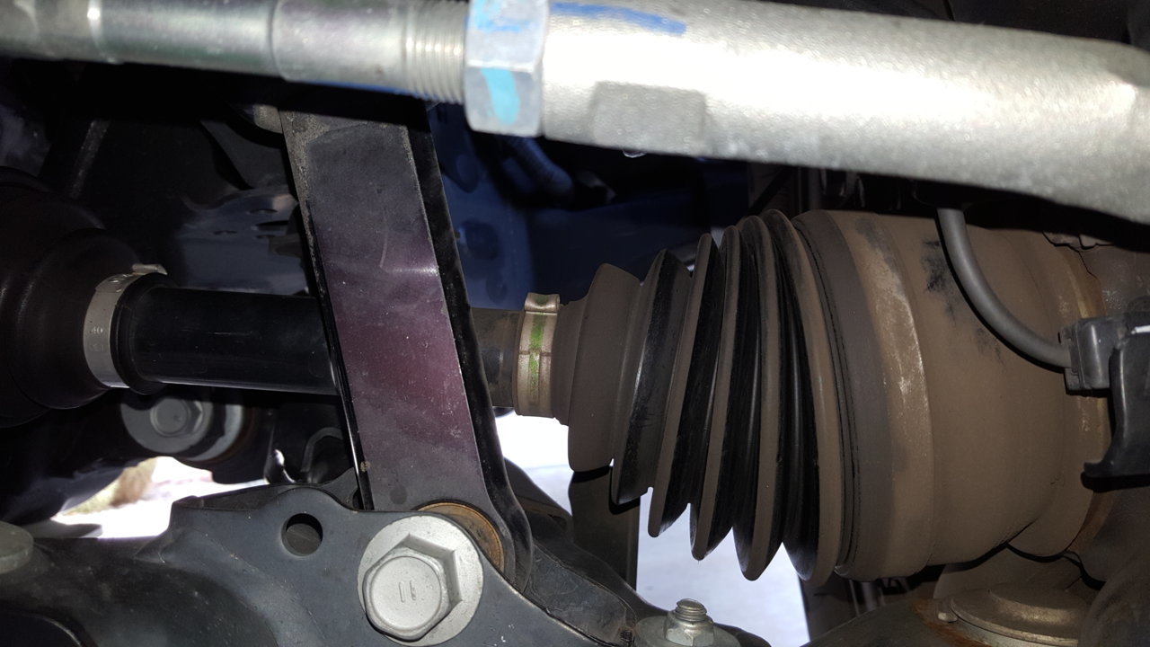

    @JoeCOVA will tires make a difference on CV angles? I would think so? Right now I'm on 265/70/17. Checked them today on flat surface and there are marks showing on the inner boots that they are touching. Outer boots are fine. Measured lift as well and from stock height, I went up about 2 - 2.5"

    @eldedo tried the business card test. Definitely fits in the outer boots but not the inners. Does tire size effect CV angles?

    Tires shouldn't make too much of a difference. If you are concerned about the boots rubbing you can lower the coil a few turns or even 1-2 threads.

    @JoeCOVA I probably will do that. I just dont get how so many people are running with similar set ups, with the same amount of threads showing on the coilovers but yet have better angles than I do lol.
