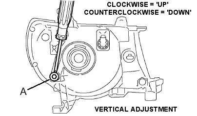

    The use of the screwdriver, or a small socket wrench on the washer fluid side made this so easy.
    Thanks y'all!
    I parked my truck about 300 feet from a speed bump and made an adjustment.
    Then I pulled up to a storefront with a 1/2 wall and full size windows to level them
    It worked great!
    Cheers errybody!

    on a 2012 tacoma there is no screw only a socket head connected to a geared wheel,,i tried adjusting this against a white garage door and i cant tell which way i moved it,,it appears when i turn the socket clockwise its adjusting the beam lower,,is this correct on a 2012 tacoma,,you turn the socket clockwise to go adjust the beam lower?

    Even though the the 2012+ lights are slightly different than earlier models, they adjust exactly the same. Clockwise with the screwdriver turns the "gear" to adjust the beam up. CCW adjusts it down. It takes 5 minutes.
