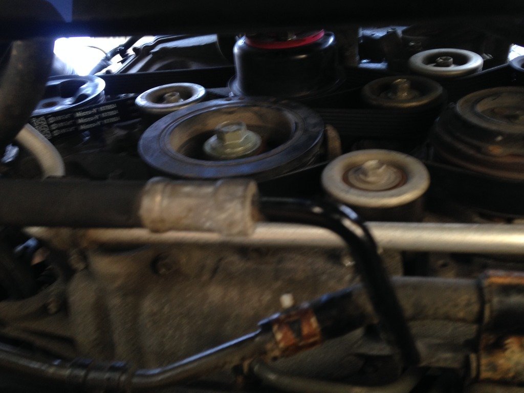

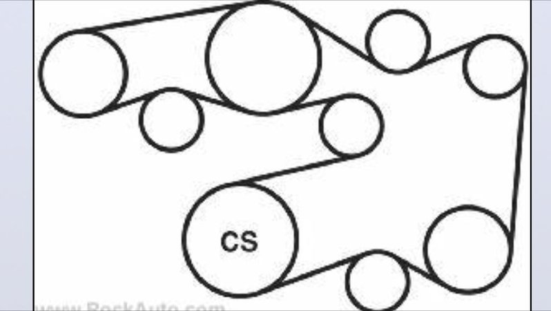

    Yeah, could have used some of this info the other day. Sucked working from the top. Diagram was very helpful tho

    I have long arms, so maybe the top approach won't be so bad.

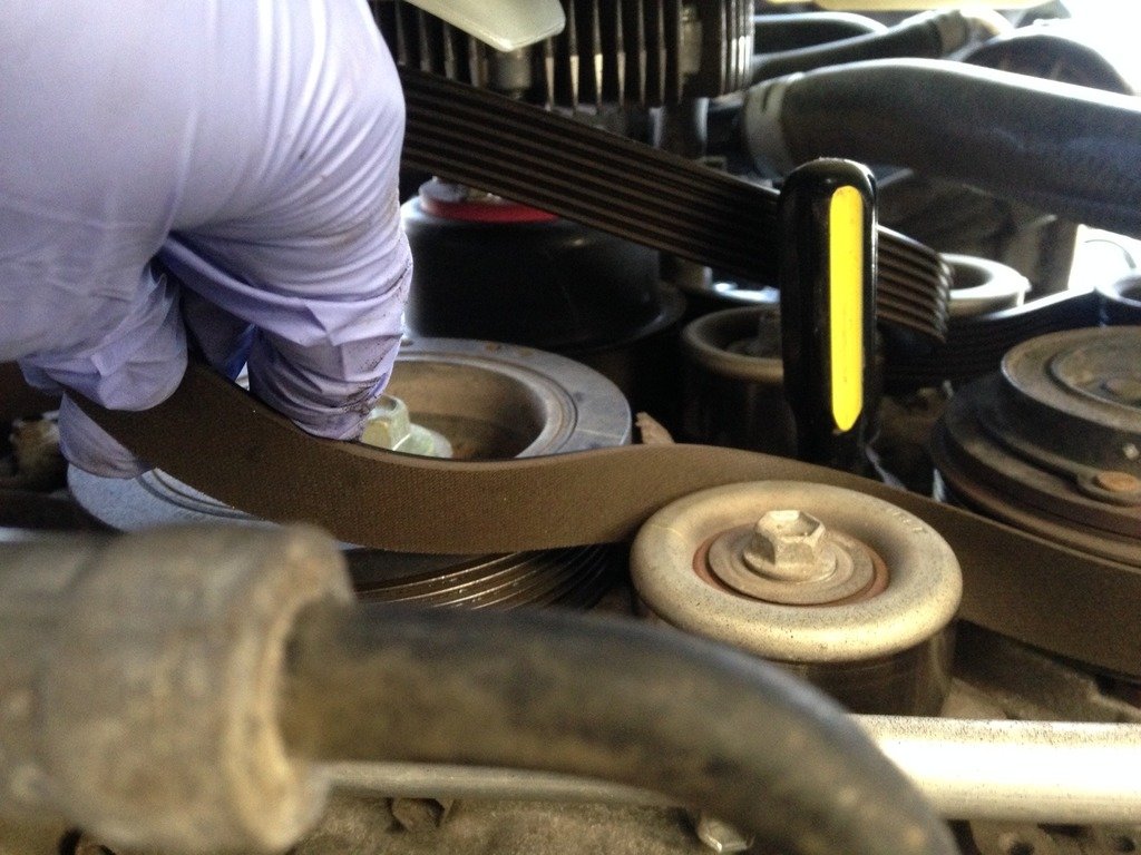

    Yeah you'll be ok. Toughest part is fishing it around all the pulleys...do the PS pulley last.

    This will help too

    This should still be on the underside of the hood.

    It should have been but wasn't.

    Looks as though my sticker for this has fallen off recently.

    Turn tensioner pulley bolt clockwise or counterclockwise to release tension to remove existing belt?

    I know this thread is old, just wanted to thank DDD for the great photos. Replaced my serpentine by myself in under 30mins for the first time.

    did the serp belt today...20-30mins...thanks for the info/pics TW/DDD!
