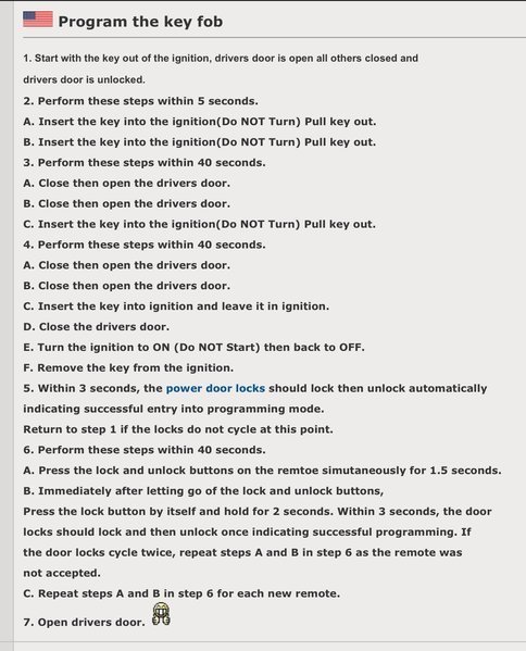

    That's the keyfob wireless receiver that controls the doors. If you have that, you can program a keyfob.
    I went through this ordeal on my 09, trying to figure a way to get keyless entry. Turns out my truck didn't have this receiver. I bought a used one on eBay and plugged it into the harness behind the glove box, and was able to program the keyfob first try.
    Edit: another way to determine if you have this receiver is to follow the Tacoma keyfob instructions. YouTube search for the directions. If your doors lock and unlock at the end, you're all set for a fob.

    Know this is an OLD thread BUT gonna ask a pertinent question anyways lol
    Can U program a FOB with a Valet key...Tried the steps for my 09 Taco but door locks never entered the program mode ie lock then unlock
    Guess going to have to haul out the Glove Locker to see for sure.
    ANSWER is NOPE lol

    Yes you can, just did it.
    I finally took out the glove box and found the receiver so I bought a cheap chinese fob off Amazon.
    The only key the salesman gave me was a valet key and it worked just fine.
