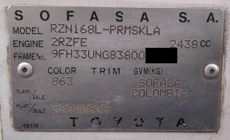

    Here is a picture of the vehicle ID plate on my firewall. The area for the trans/axle is blank which is no help at all. There are no other plates/stickers anywhere on the truck. Is there an ID on the differential(s) that gives the axle ratio ?? Also, if I want to upgrade to a locker, how do I tell which diff type is in my truck. Thanx.
    - JAMES

    Jack truck up and put on original size tires
    Mark the tire and make 10 revolutions while also counting how many times the driveshaft rotates. Get the driveshaft number of turns. And round up or down accordingly
    39 driveshaft spins
    10 tire rotations. 39/10=3.9
    45 driveshaft spins
    10 tire rotations 45/10 closest would be 4.56
    You get the drift
