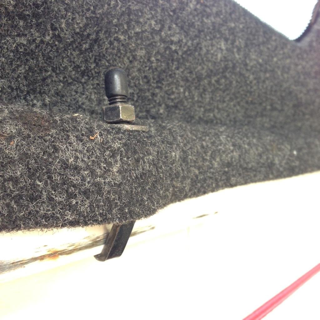

    I bought my shell used and it came with these clamps:

    I wanted to keep my bed liner with the shell so I cut about a 3''x2'' hole for the clamp to go through.clamp-1_475e8d3759309f87fe31a51d451f7ea6ee93f932.jpg

    Looks great too! Love your truck. I may end up drilling into the bed but don't want to because it was only a $40 camper to me and not a really nice one!
    Awesome!! :woot: I will definitely check that out since you have the same thing basically. Happen to have a picture? I'm glad it's not just me with this super wide lip. It does make a great 'desk' for phones and wallets when camping though :thumbsup:
    I never have seen those before this thread. I may go to those if the first suggestion doesn't work. Are they stronger than they look?
    Yeah I have some holes in my bed liner that I notched out. Can't really tell by the pictures though, I made mine a bit too big too :(

    They are steel, plenty strong. The shell is a Snugtop, so likely Snugtop clamps.
