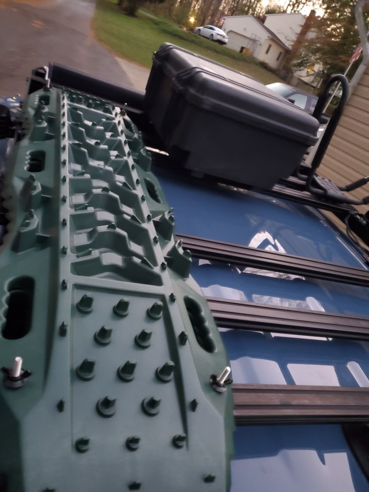

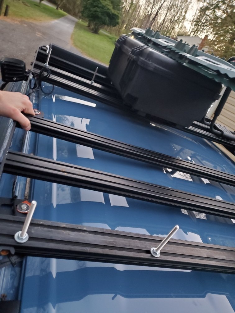

    INSTAGRAM: JWIZZMASTERWET #SUPERCHARGED #METALAF #HARAMBE PERFORMANCE/FUNCTIONAL UPGRADES: -URD Supercharger -Sound Deadened cabin with Noico Solutions 80mil -Skar Audio full pro-audio setup (2xtweeters, 4xmids, 3x10inSUB) SUSPENSION/LIFT/TIRES: -ICON Stage 4 (650lb coils) -ICON RXT Leaf Pack (Option 3), -285/65/18 BFG KO2 FUNCTIONAL(eye candy?): -Rave OffRoad roof rack -Rave OffRoad 43in light bar (amber + white) -Rigid led PODs (x4) (mounted along roof rack) -Westin Side Steps -BakFlip tri-fold tonneau cover -VOODOO Fabrications hi-rise crossbars -Pelican Case loaded with recovery gear(mounted to roof rack) -Smittybilt gen 2 overlander tent -Smittybilt recovery boards -HI-Lift Jack COSMETIC AND NON-PERFORMANCE UPGRADES: -Custom front grill -Bumper Shellz rear bumber cover -Meso Customs full interior chrome delete -Interior of cabin lined with sound deadening material (Noico Solutions 80mil) -Rear seat delete and custom shelf (home-made) AUDIO (SKAR AUDIO): -2x pro audio tweeters, 4x pro audio mids, 3x 10in subwoofers (SKAR AUDIO) -1x RP-1200 amplifier (mids), 1x RP-2000 amplifier (subs), 1x SK-400 amplifier (tweeters) (SKAR AUDIO) -Audio crossover

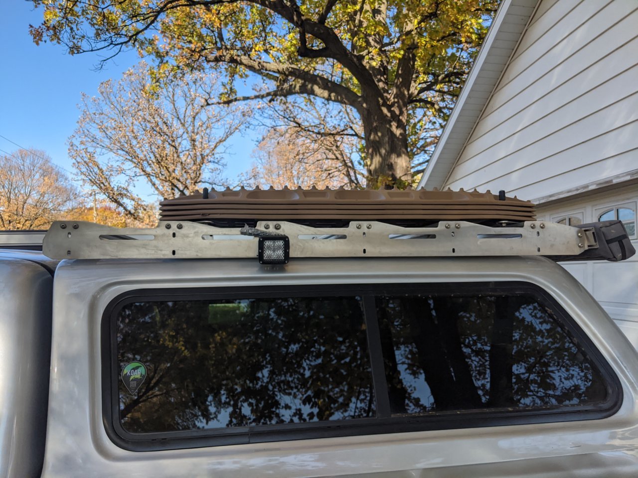

    Here are a couple pics of ways I have mounted mine. The same mounts can be used in the bed track, in T-Slots or around square/round tube on Gobi or Baja style racks. The pin locations are slots so they work with more than just MaxTrax as well. Laser cut from Stainless Steel.

    I'll add that I would also offer a group buy on them if there is interest. I only have 1 or two sets left at the moment and need to get another run going.

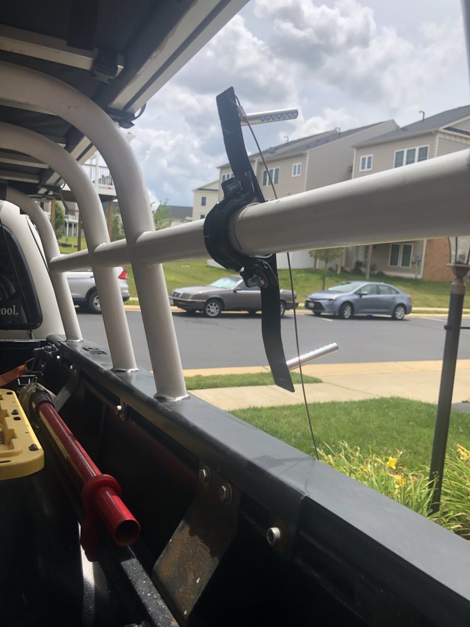

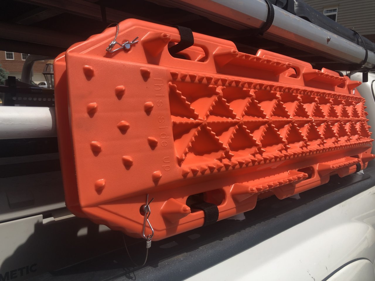

    I repurposed my sway bar brackets, some universal hitch pins, and stainless steel wire

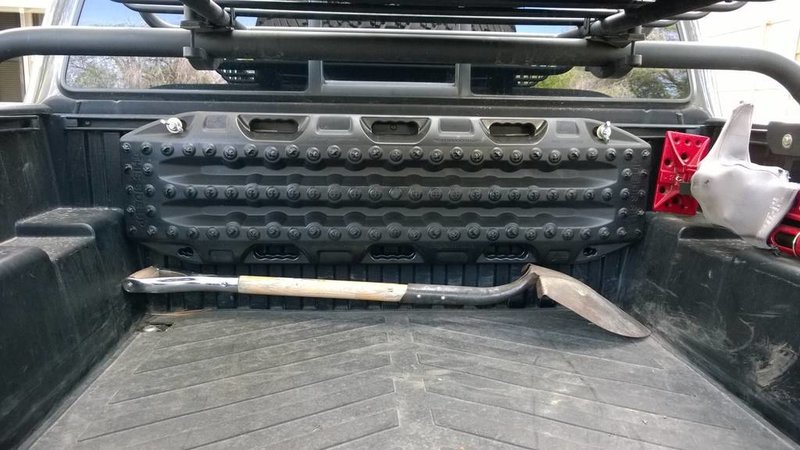

    Carriage bolts straight out of the rail. Wing nuts. Weapons safety cable lock. (File down two sides of the carriage bolt head to allow better fitment in the rail.)
    Ignore the other cable. It is for my tool box.
