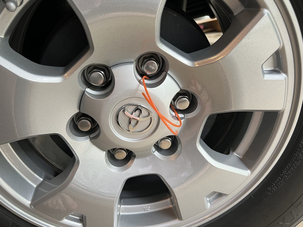

    Pretty sure the OP figured out the center cap situation. Just got my 16-inch SR5 OEM alloy rims powder coated and wanted to know how to remove the center caps with NO TOOLS to replace one of them. Fed a piece of string trimmer line through two adjacent openings on either side of one the cap spokes and gently popped the cap off.

    You’ll find a few with slots by the lug nut. A large flat screw driver in the slot and pry forward. Snaps on and off.
