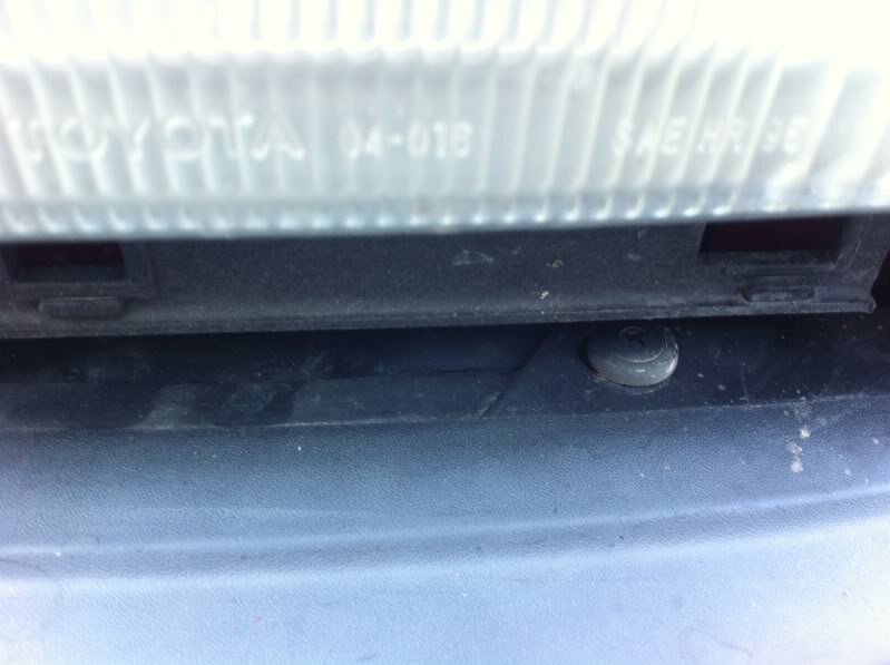

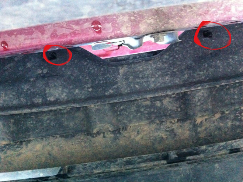

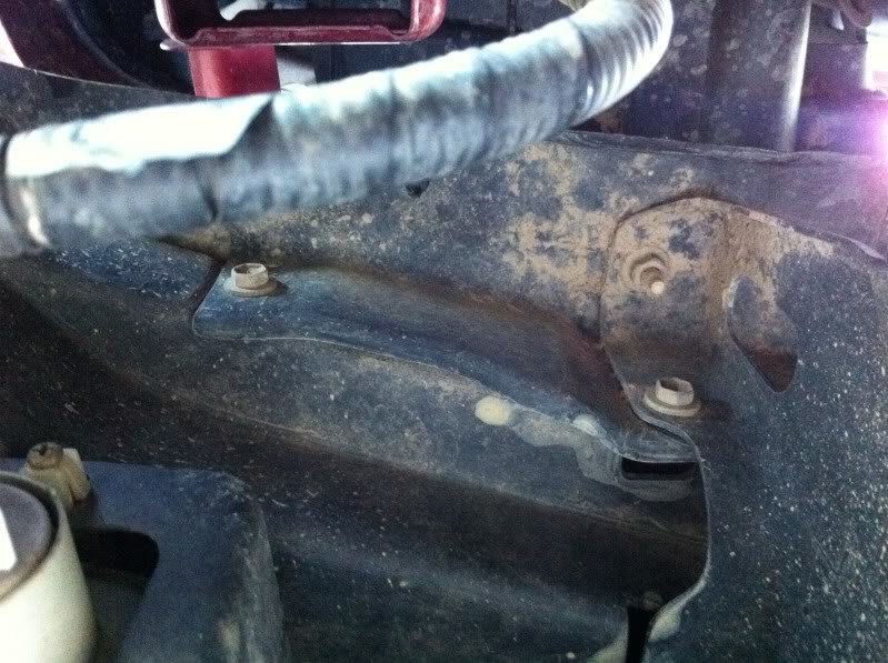

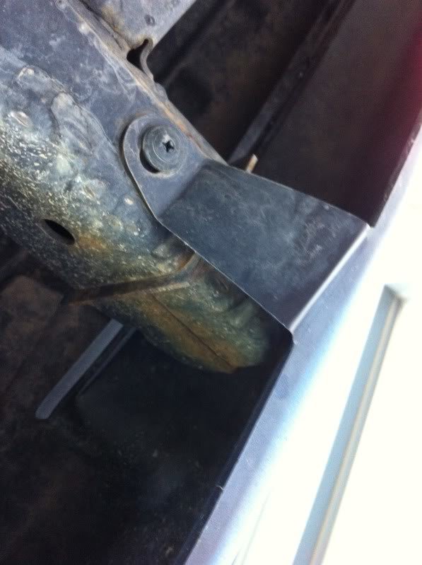

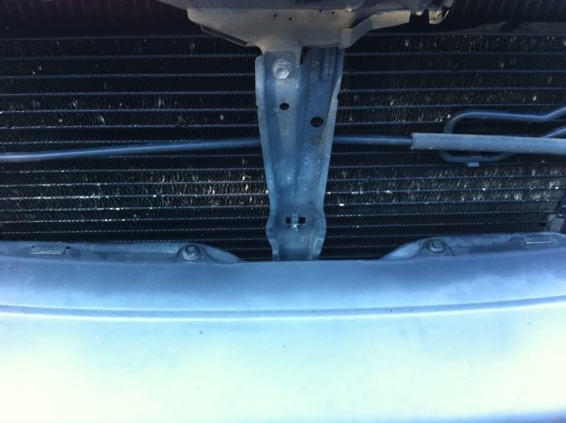

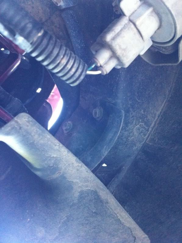

    Here's pics of what I'm looking at:
    Top of the bumper. Those plastic screw fasteners. There are four total. Two in the middle (seen here) and one under each headlight assembly.
    Here's one under the headlight assembly. The fact that you'd have to take the headlights and then the brackets out just to get at this one screw makes me believe that you don't touch these plastic fasteners. You just take the whole bumper out by removing the bolts from behind/underneath
    The bottom of those plastic fasteners. They go through a plastic bracket that is bolted to metal brackets which are attached to the frame (I believe)
    Looking straight up from the ground. Those bolts go through the aforementioned plastic bracket that is held on to the back of the bumper by those plastic screw fasteners
    Looking up at that driver's side corner
    Attached to both bumper stops (is that what they're called?)

    There's only two bolts that hold the entire bumper in place?

    I can't really see your pics on my phone but I doubt the plastic holds it on.if I remember correctly there were two plastic fasteners but can't remember what they held.
