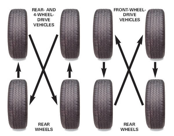

  20. Mar 1, 2012 at 11:46 AM
    #20
    Pugga
    Jun 18, 2010
    #39131
    38,691
    Massachusetts
    '19 Ford F-250 6.7 SCrew
    F-250 Land Yacht Mod
    Best way to rotate your tires is to do what the manufacturer recommends. That way if there ever is an issue, at least you did what they recommended... Here's what Cooper recommends:
