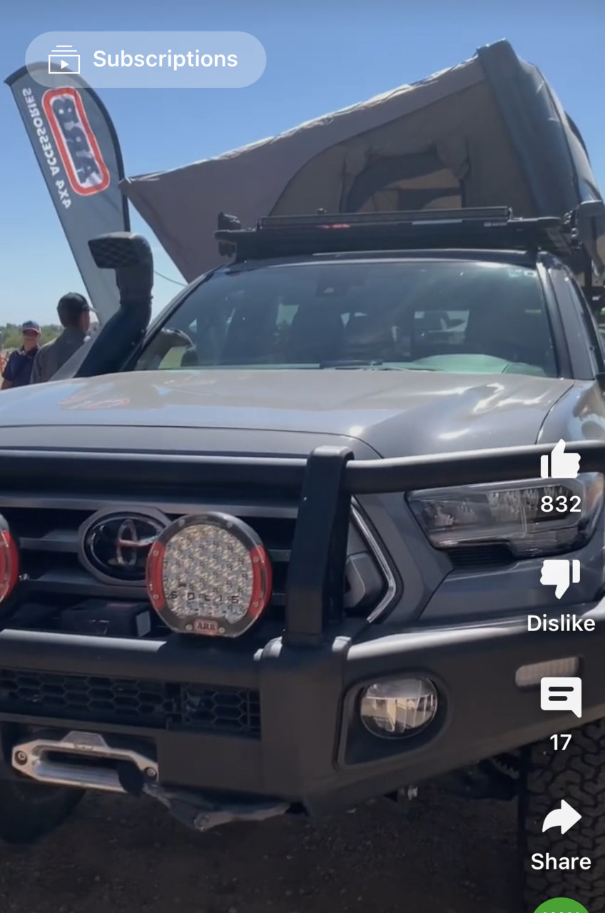

    I’m in deer and antelope territory, sometimes early in the morning when they’re active. Need a bull bumper with winch. I am told that the emblem middle of grill on front is the sonar for cruise control.
    how much field of view does that thing need to not be blocked by bumper rail I put on?DC8E7977-4DE1-409C-93F6-5BF0255EC62A.jpg

    As long as you are clear of it by an inch or so above and below, you should be fine. This is not based on any real documented specs, just my experience with a bumper that partially obstructed it. With a partial obstruction, it would work most of the time but occasionally give an error.
