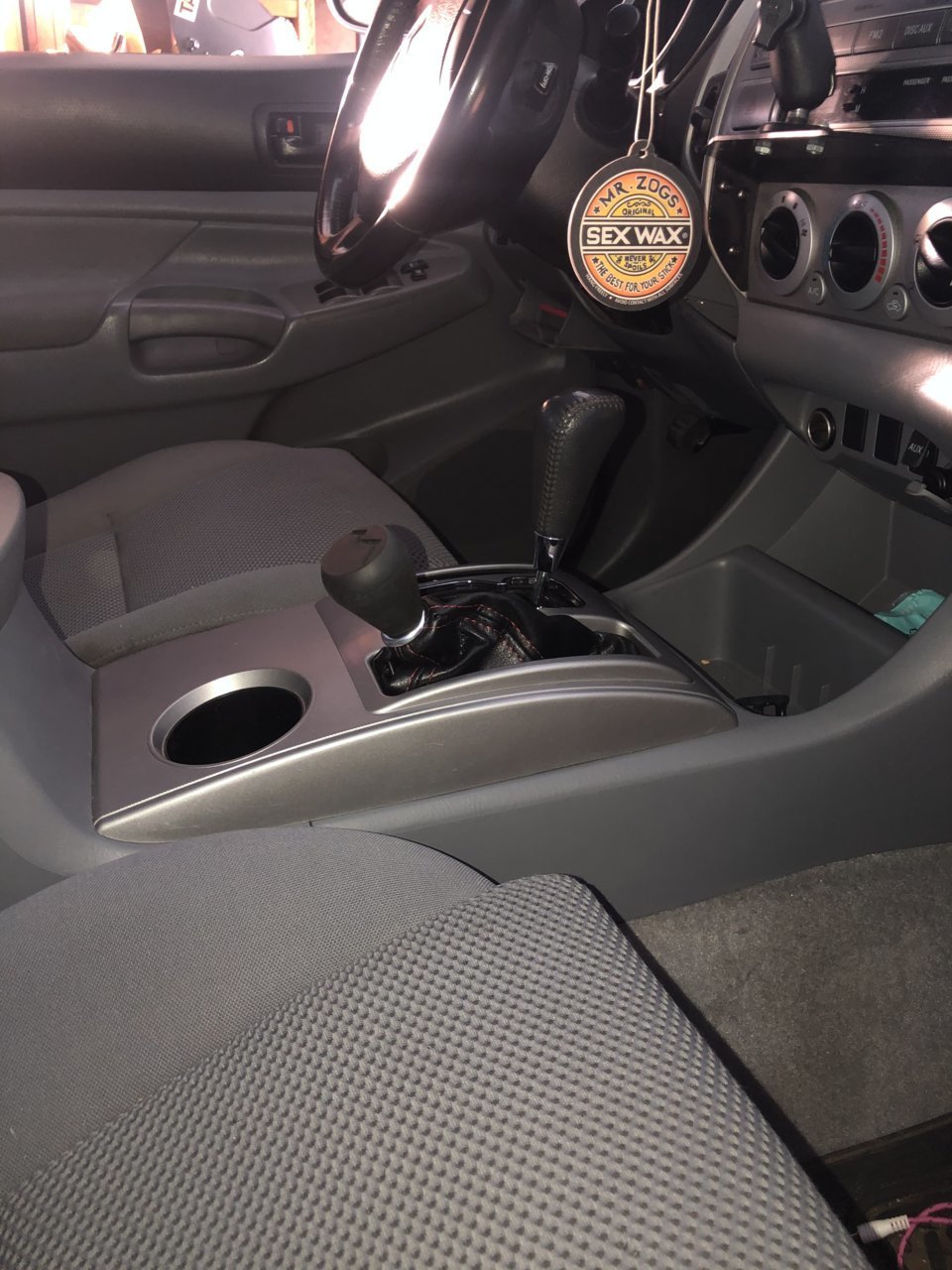

    I decided I'm going just going to turn my stock electronic case into a manual case using a transmission shift cable and shift lever. It will be really easy I just need to make sure it looks clean. needs to be as clean as my dual case shifter

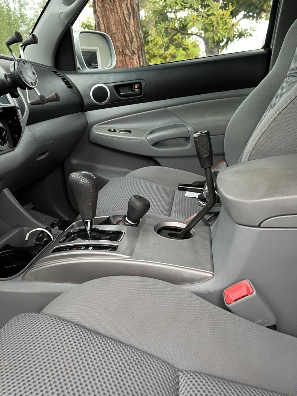

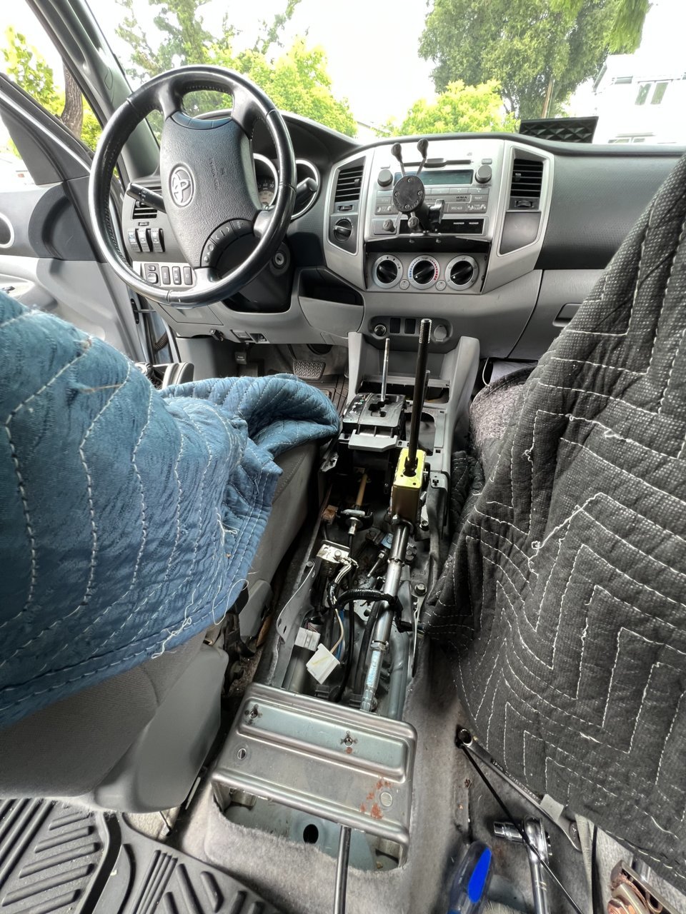

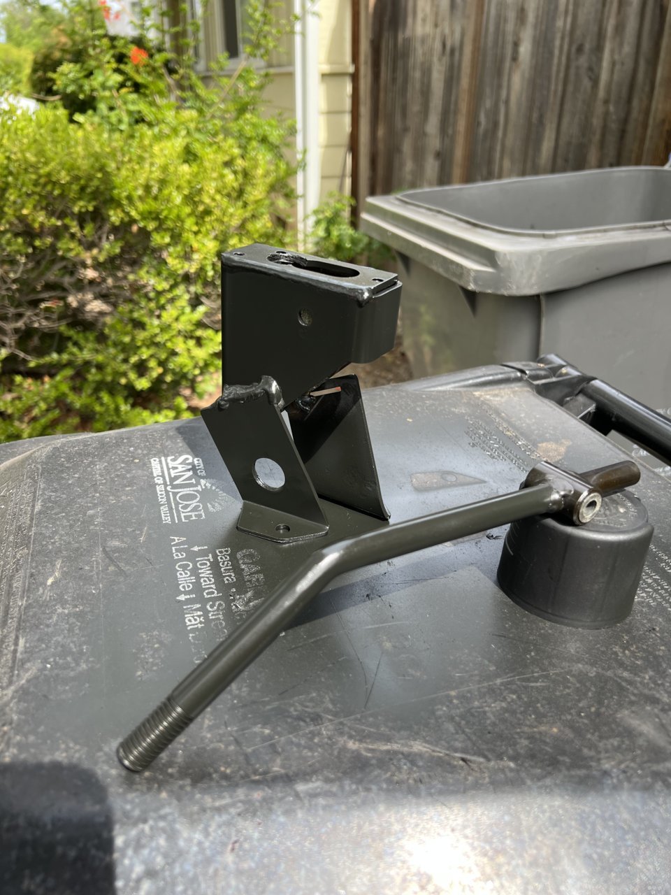

    I made some progress on the shifter setup. It throw is less than I thought. About 1.25-1.5”. I need to make the connection at the tcase and it will be finished.

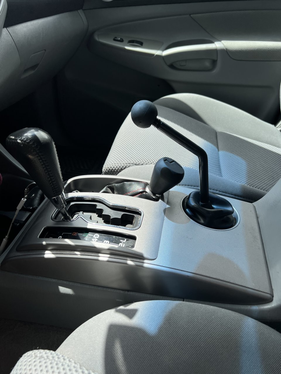

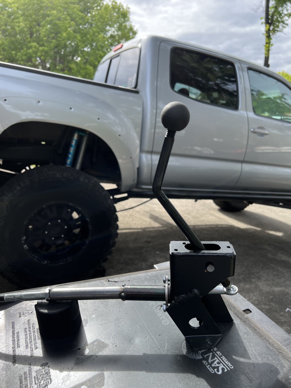

    Got the cab back together. Turned out pretty clean. 6EBE96E5-B377-468E-A1CC-F3370CDE7DE6.jpg

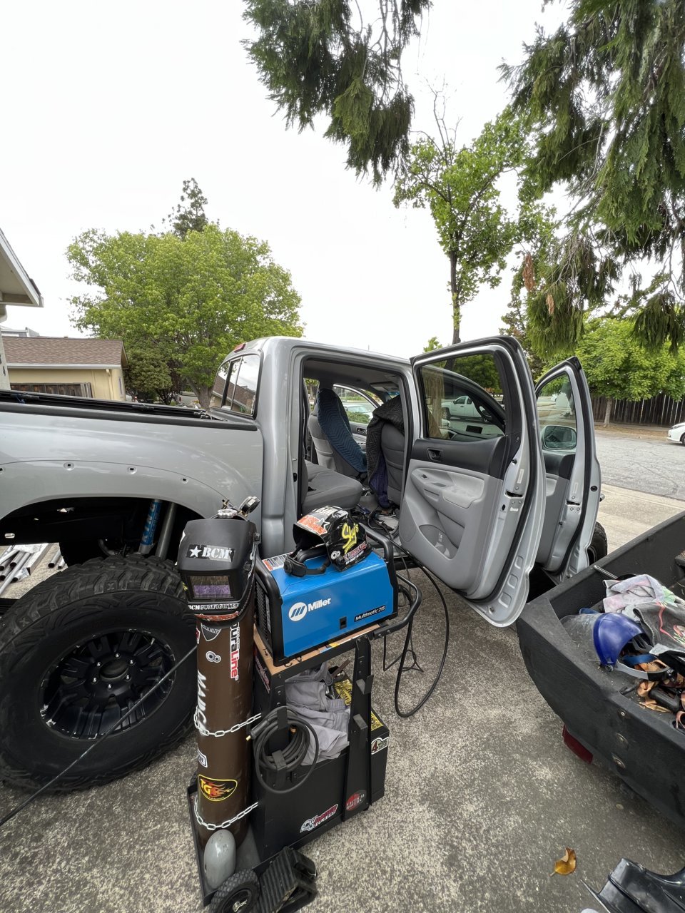

    I bought the advance adapters 4 speed shift kit and it comes with the shift lever, housing, cable and other parts. The cable throw distance isn’t long enough so I used another one which is kind of shitty. I cut the end off the advance adapters cable and welded it to one of the ends of the other cable. I had to make the brackets which I mounted on the ebrake bolts under the center console. There are a ton of ways to rig it. The end results will be the same. I cut and bent the shift lever to clear the center console. I’ll post some pics of the whole thing later.

    The way that I did it I had to remove my inverter which is located under the center console. With the right cable setup you could probably keep it in that location. I’ll probably put it inside my center console.
