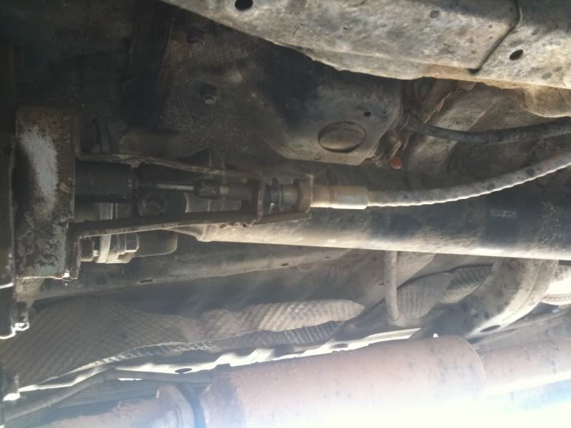

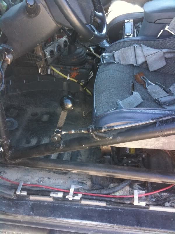

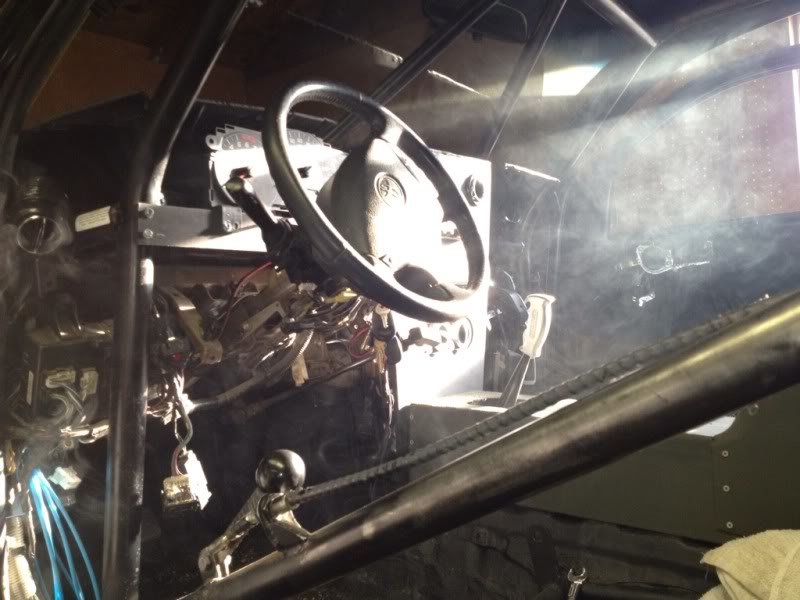

    I forgot to add my manual shift T-case mod. The cable is an old outboard motor shifter. Evinrude FTW.
    Shifter on the left side of the cage.
    On the T-case side.

    Ya, all the way forward is 4lo, one click back 4hi, and laid all the way back is 2HI.

    No, I didn't do a write up on it. I wouldn't advise anyone who isn't a hillbilly to repeat this mod, and if you are a P.H.E. (Professional Hillbilly Engineer) then you don't need instructions, and if there were any you wouldn't read them anyway. :D For the ADD, I just manually slid the ADD into the locked position, then bolted the ADD actuator back in and unplugged it. It's sort of like driving around with the hubs locked in. The ARB is open when it's unlocked, so it works great that way. My best advice is to go grab a 10mm, 12mm, and a flat screwdriver and take the T-case actuator apart and see how it works. Then go look in the scrap pile and see what you have to make a manual shifter and do it. Easy as pie man.
