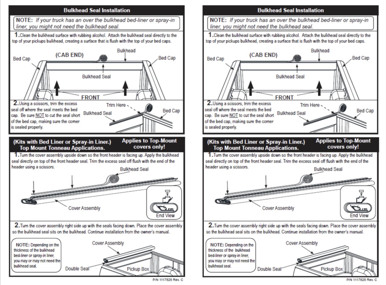

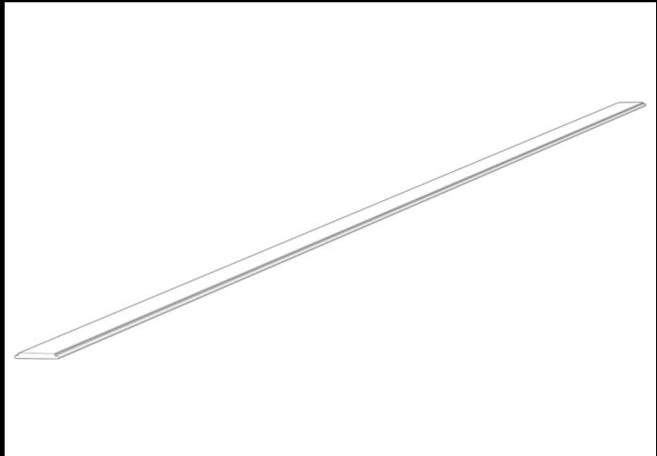

    interesting, the photo of the product I found is this and then i asked customer service for any more info and they sent this. I guess this isn't what you were referring to but I do not see any other product called bulkhead seal. Can you send a link?

    That is not what I got. The part # I ordered is referenced up i this thread. Honestly, I don't recall much more, this is from 2019 so it's been a while.
