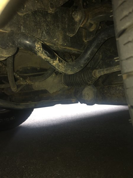

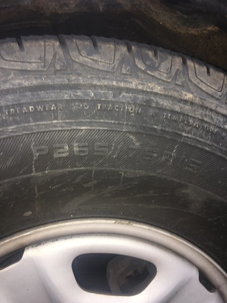

    I replaced my stock 215/70R15 on my 2012 2.7 2wd 2dr Tacoma with 265/75r15 tries and I have considerable wheel rub around full lock. How high should I lift it to get rid of the rub?

    is it rubbing the frame? Or cab mount? If its rubbing the frame you need wheel spacers or wheels, if its rubbing anything else a moderate lift could help or you can just trim it all

    It's rubbing the frame

    It rubs at full lock

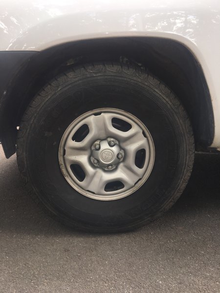

    Are you running stock wheels or after market wheels?

    They are my stock wheels
    On the first photo what is that called that the tire is rubbing on?
