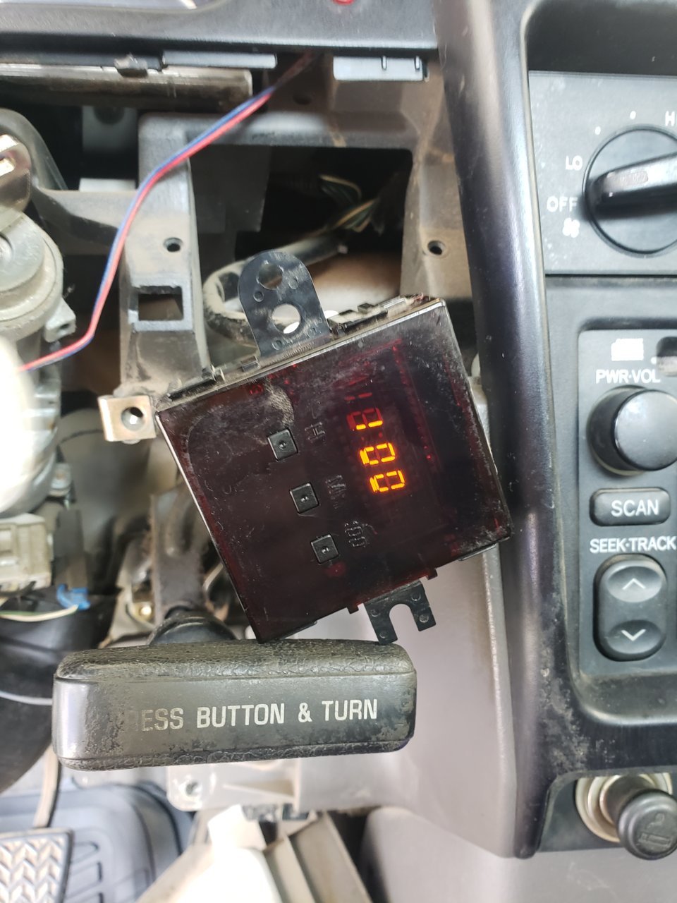

    for years it acted up going dark intermittently, got progressively worse until it just went dark all the time, I noticed if I tapped on it with something hard or push on it just right it would come on momentarily Then one day I tried this:
    it worked steady for a week, so after a week of it working, I cut out two pieces of old credit card about 3.8" wide the length of each side left and right, folded them lengthwise , painted them black with a sharpie felt pen and stuffed them in place between the bezel and clock face It has been working steady for three weeks like this.

    Of course, tried it several times, tried cleaning the plug contacts, thats not it. Has something to do with the contacts at the buttons on the face. You can also send it to some guy on e-bay who knows how to fix them for about $20

    2001 DCSB SR5 4x4 Lunar Mist 2009 DCSB SR5 4x4 Black
    I fixed mine with identical symptoms by re-soldering the contacts on the back of the clock. They look ok but develop hairline cracks over time. Very common problem with the oem clocks. I think you tube had some videos on what they look like.

    I did this too.
    Here is the clock with a crack in the resistor solder. Then I resoldered all 3 of them and it works.
