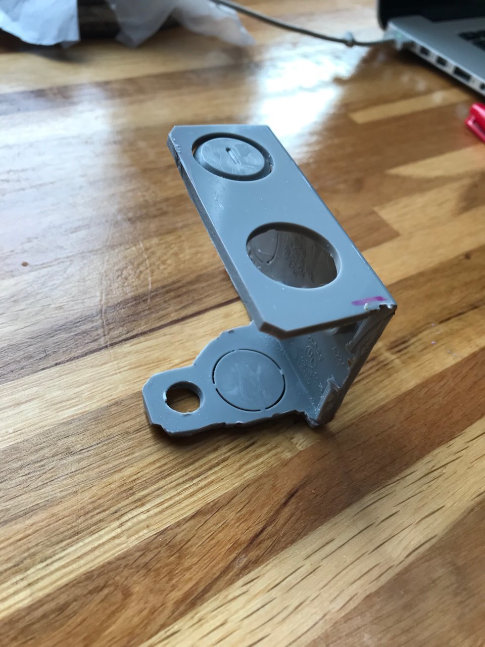

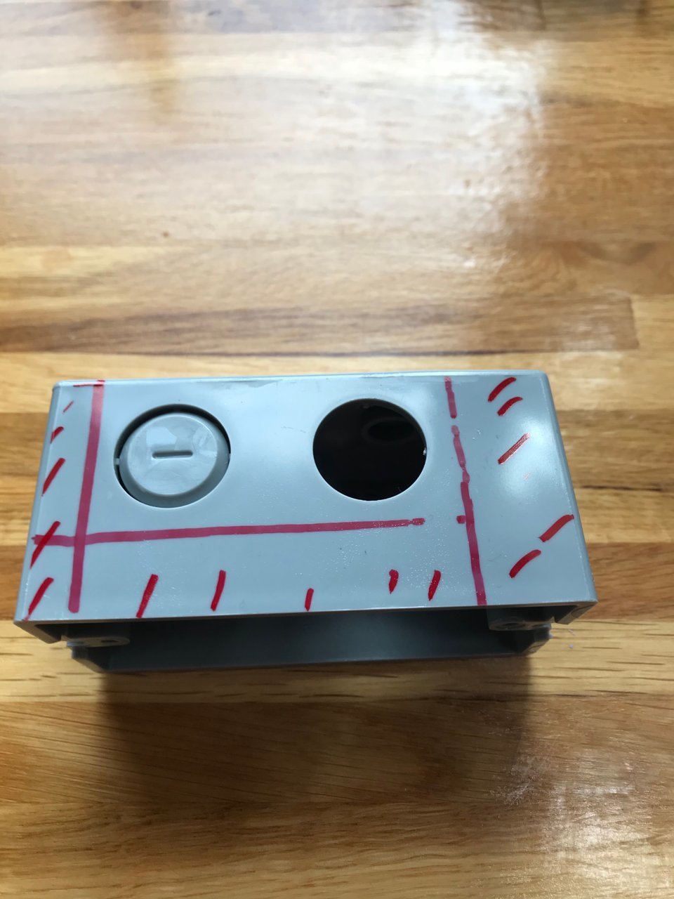

    This is how I wired mine using the less expensive Hi/Lo round plug. I am going to put a switch in the open hole to disconnect the seat heater so I can have only back heat for long road trips etc.
    Simple and easy mount with no dash mods required and easy for driver to reach both driver seat heater and passenger side as well. Used metal cutoff wheel in grinder to cut the box.

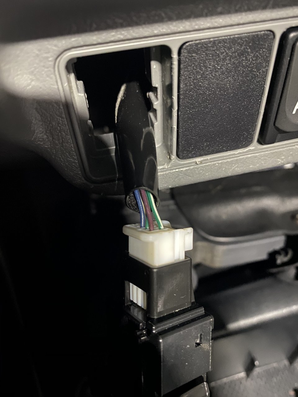

  18. Jan 27, 2021 at 10:12 AM
    #78
    AlHago
    AlHago Well-Known Member
    Jan 30, 2019
    #281295
    315
    Alan
    Huntsville, AL
    12 DCLB MGM
    Stock as all get out.
    currently trying to figure out.

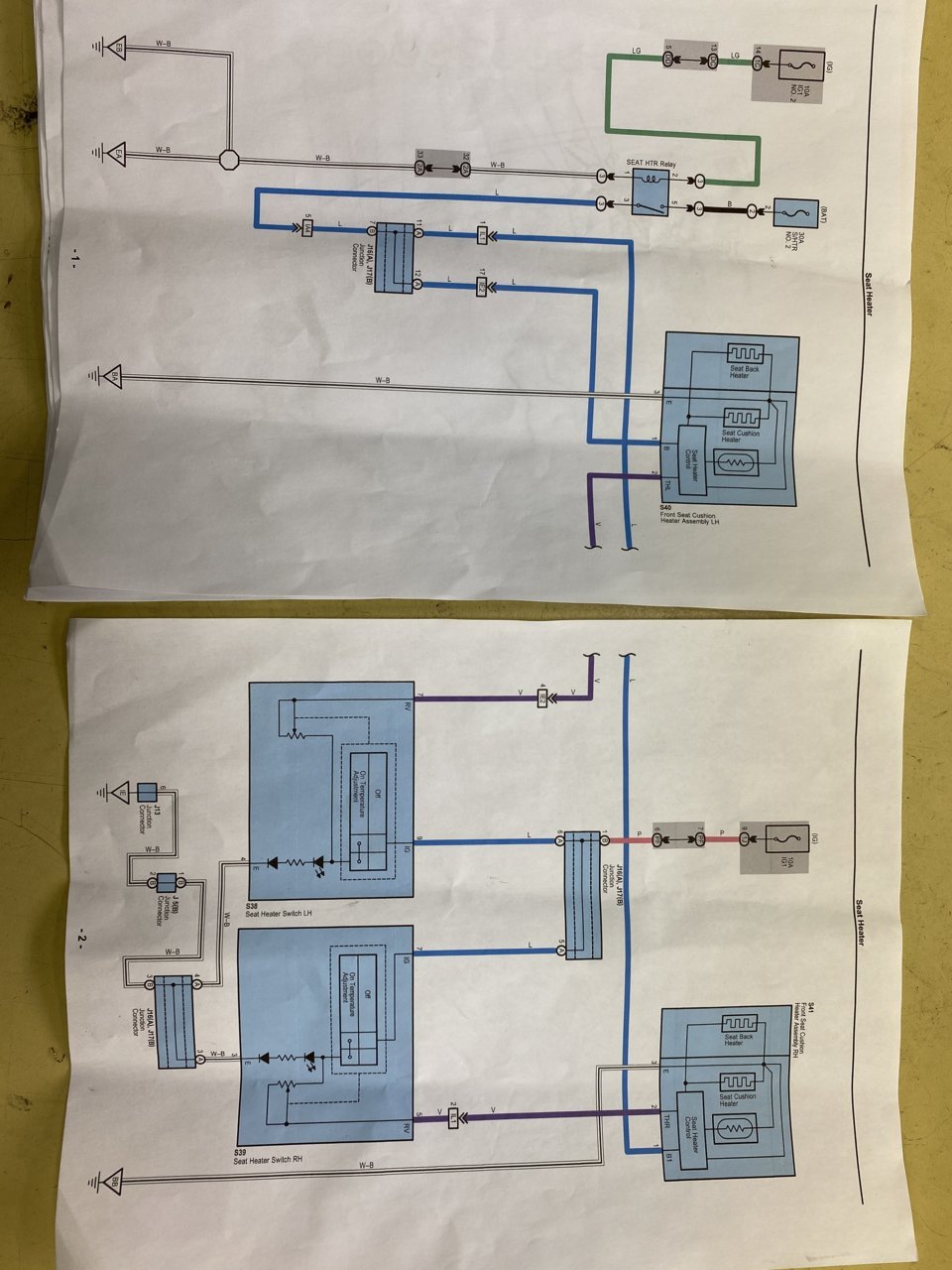

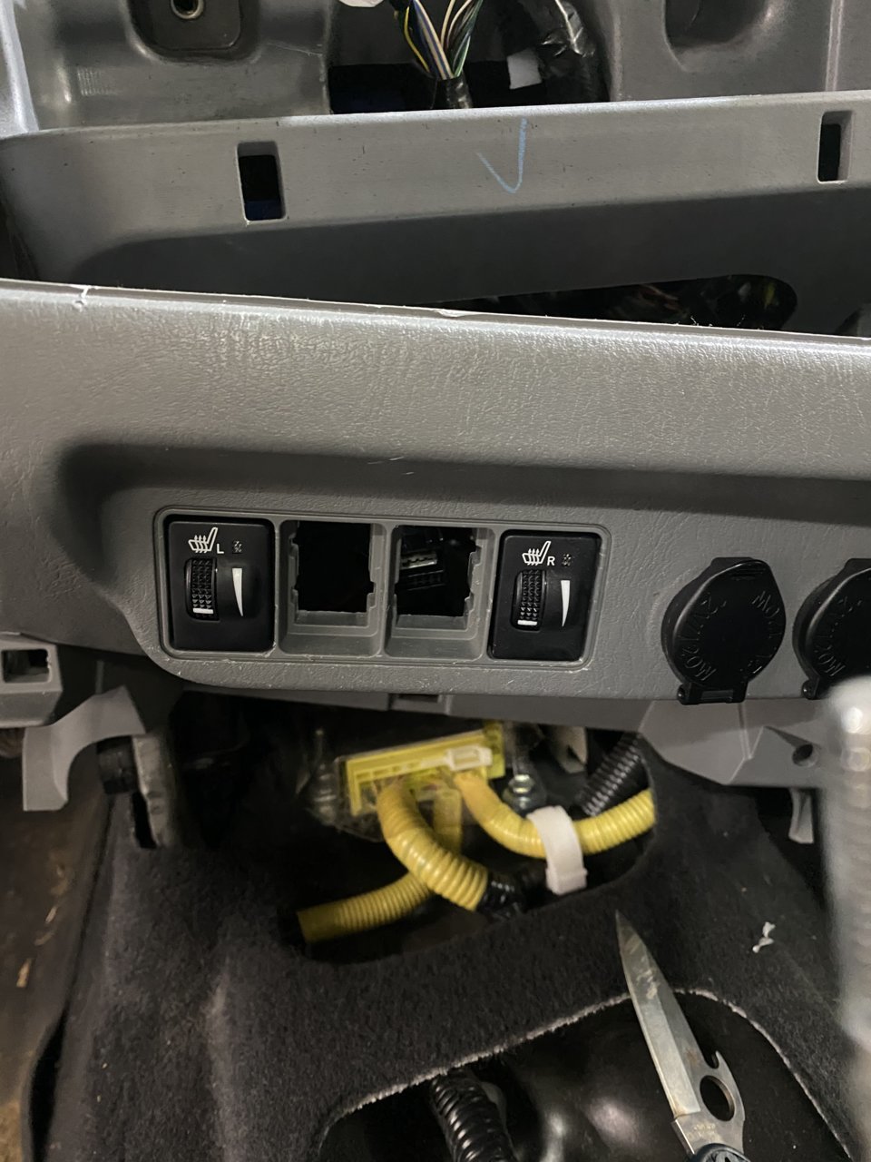

    1. My truck seems to be pre wired from the factory for heated seats.
    2. I have wet Okoles with their optional heated seats added.
    3. Bought oem switches and they plugged into the factory harness behind the blanks. Also bought the fuses and relays for the factory fuse panel.
    will post updates if I can wire the wet okole seat heaters into the factory harness.
    These are factory wiring schematics I received from my local Toyota dealer.

    Do you also have the control modules for each seat? They receive the variable voltage signal from the switch roller and use that to modulate the current from the 30A fuse/relay. It’s shown as part of the seat assembly but with aftermarket heaters it’s a separate component. It may or may not have been included with your wet okole’s. Or it may be part of the oem harness.

    Currently trying to locate that oem module, do you have any idea where it may be?
    I saw the module for sale and I think it was about $90 per. Trying to keep it low cost, for that price I could buy the aftermarket heaters and switches that a lot of people are using without more headaches haha.
