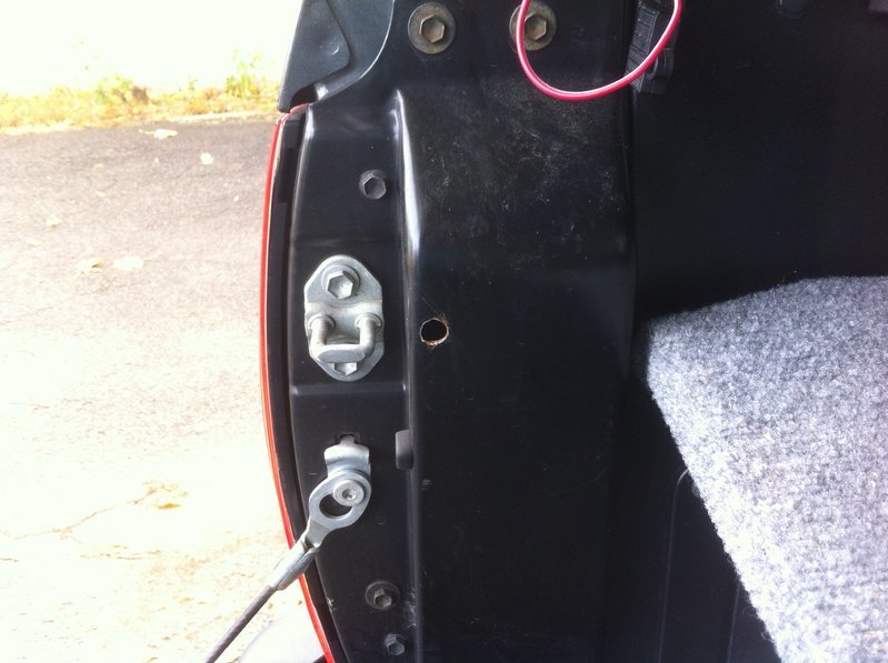

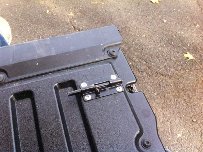

    My tail gate lock cost $8. Two 4inch barrel bolts mounted on the tail gate and two 1/2in holes drilled into the sides of the bed.

    IMG_1067.jpg IMG_1068.jpg Not exactly Fort Knox but maybe just enough for somebody to move on to the next truck. As has been mentioned, a brick through the window defeats all locks.

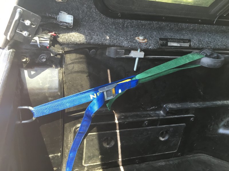

    Here is my similar fix
    Hamer95USA and ThatguyJZ like this.

    And cheap! Works great too. Mount the barrel bolt first with sheet metal screws and mark where it hits the bed frame. Drill a small (1/8") pilot hole to center it then a 1/2". Done. I did both sides, makes the tailgate rigid.

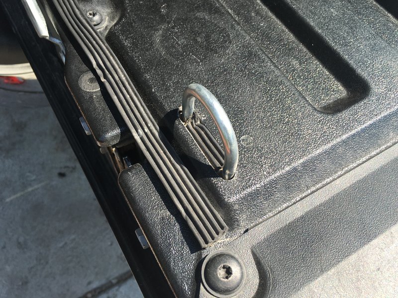

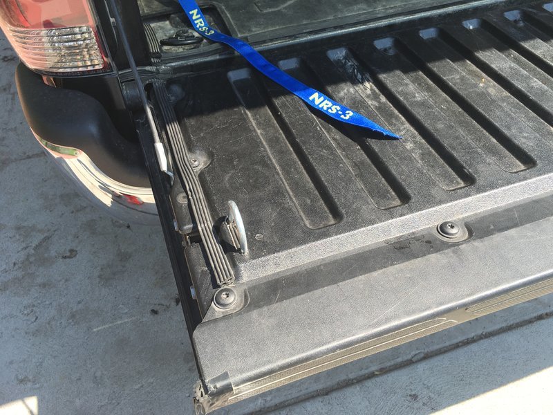

  20. Oct 8, 2020 at 3:34 PM
    #20
    Ebymon
    Ebymon New Member
    Oct 8, 2020
    #343230
    4
    2010 Tacoma full setup all options :)
    Also idea without drilling, if you have somewhere to secure it to the bed track or clamp somewhere inside: chain/rope that to a carabiner to something secured to a tailgate bolt. I had installed handles there anyway with paracord and tubing to close the gate from the inside while camping. A thief almost couldnt tell it's locked until trying, but thief could break the plastic on my rear window and open tailgate pretty easily if it weren't for this.
