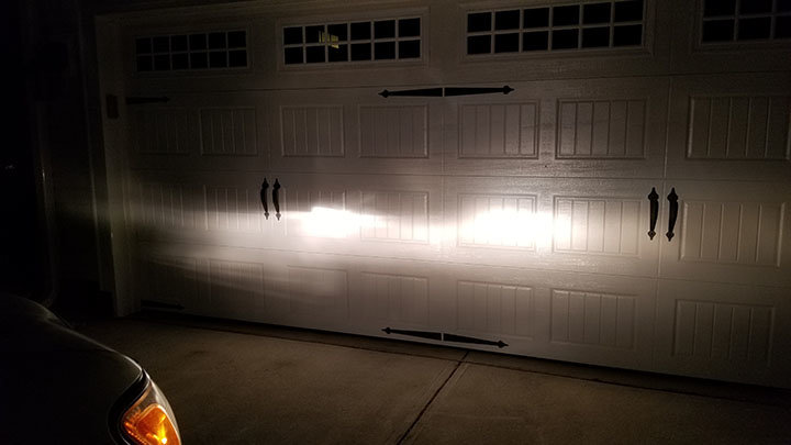

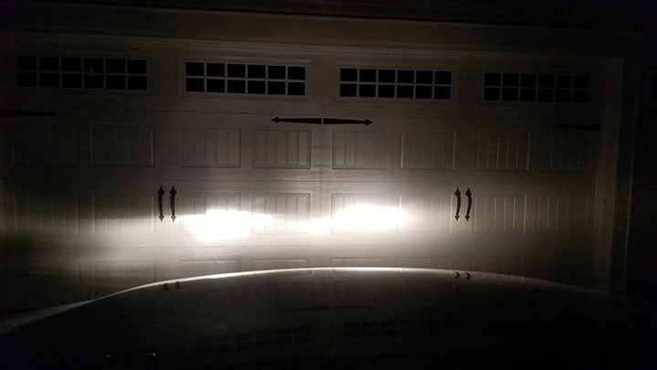

  17. Jun 30, 2020 at 6:59 PM
    #17
    -jon-
    -jon- Active Member
    Jun 1, 2020
    #330060
    25
    Jon
    Raleigh, NC
    For whatever it's worth, here are a couple photos at night ... left side is new TYC headlight and right side is yellowed light (quite possibly original headlight, but no guarantee). Make your own judgement. Unfortunately, we have a streetlight next to the driveway, which drowns out the headlight output, otherwise I would show a distance photo or two.

  18. Jun 30, 2020 at 8:29 PM
    #18
    crashnburn80
    crashnburn80 Vehicle Design Engineer
    Jun 6, 2015
    #156893
    11,414
    Kirkland, WA
    2015 DCSB TRD OR MGM
    Go Hawks!
    Here is another TYC vs OEM. Unfortunately it is somewhat difficult when comparing a worn out light vs a new one. In the case below though the TYC’s pattern is obviously poor.
