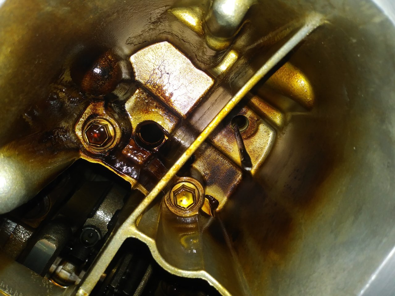

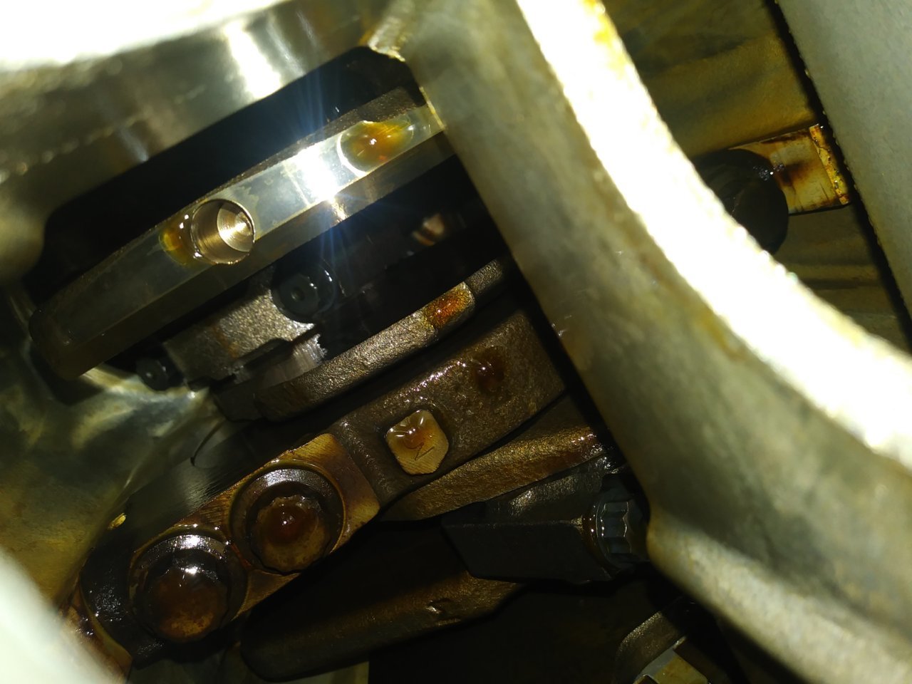

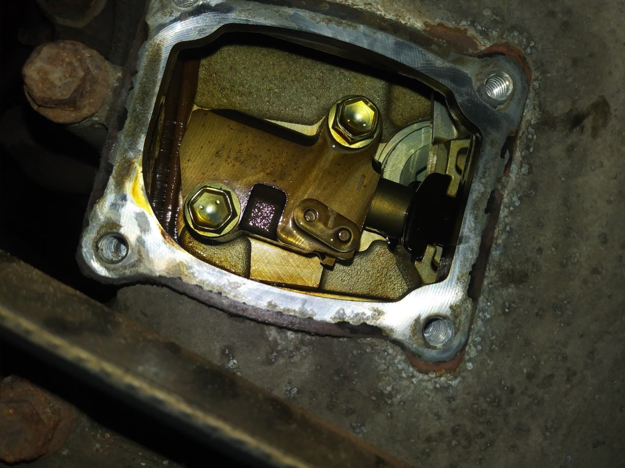

    I do very short commute, my job is 5 miles of where i live, so 10 miles a day on 2 short trip. Usualy if i don't have any shopping to do my truck run maybe 50-60 miles per week. In the summer it's ok the truck and transmission can reach operating temp but in the cold i found out that the condensation form sludge under the oil cap very easely and the trans stay around 30-40c because the torque converter lock and don't generate much heat.
    Short commute is a form of severe service, i always change the oil and the filter every 3k miles on all my vehicule and usualy this happen every 6 month, so 2 oil change per year (before winter and before summer).
    My truck was serviced all his past life at the dealer and they used the conventional 5w-30 (dino oil) @5k miles for 130k miles. I did the switch when i got it with a synthetic blend and that started to clean the inside, i did another change 1k miles after that, it was pretty dark and started using Amsoil OE 5w-30. I did another change 3 week ago @2k miles and the oil was better looking but i still had some "gunk" and particle stuck in the oil filter so it's was still cleaning old wear debris and stuff. For now i will wait the 3k miles mark to change the oil and to see how this truck behave in the winter, i have in hand a oil test kit to see how the engine health going when the oil change happen.
    I use the OEM filter 90915-YZZD3 with Amsoil OE 5w-30 OEFQTC-EA. I usualy save around 25-35$ if i do the oil change myself.
    This synthetic oil seem to intensify the ticking noise from the valve train and it seem many people have the same result when switching from dino to some other brand of synth oil, after 7 month of owning the truck i can say the taco tick still bother me and the cold weather seem to give some noise with the fuel injector. I remember a quote somewhere saying that it's better to have a 1gr-fe who sound broken/diesel-ish for 400k miles than a good sounding engine who last 100k miles.
    I have some pic i took when i did an inspection of the timing chain tensioner and the pickup tube to see how bad was the gunk when i did my last oil change. I found nothing in the sump pan and you can see even with regular oil change every 5k miles for 9 year that the truck have some gunk sticking inside and a gold varnish looking. At the next fluid/coolant refresh (in 3 year) i will reopen the sump pan and see how this cleaned up.
