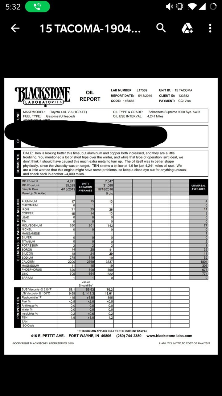

    Ugh. Second bad set of results.

    1,976
    Man that's surprising. Thanks for sharing.

    @Naumoff42 Dang, that is looking kinda bad for an engine with 35K. I would take these results to Toyota and insist they do their own oil analysis; this will provide some documentation in case something catastrophic happens after the warranty period ends.

    Does that stuff usually go through the dealers first or am I better off going straight to corporate?

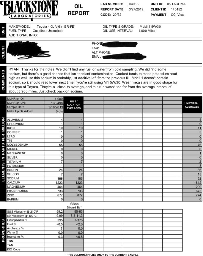

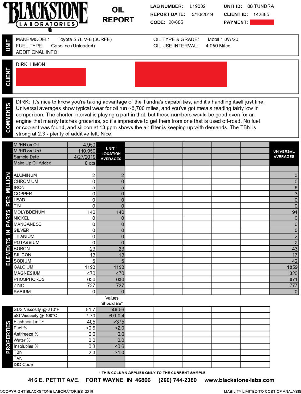

    I just got my first sample results back:
    sgtnewundies likes this.

    Nice report! I go 10000 miles on the m1 5w20.

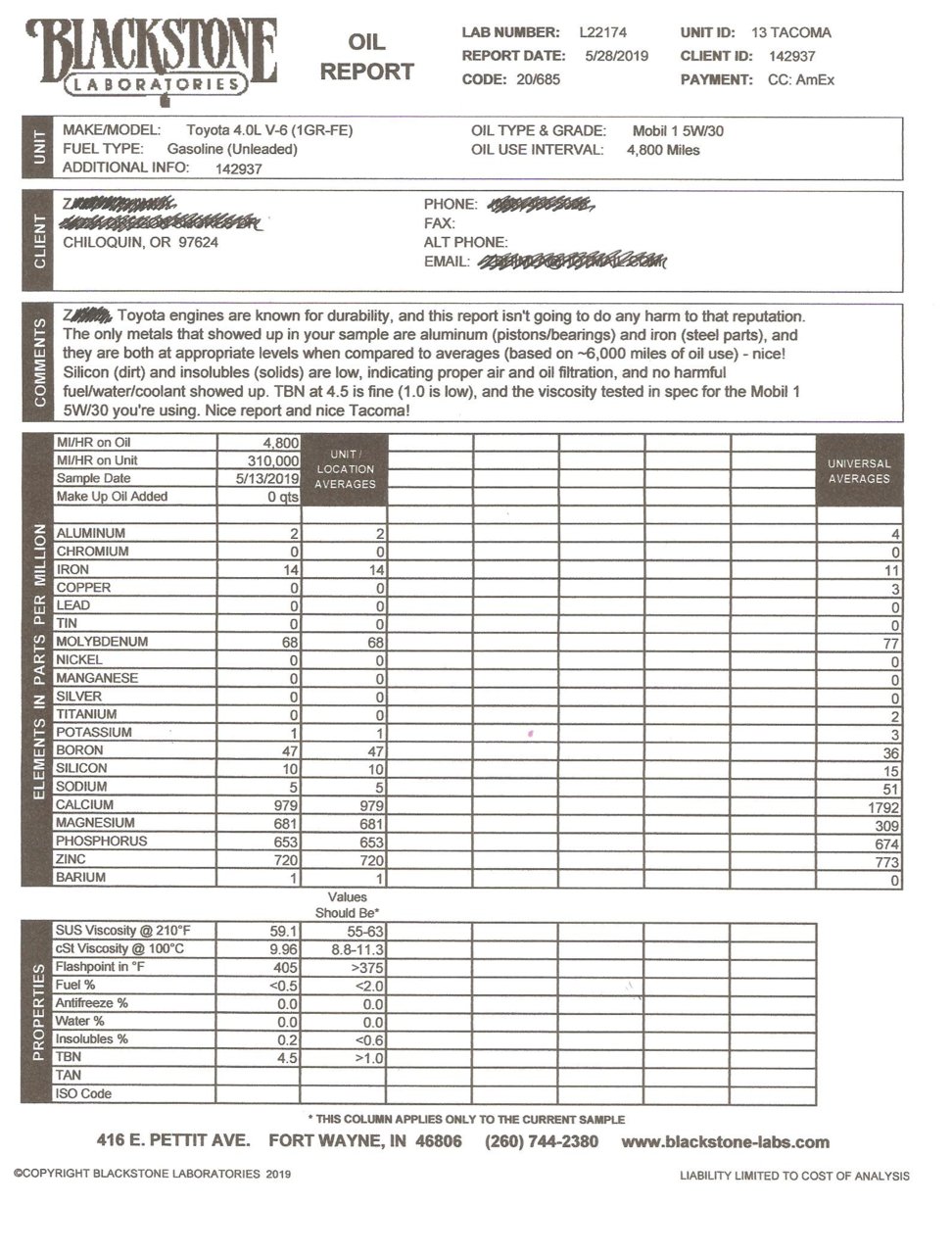

    I change my oil every 5k

    The TBN indicates that you have a long way to go on the intervals. Thanks for sharing.

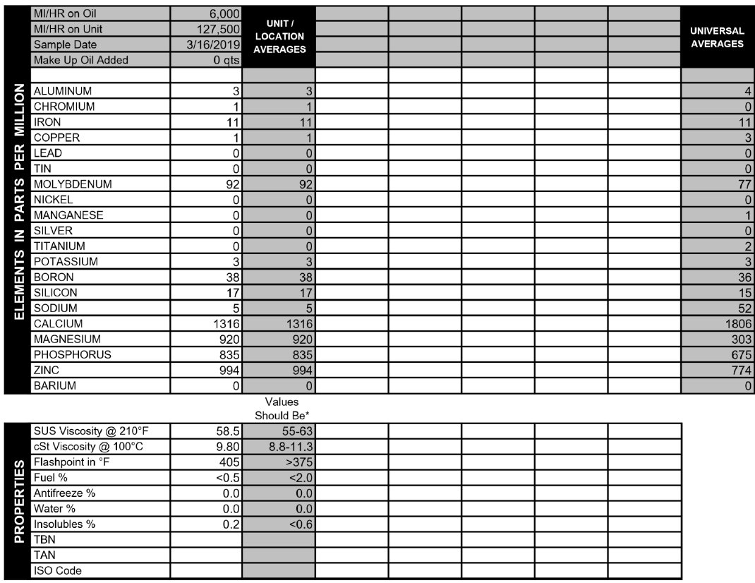

    I recently decided to extend my OCI's so I sent in a sample on my first 8,000+ one to make sure 10,000 was safe. I'm pretty pleased with the results for a 200k mile engine...

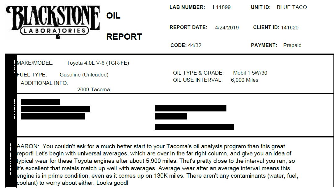

    Second sample I've sent in since purchasing @ ~60K miles. 7,500 mi change interval on synthetic penz platinum. Will do 10k for my current OCI since all looks to be in order.

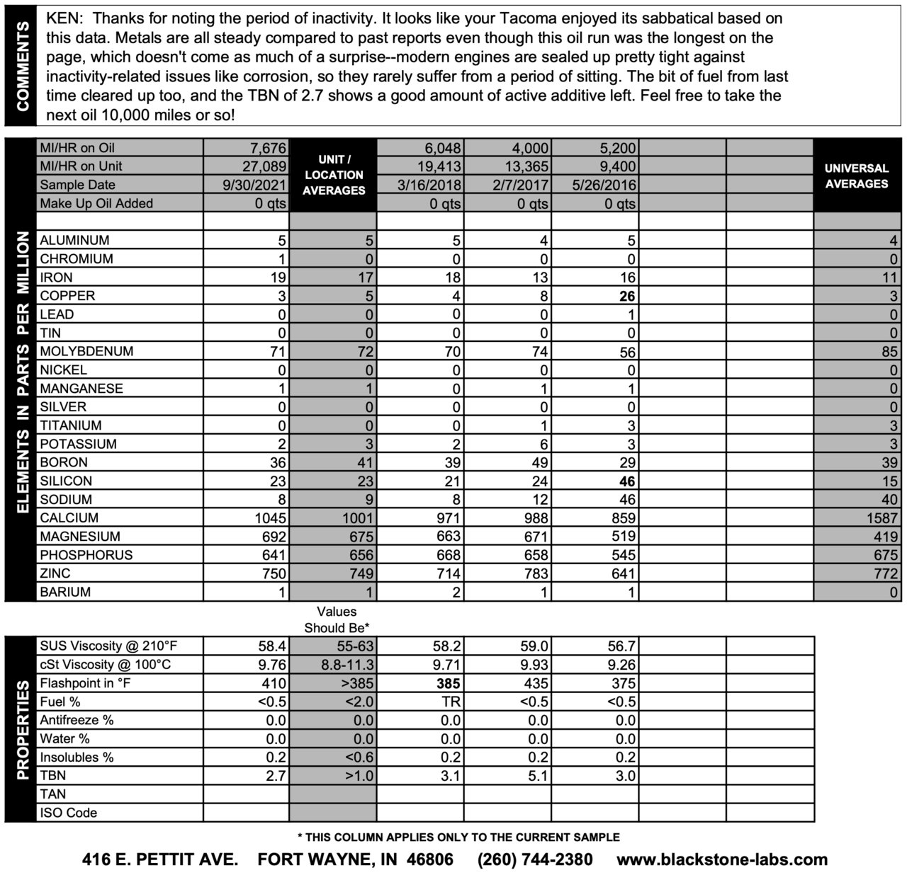

    Time to bump a useful thread...
    I thought this report might be interesting as it is an edge case. Change interval 3.5 years (thank you COVID-19) but only 7,600 miles. 2015 V6 on Mobil 1 Extended Performance. Truck didn't move from 2/2020 to 6/2021. Miles on this vehicle are almost entirely long highway and long off-road trips. It is stored between camping trips.
