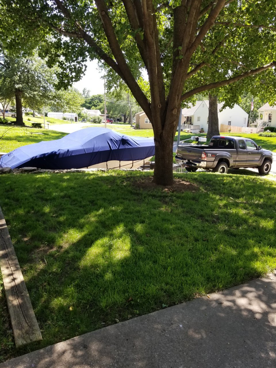

    Bought a boat a few days ago and towed it from Olathe to nkc. 3600 lbs wet seemed a bit taxing on the truck. Anyone else do any hauling or have tips or tricks?
