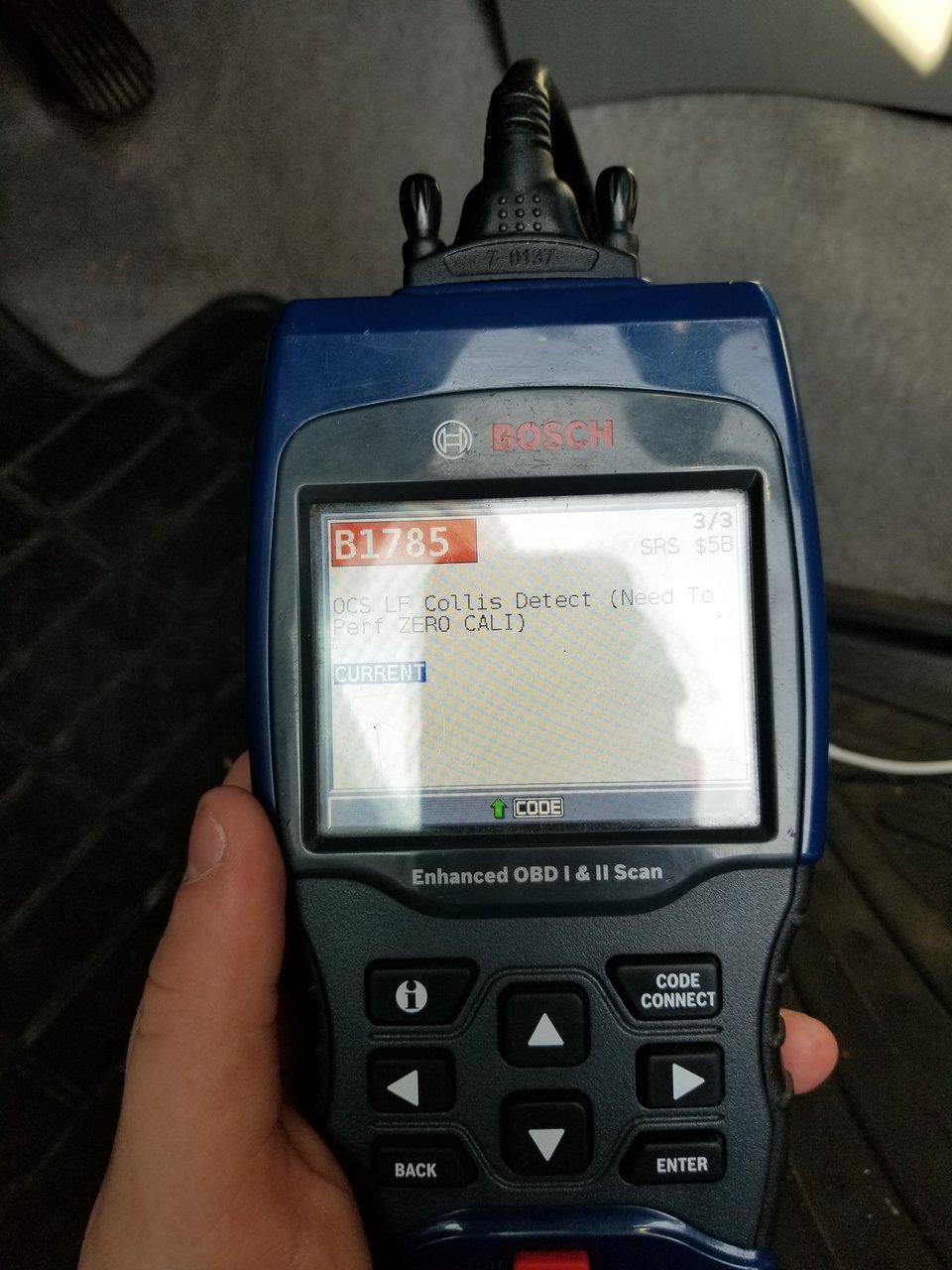

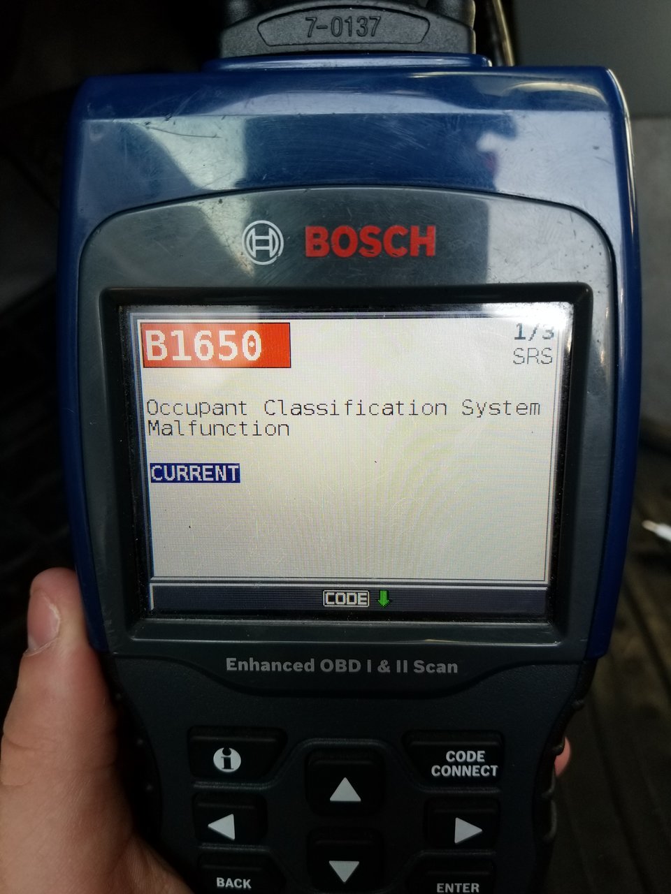

    Hey so i noticed an airbag light on today so i scanned the codes and this is what came up. I'm gonna call Toyota and make an appointment but does anyone know how much this is gonna run me?

    Did you scan it multiple times after starting and killing engine?

    Seat sensor maybe?

    It will cost you 1 hr for the diagnostic......i don't know what your labor rates are in MO.....say 120
    This is standard, if it is warranty/recall related then the part will be replaced via Toyota and the Diag will be a wash if not you are on the hook for the repair, if your shop is a good one then the tech will only charge you the time it takes to search the code and confirm the issue.

    For what it’s worth mine was a bad left front impact sensor. Can’t recall the cost but not horrible

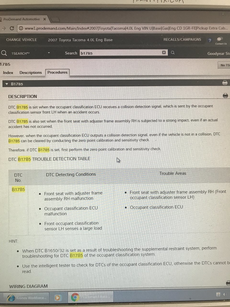

    Here you go

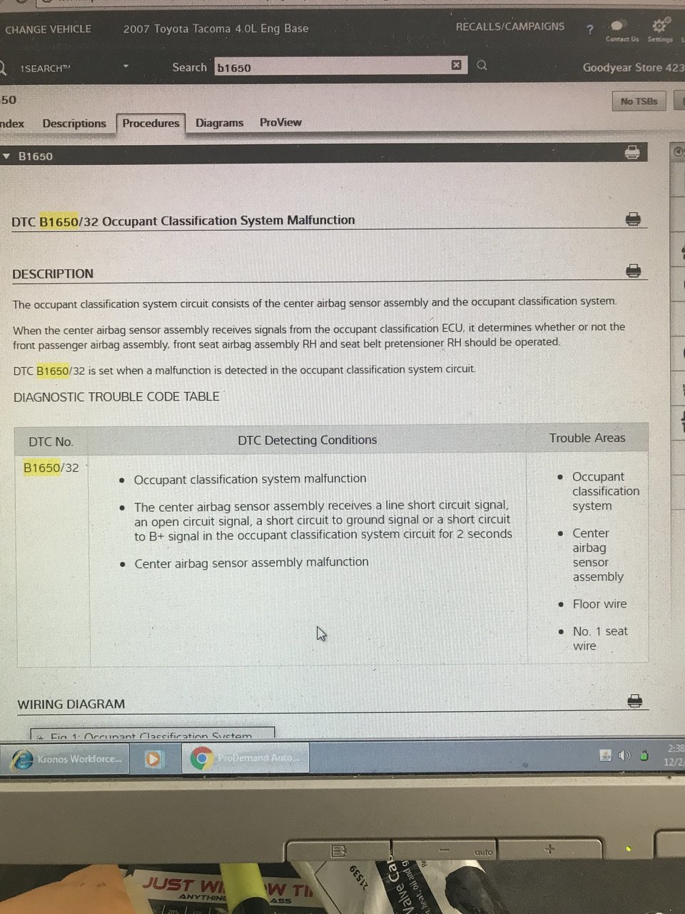

    Here's the other code

    This is just the seat sensor that tells the vehicle whether to turn the passenger airbag on or off. Part # 89952-35011 I believe. . .
