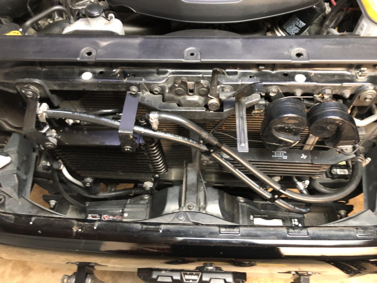

    However, I have also installed a 2nd Trans cooler to ensure overtaxing my temps.

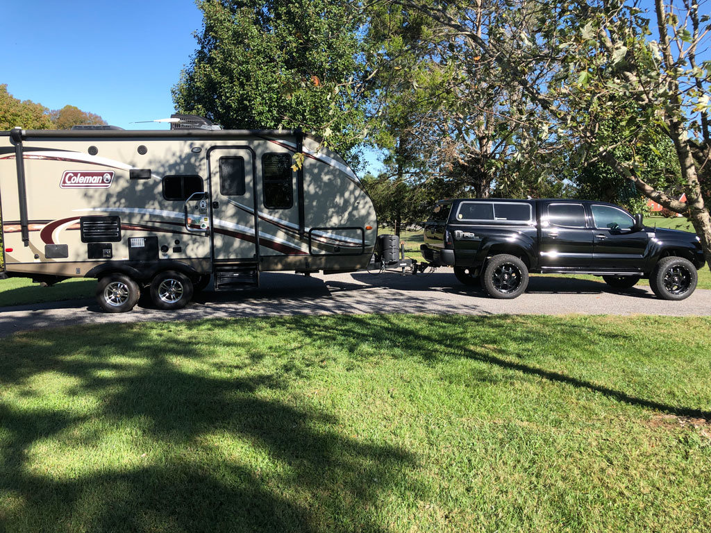

    5,500lbs loaded. Probably about 8,000-10,000 miles behind my truck.
    You have to load the trailer properly and set the truck up to tow (WD hitch, brake controller, and if you have an automatic you'll want an aux transmission cooler and some way to monitor transmission temps). Airbags are for payload and do nothing the shift the weight off the rear axle so don't wast your money on them I towed for two summers on the factory leaf pack and the truck sat level when the WD hitch was set.
    Hoyle, canyonchaser and CygnusX191 like this.
