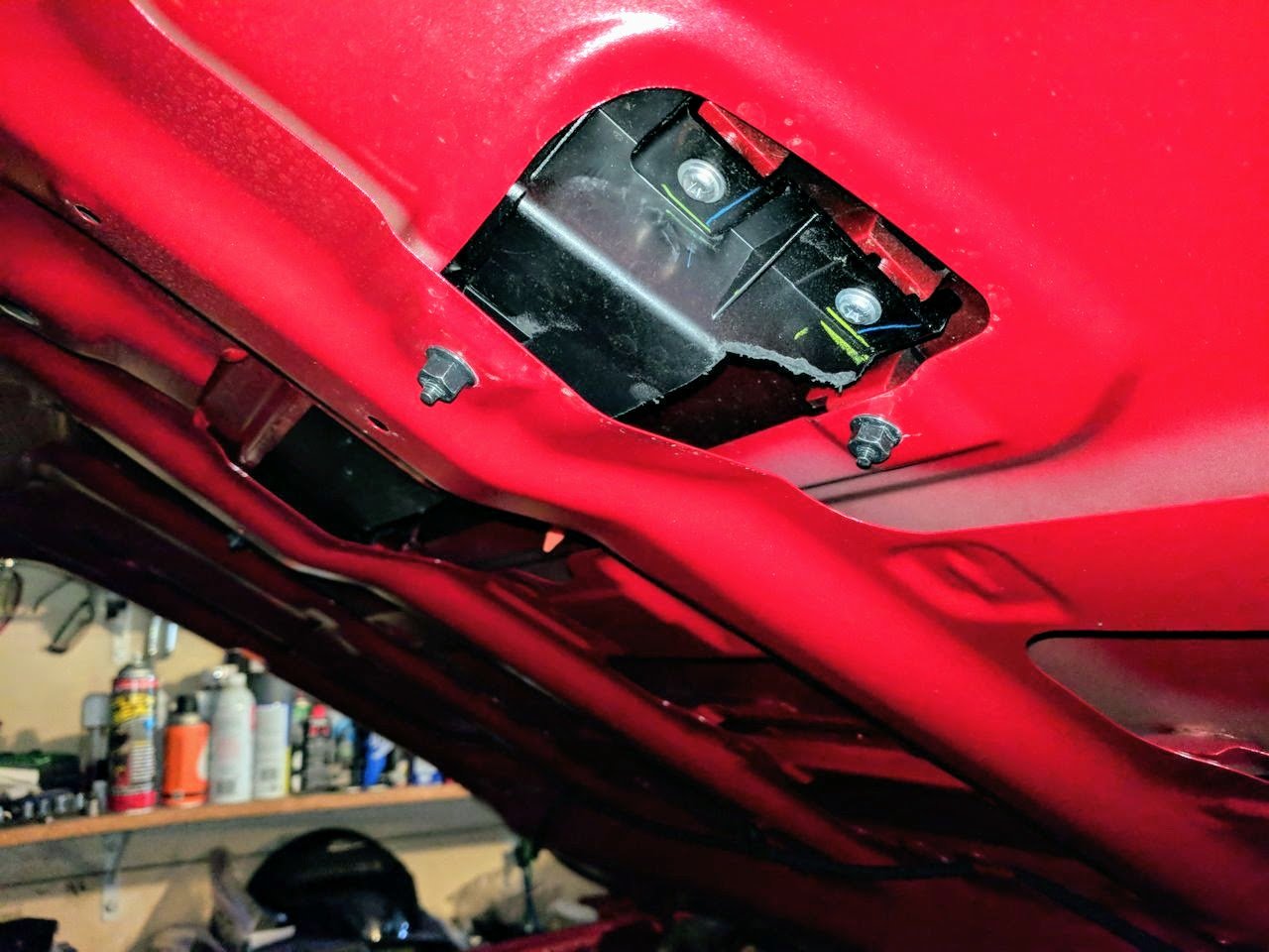

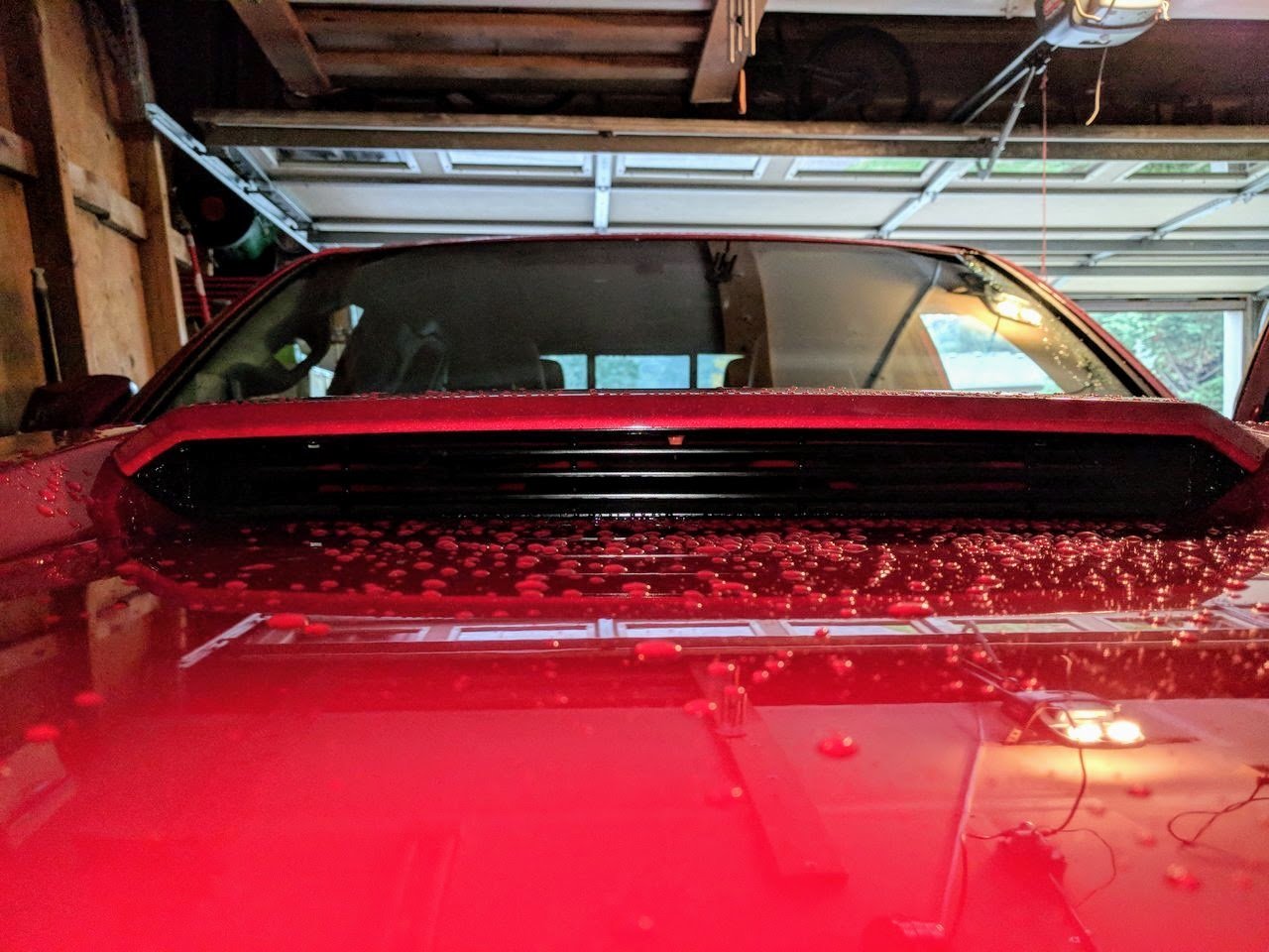

    Yes, I did.
    Who knows if there are any benefits. Someone noted that Toyota studied an open skewp and ditched it because it had a negative effect on cooling, but we don't know what they studied. In my case, I was getting large splashes coming from the ends of the skewp hitting the windshield right in my line of sight. Opening up the skewp fixed that. So, semi-functional. :rofl::rofl:
    Since, I painted that orange clip black, though it was never really noticeable.

    So did you just cut out the back of the plastic insert? Any issues with it?

    Yes. The black part only. Three cuts. One on each side, and one across the bottom. Zero issues, plus the benefits I noted. If you have ever come out of a car wash with soap streaming back along the hood, well, this will fix that also.
    Hahaha! I think that is a complement. :D
    Just a dremel and a shaky hand.

    Good to know and thanks for the insight! I may give this a shot as I don’t like that it’s just an air/water catcher right now.
