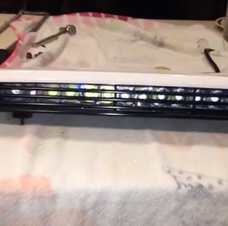

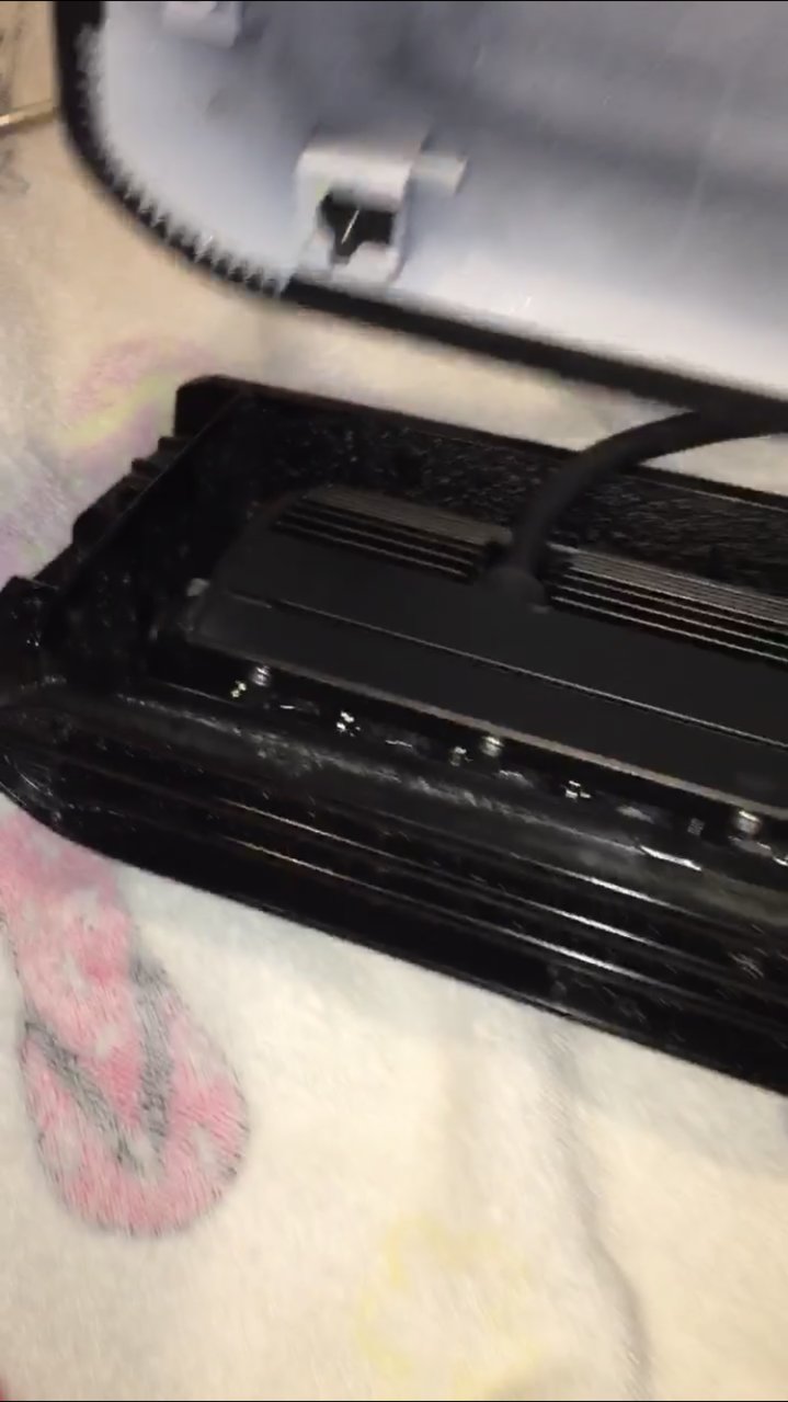

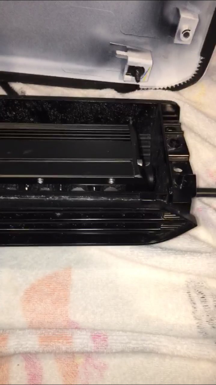

    Thought it would be cool to put a light bar inside of the hood scoop (since it has no other function other than looks). Bought a 17 inch single stack led bar and dropped it right in. The light bar fits just about perfectly, but I Used some doublesided 3M tape for some peace of mind. Put some foam in the small space so on both sides of the bar as well to make sure nothing moved around. Wiring came with a remote option so I went that route rather than worrying about installing a switch.Super happy with how it came out. Well worth the 44$.
    Here are some pics: Thoughts??

    Light output looks better than i thought it would.
    Great job.

    Yeah that output pictures is with only the led bar on. I was pleasantly surprised on how much output it gives.

    Any single stack 17 inch bar will just drop right in. Water does not get in because you still use the stock piece of plastic in the scoop. Take the scoop off (4 volts) then the black plastic comes off of the scoop (I believe it was 4 screws) and then boom it’s opened up. Didn’t aim it or anything literally used double sided tape for a more secure hold and just dropped put it right in the scoop. Then put the 4 screw so back on which connect with the plastic to the scoop, and the 4 bolts to put the scoop back on the hood. Like I said I wired it to a remote so I didn’t do any drilling. At this point tuck the wires to your liking and all set.

    No modification at all
