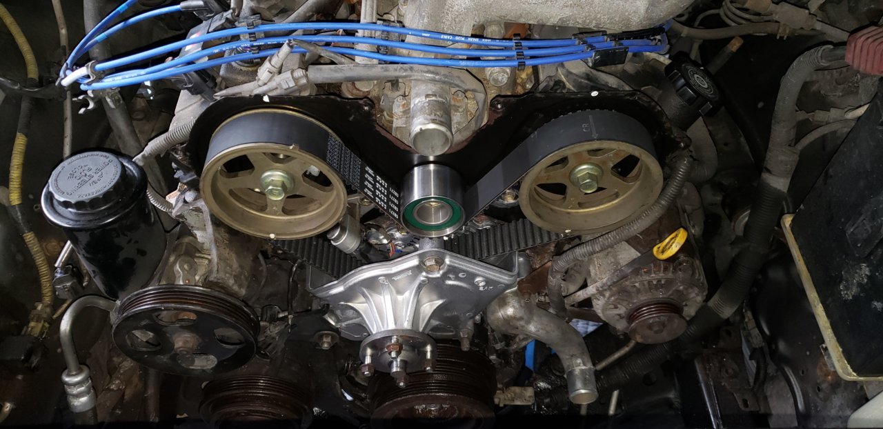

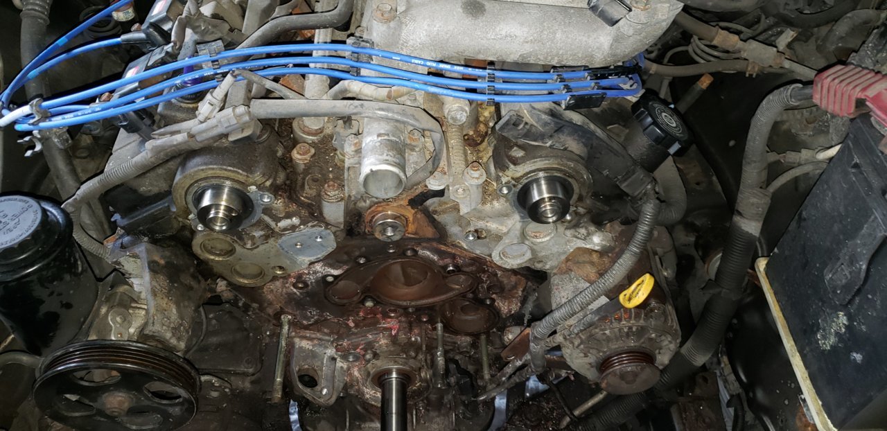

    You've gotten a pretty good list from folks about when and with what parts. There are a few more things you need to pick up in addition to the aircabinman kit on eBay... plus, a few special tools help a lot.
    Here's the write-up I did on the job, and links to all the tools I bought (and where I bought them). Was a great investment from my POV since I've used them a few times, and it's nice to have them around when buddies need them. I've included links below as well for your convenience.
    full write up: Step by Step Toyota Tacoma Timing Belt Replacement for 3.4L V6 5VZFE
    1. OTC 6673 Universal Belt Tension Gauge
    2. Lisle 58430 Shaft Type Seal Puller
    3. Schley Products SP 64400 Harmonic Damper Pulley Holding Tool
    4. OTC 4518 Stinger 5-ton Bar-Type Puller/Bearing Separator Set
      1. (2) M8 Metric Bolts with a 1.25 Pitch, 100mm long with 4 washers - these are the bolts we used in conjunction with the OTC 4518 puller or other puller you have to remove the crankshaft pulley.
    5. PRIVATE BRAND TOOLS PBT70960 Crankshaft and Camshaft Seal Tool Kit
    6. Lisle 24680 Spill-Free Funnel
    7. Performance Tool W89208 Cam Pulley Holder
    8. TEKTON 24320 1/4-Inch Drive Click Torque Wrench (20-200 in.-lb./2.26-22.6 Nm)
    Of course, these tools were in addition to a standard set of tools that you'd need for this job - short and deep sockets, extensions, larger torque wrenches, oil, grease, etc. Here was a list of the additional tools we used:
    1. 10mm, 12mm, 14mm, 17mm, and 19mm sockets - both short and deep. This is a great set, but not cheap.
    2. 10mm, 12mm, and 14mm wrenches. This is a good set.
    3. 3-, 6-, ad 9-inch socket extensions
    4. 10-inch socket wobble extension
    5. A set of socket adapters (from 1/4"-to-3/8", and from 1/2"-to-3/8")
    6. 90º needle nose pliers (for hose clamps)
    7. Two, 2-foot breaker bars
    8. A set of picks
    9. Shop towels
    10. Torque wrench capable of 250 ft-lbs
    11. A box of ziplock bags to hold bolts that have been removed.
    12. A pad of post-it notes to label said bags.
    13. 5 gallon container to catch coolant (bucket with trash bag liner)
    14. 5 qt container to catch transmission fluid

    I just did this entire job on my 2004 5VZ-FE. Watch the videos, read the step by step instructions and order all your parts and tools before you start the job. The post above from turbodb is awesome!
    Another one to check out is Timmy The Toolman on Youtube, he's awesome too! He has excellent videos and he even includes all the required tools and parts you need along with links of where to buy them. He even includes torque specs.
    If you are doing a timing belt job I highly recommend spending the extra time and money and replacing as much as you can all at once. You are already in there with the front end of your motor taken apart so save yourself the hassle of doing it all over again when a water pump, thermostat or a gasket fails.
    Buy the kit off ebay from Air Cabin Man, it's a good deal and includes almost everything!!
    https://www.ebay.com/itm/Toyota-3-4L-V6-Complete-Timing-Belt-Water-Pump-Kit/190521450224?vxp=mtr
    *You will also need to buy a new Crank Pulley Bolt #90119-16006
    Check out your fan pulley bracket as well and determine if the bearing is good, if your are unsure do yourself a favor and just replace it. I ordered the part and replaced it anyways just for added piece of mind.
    *These pulleys do not have removable bearings, so the whole bracket needs to be replaced when the bearing goes bad. These are new, made by Aisin (OE to Toyota). Buy at Lowrange Offroad, the quality is top notch.
    http://www.lowrangeoffroad.com/toyo...et-with-3-4l-5vzfe-v6-engine-tac-er-cfpb.html
    If you want to replace your radiator hoses, now is a good time for that as well.
    *Inspect your Radiator for damage or any leakage
    Part No.: 16571-07030HOSE, RADIATOR, NO.1
    Part No.: 16572-07040HOSE, RADIATOR, NO.2
    Part No.: 90467-37005CLIP (4)
    *Buy or rent the tools that are recommended for this job. They are recommended for a really good reason! It makes everything go a whole lot smoother and requires less time and headache on your end. Without some of the special tools the job is almost impossible. Having a heat torch available will also help with any bolts that don't want to break free easily. Apply some heat to prevent breaking a bolt off in your engine. Most of the tools are pretty common which you may already own if you work on vehicles often.
    Some tools though the average Joe might not just have laying around, so find a way to get them before you start the job.
    Watch Tim's videos and see how much they help with the job!
    -Schley Products SP 64400 Harmonic Damper Pulley Holding Tool
    -Camshaft Pulley Holder
    -Bar-Type Puller/Bearing Separator Set
    -Crankshaft and Camshaft Seal Tool Kit
    -(2) M8 Metric Bolts with a 1.25 Pitch, 100mm long with 4 washers. (Used o help remove the crankshaft pulley)
    -Torque Wrench
    -Lisle 58430 Shaft Type Seal Puller
    -Binder Clips (sounds silly BUT they help more than you would expect, buy them!)
    **PLUS any other tools you don't have that are recommended**
    Toyota Timing Belt Replacement (PART 1) for 3.4L V6 5VZ-FE (4runner, Tacoma, Tundra & T100)
    https://www.youtube.com/watch?v=vHC46ypHxWc&list=WL&index=8&t=0s
    Toyota Timing Belt Replacement (PART 2) for 3.4L V6 5VZ-FE (4runner, Tacoma, Tundra & T100)
    https://www.youtube.com/watch?v=mErd7xoBS9I&list=WL&index=6
