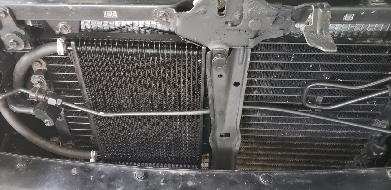

    Yeah, I too will be tackling this job soon. Taking it a step further because other parts are pretty old and I want to upgrade anyway. So on top of the usual timing belt stuff I am going to replace the radiator with an aftermarket from Koyo and install and aftermarket trans-cooler (likely same as timmy). Gathering up all the parts lists and tools I will need.
    So wonderful to have so many knowledgeable and experienced folks to learn from.
    Take your time and have fun with it OP :)
