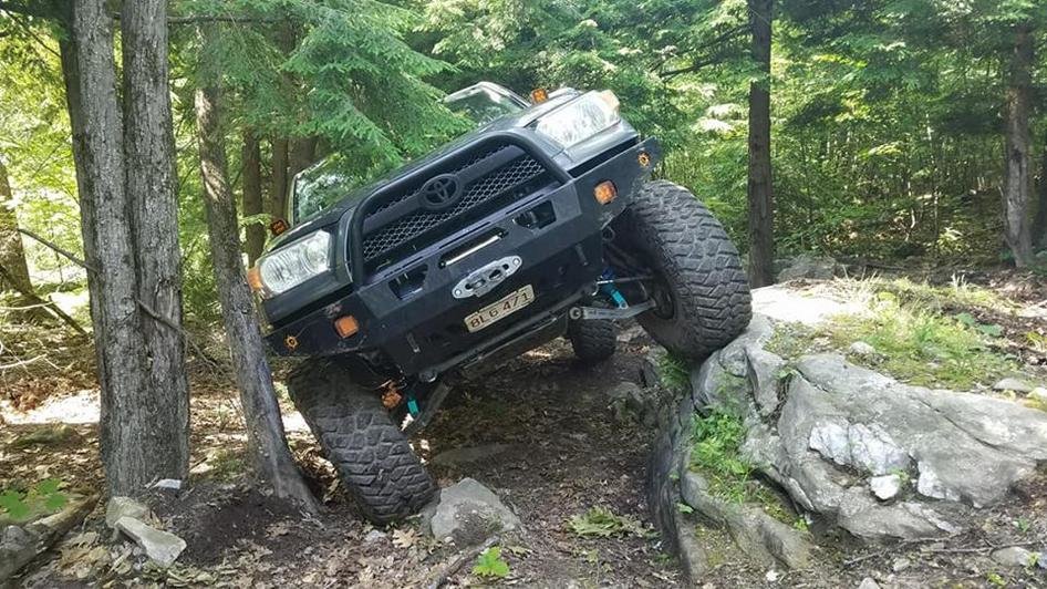

    IFS is plenty reliable. Lots of LT guys thrash the bejeesus out of their trucks on here and check out Marlin Crawlers new rig. IFS on 40s.
    LT will add some more maintenance over stock parts like uniball care and replacement as well as coil-over/bypass rebuilds. Be prepared to add a bunch of reinforcement/gusseting as well.

    In that case, solid front axle will be more reliable. Certain things like CV shafts, steer rack, and tie rods, reach a limit in how much they can be upsized and strengthened.

    I have thousands of off-road miles with a +3.5 lt kit and a Dmz sua. It hasn't left me stranded yet .I travel to some pretty remote areas in Utah. The biggest thing to remember is that you have to drive it home.
    If you go SAS be prepared to sit down and get the geometry right. I have seen many SAS conversions and they are damn scary to watch going down the freeway at 70 mph. Highway manners are important especally for long distance trips. Do you have a wife or gf that will drive the truck? Would you feel comfortable letting them drive the truck if you did a SAS conversion?
    You can't go wrong with a chaos or camburg lt kit. Don't get a +2 kit. They are a waste of money in my opinion.
