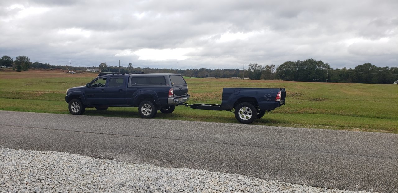

    I know they have lighter rated springs. I bought a set of the 111's(I believe) for my camp trailer project :rofl:
    Crikeymike and BalutTaco[QUOTED] like this.
  13. Nov 17, 2020 at 12:54 AM
    BalutTaco
    BalutTaco Moja_Przygoda
    Apr 2, 2019
    #288885
    3,324
    2019 Cement Limo Trail Edition -> 2022 Magnetic Grey OR
    Bird nest engine bay.
    DUDE that's awesome!!!! You couldn't make that trailer little shorter? Hmmm you can use that trailer "gas tank" for extra fuel HAHAHAH!!!
  14. Nov 17, 2020 at 12:57 AM
    gixxerphil
    gixxerphil @concretelander
    Mar 31, 2018
    #249012
    20,250
    Phillip
    Auburn, Alabama
    2013 DCLB
    I will put a toolbox up front and still wanted a little room. I went 3ft from the bed to the tongue. It'll look a lot better once I can get some things added. I have thought about doing something for water where the gas tank was. My next priority will be a bed rack/RTT.
    BalutTaco[QUOTED] likes this.
