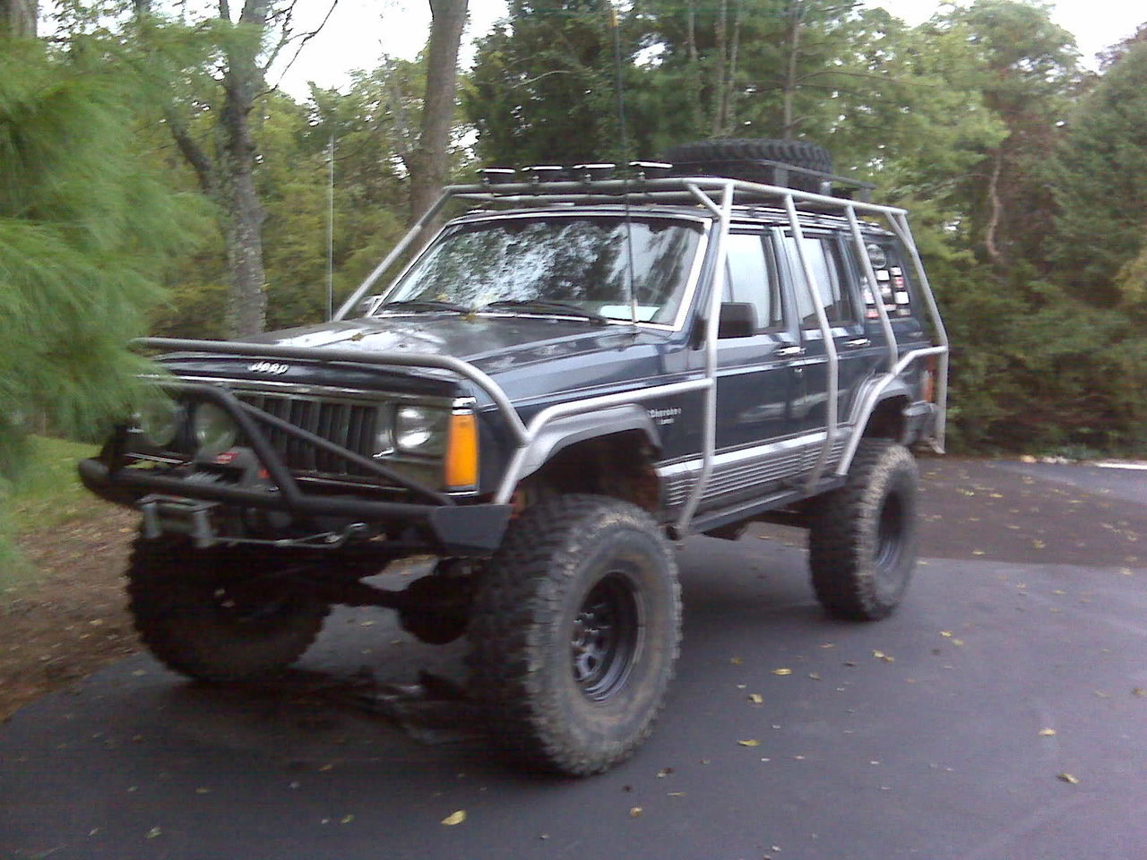

    I know about keeping both. I would love to but between my wife and me we have 6 vehicles now. One is going to a buddies storage unit tomorrow so that I have enough parking at my house for 5 vehicles and our pop up. I keep saying to keep the jeep, sell the Toyota but the minute I do it the Jeep will cost me money. I am also checking my self into a car buying annonymous tomorrow. ;)
    Here is a pic of my jeep

    oh keep the jeep for goodness sakes!!!
    hahah
  19. Dec 26, 2009 at 9:17 PM
    #19
