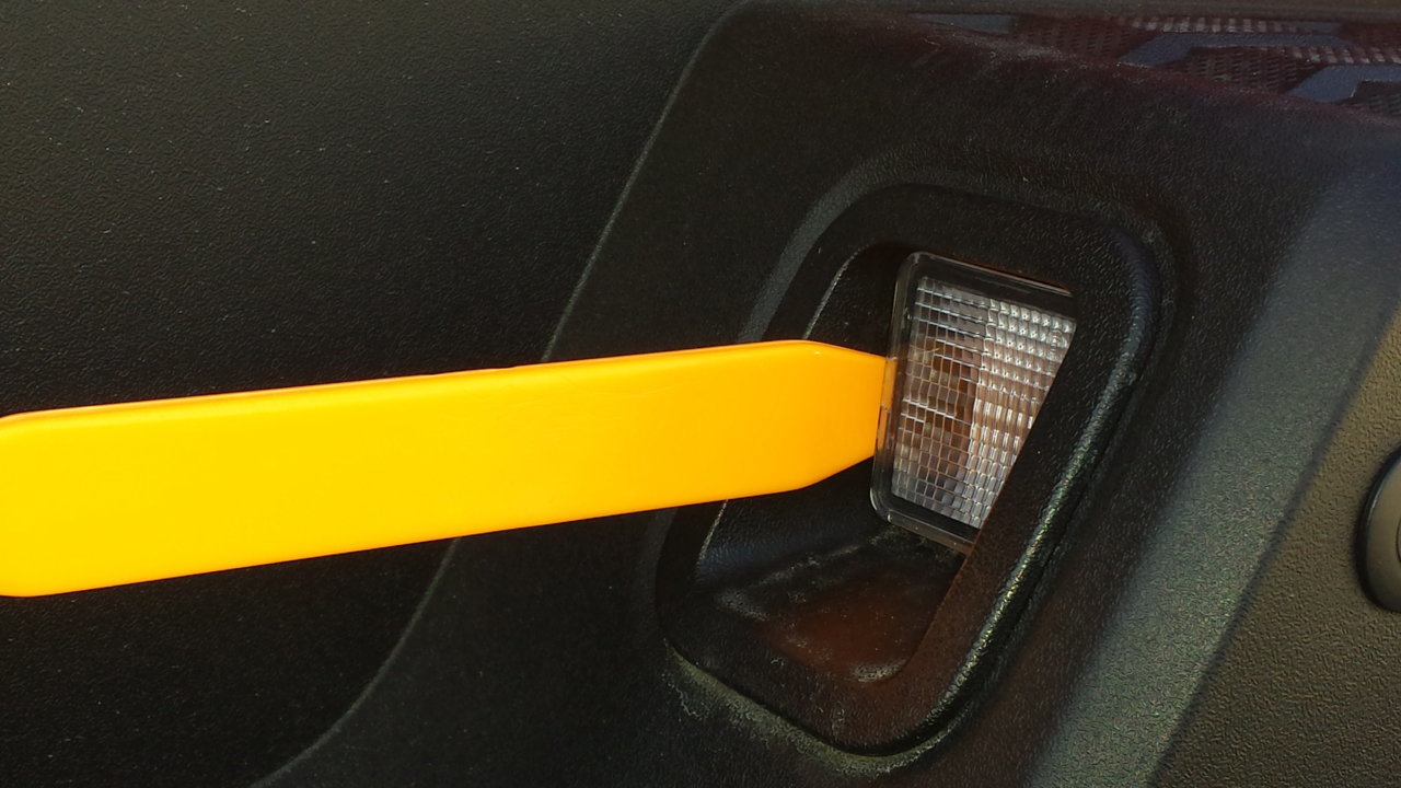

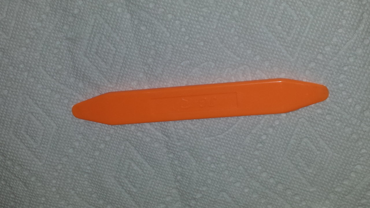

    I use a trim tool like this:
    The trim tool can be pressed in beside the lamp housing to release the clip:
    Then reach behind the bumper and just push the lamp housing out.
    Now you've got it out in the open where it's easy to see and handle. After you've swapped the bulb, the housing simply snaps back into place.

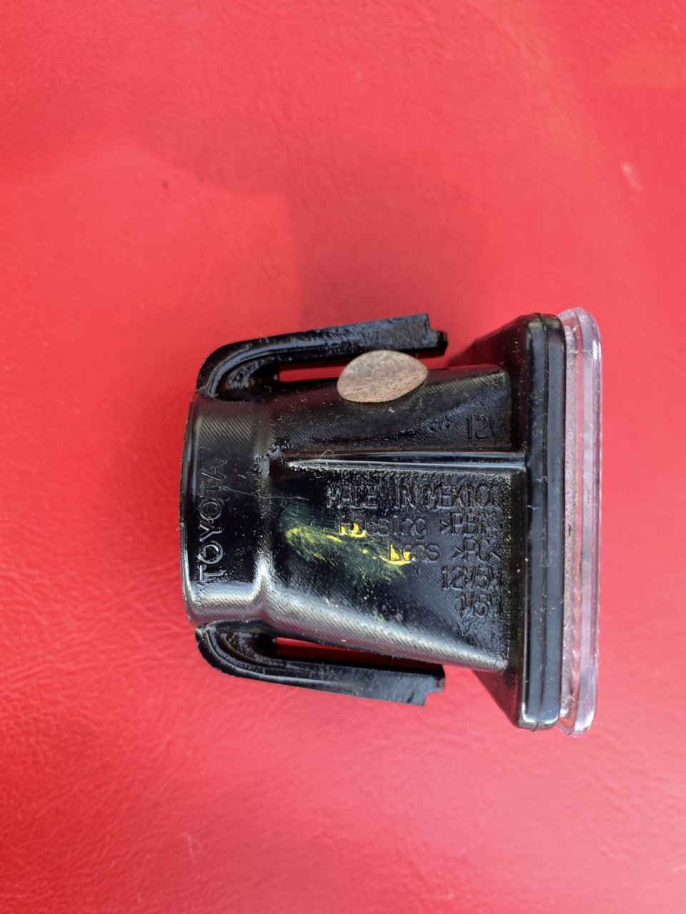

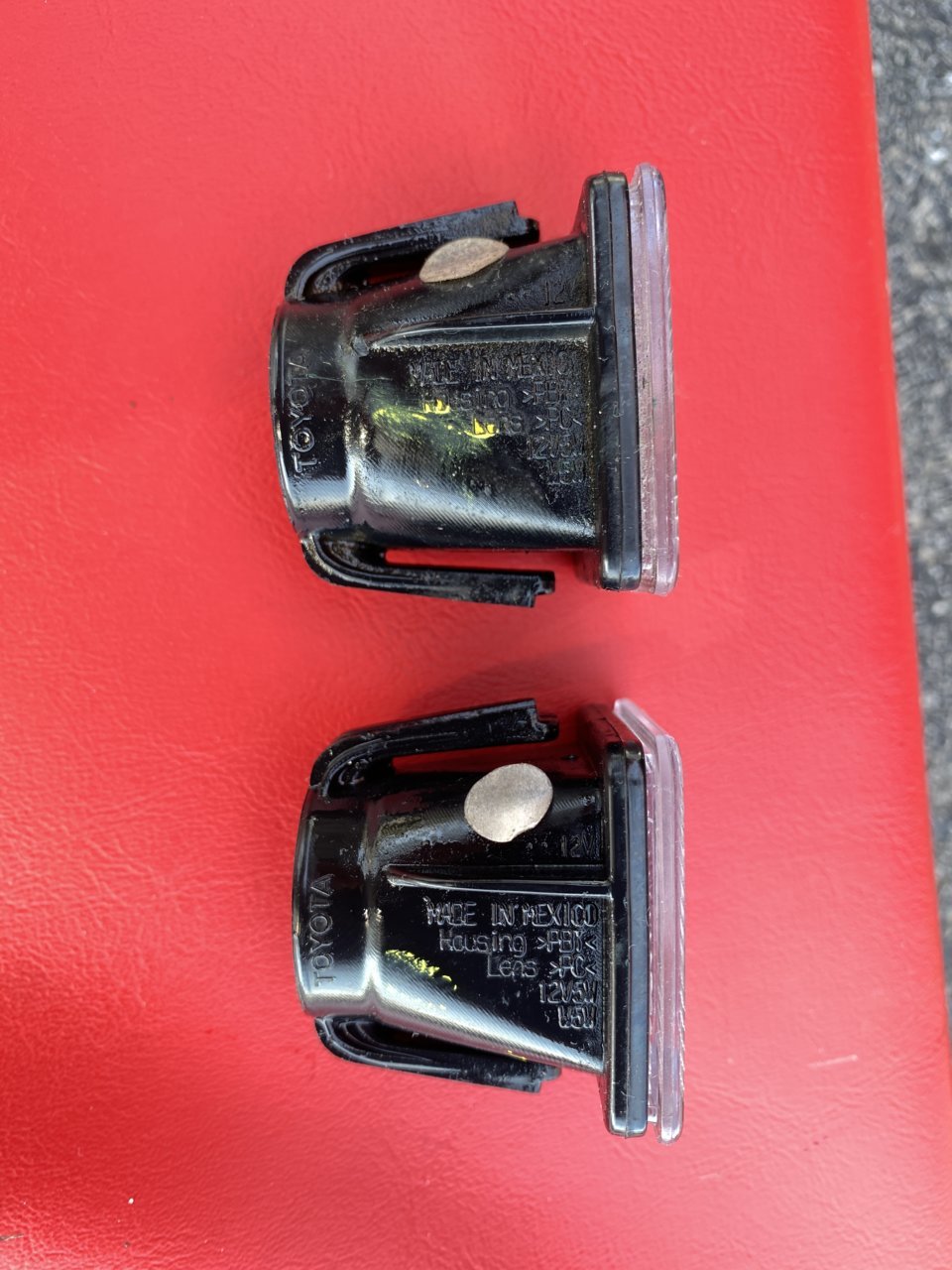

    Well, I got it done, but for me at least, it wasn't as simple as described earlier. I was able to slip the tapered edge of a panel removal tool on the bed side of each light housing. That seemed to be enough to get the clip on that side to push inward and let that side of the housing move forward. However, there was no way to push the housing out from behind without pushing in the clip on the outer side of the housing. To do that, I laid down on my creeper, used a long flat head screwdriver to press it in a bit, then I tapped lightly on the back of the housing. That was enough to pop each one out. I tried tapping the housing without pressing in that second tab and it wouldn't budge. I learned a couple of things in the process. There are three raised sections on the gray piece that holds the bulbs. The larger one actually lines up with a "fin" that's on the housing. That fin is on the bottom of the housing for the left (driver's side) light and on the top for the right (passenger side) light. So if anyone is simply unscrewing the gray pieces, keep that in mind when you're trying to match up the larger raised piece with its corresponding opening. The other thing I learned is something you guys probably already know. Some folks talk about flickering license plate lights. That more likely happens because when you remove the bulbs you probably spread apart the copper terminals holding the bulbs in place. You can simply use a pointed tool or small flathead screwdriver to push the copper terminals inside the housing closer to one another. Then the new bulbs will go in tight. I hope this is helpful for anyone like me who was messing with this for the first time....

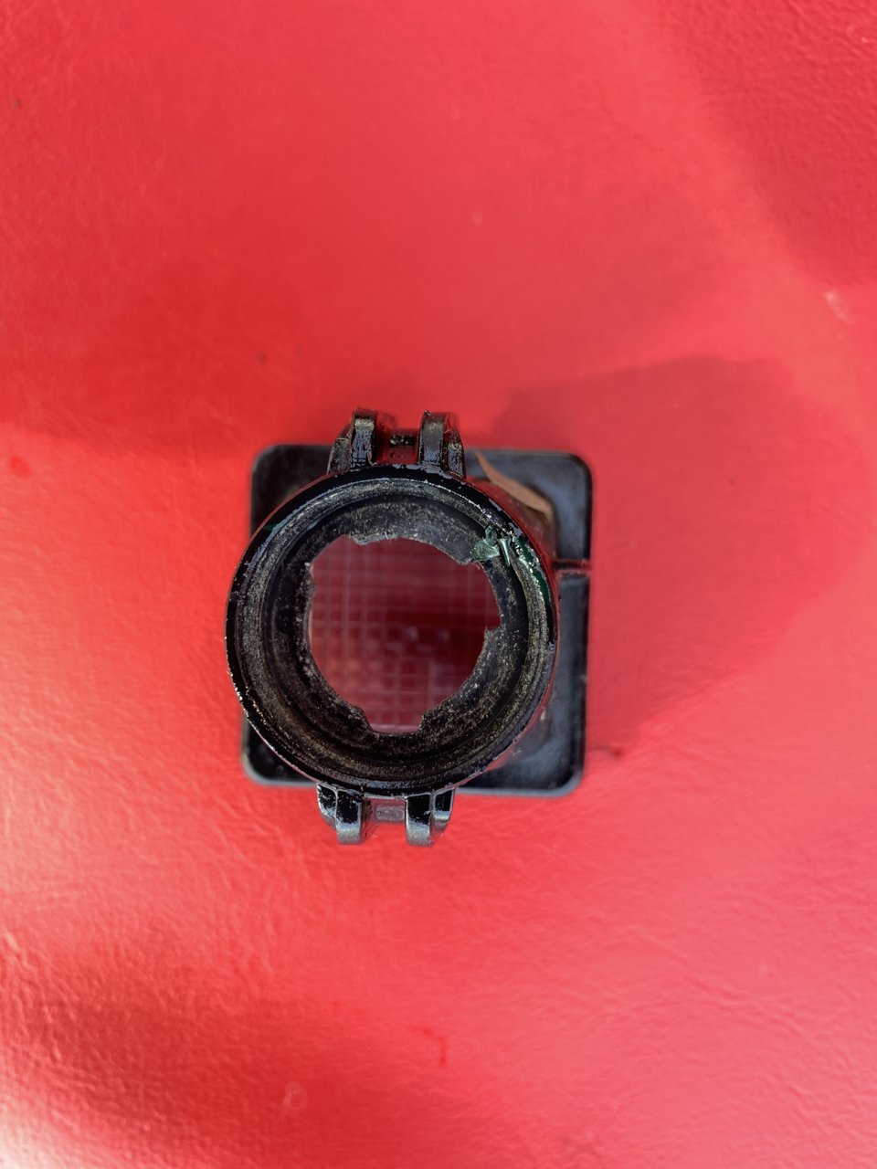

    Hi. Does anyone know Toyota part number for the gray socket the light bulb fits into? I went to replace bulb and it looks like the socket is burned out. Thanks
