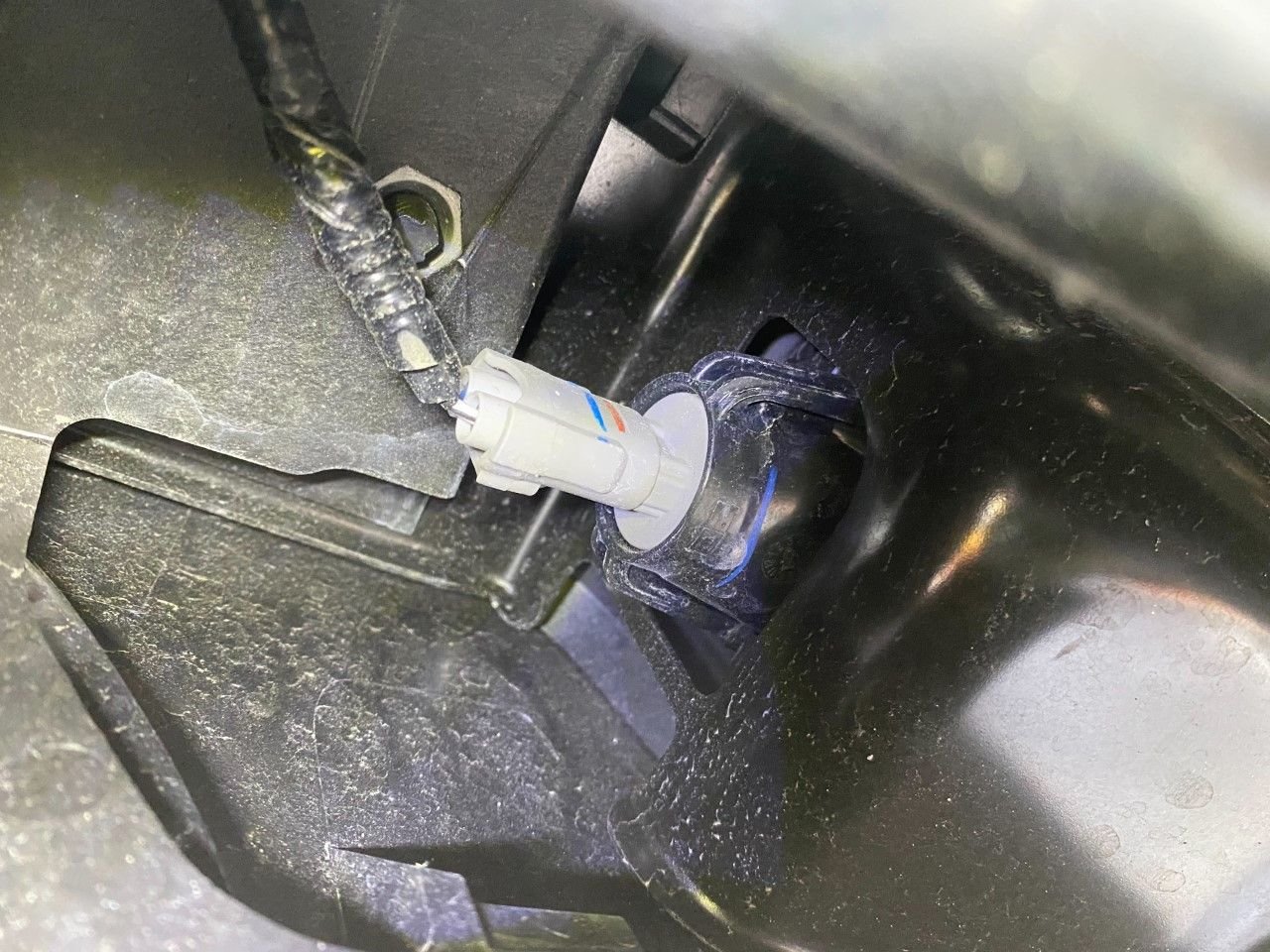

    Step 2 is a great idea!
    I used a long flathead too but pressed it from the bottom and not the side as shown.
    Not sure how I was able to flex the tab enough to fit through the frame of the housing unit but it came free.
    Here's what my area looked like...
    Ed
