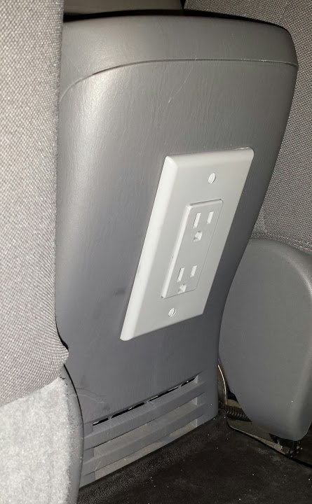

    I'm not worried about doing it. It's super easy thanks to your pics. Just a little hesitant on cutting a hole in my console incase I don't like it. I guess I just gotta stop bitching and just do it haha

    I was also thinking...would it be worth putting a double receptacle? Or just a single like yours. I mean what can you really have going at the same time with only 3.33 amps

    Yea. Just do it thinking about it too much. Single would be fine. Just make sure you get a 3 prong one. To charge laptops etc

    Mine is a double. I put effort into finding a decent looking gray colored outlet and plate and if I had to to again I wouldn't worry about it as nobody ever sees it. It was difficult to even hold my camera at the right angle just to get that picture and that was standing outside of the truck with my camera held in at a weird angle. Like I said, don't worry too much about end-result because nobody will notice it.

    Does that help? I can't really get further back and get the whole picture.

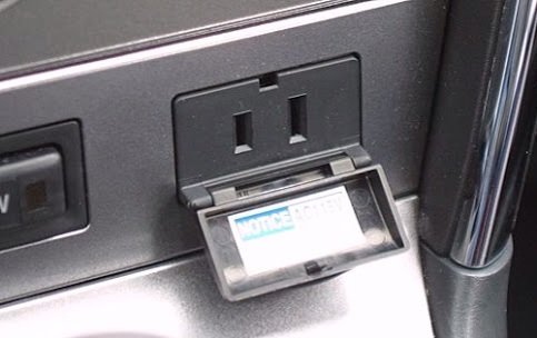

    I think the Toyota matrix has a similar plug and cover. Check Toyota parts

    Looks like it does in the link and your picture.

    I think that's just a hole for the cover latch
